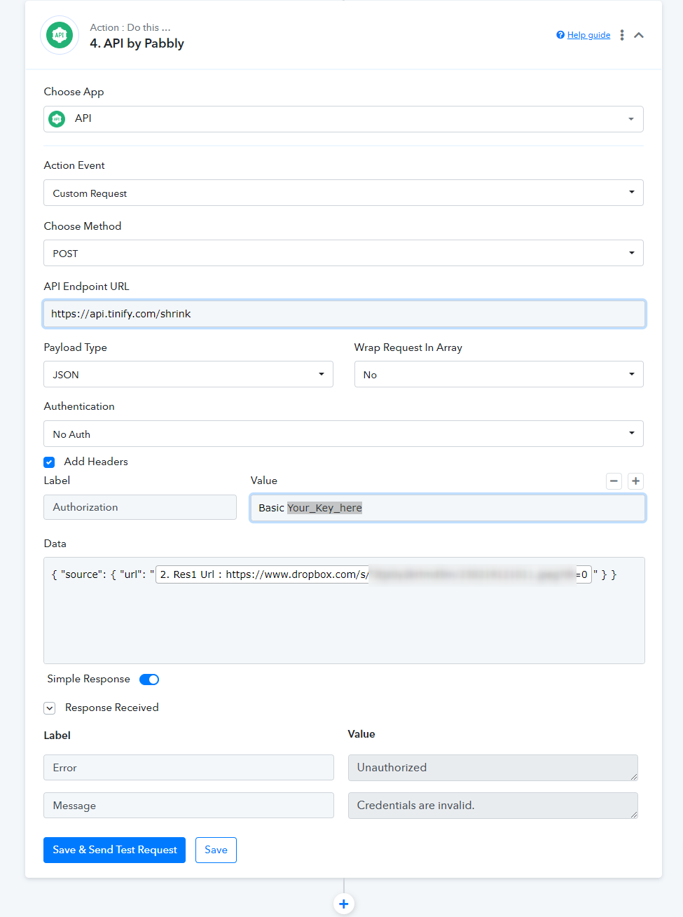

We have set the API by the Pabbly action step for now, so please pass the API key in place and try.
Sakomano
Thanks @Supreme !

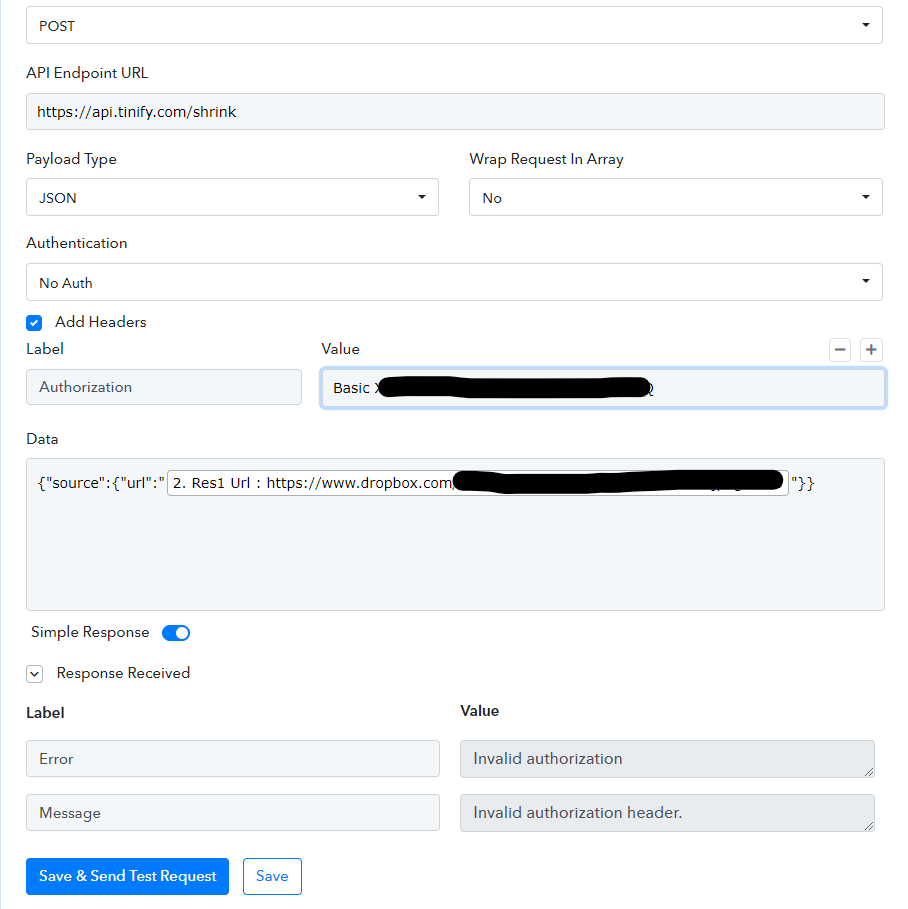

Here is the response: "invalid authorization header"
Looking this in the Tiny PNG doc:
"Authentication to the API (...) All requests require an Authorization header that contains a Base64 digest of the authentication string "api:YOUR_API_KEY" where "YOUR_API_KEY" is the key that can be found on your API account page."
Does that mean I have to encode my API key in Base64 before passing it?
Thanks a lot for your help!
Kindly provide the complete curl request of the application from their end, so that we can look into it.
Sakomano
Fagun Shah
From https://tinypng.com/developers/reference :
It should be base64 in the following form: base64(api:$YOURKEY)
Note that api: should be in the base64 source code.
It follows the basic auth scheme, where the user is 'api' and the password is $YOURKEY.

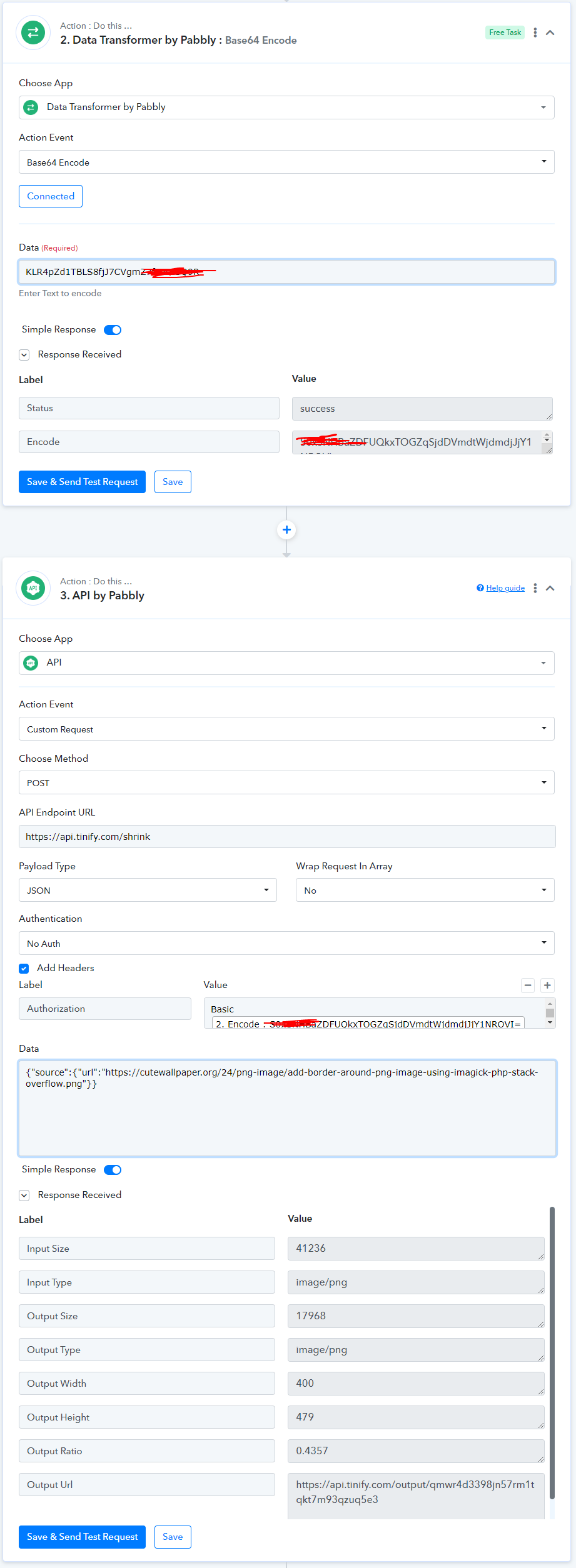

Let me give you 2 options, use API module like this with 1 step before it,
Or use custom app created by me - https://connect.pabbly.com/share-ap...KBGYBGAASXVIFfVIcUgcAQV81CEQEbgRLCTAFXlUlUzY#
BTW NoCode platform doesn't mean that you don't need experts, otherwise Zapier and Integromat won't also had Experts page. You need experts in any software where you have lack of knowledge or don't have enough experience with the tool yet.
Sakomano
Hello @Fagun Shah and @Supreme, thank you so much for your quick answers.
Both solutions work perfectly!
You are right about the experts: I was just excited about the possibilities of Pabbly, and frustrated that I couldn't switch to Pabbly quickly...
I'm sorry.
Thanks again!
Regards.
