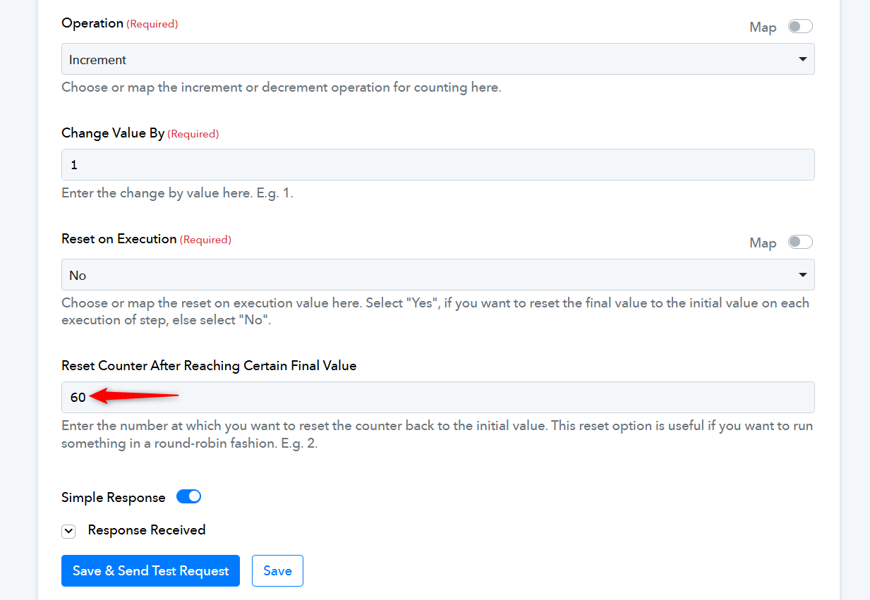

Hi, I have a workflow that trigger when an invoice has been updated. Then we do a few steps then email teh invoice. There is a 60 requests per minute limit on the API for the sending email step but occasionally we go over this.
I have added a delay before the send step but it doesn't work because each iteration is a separate workflow. Is there a better way to do it? is there a way to have a delay between on a step being ran between workflows?
Hi @adamkse,
There is no specific tool that allows you to set a delay between the execution of two tasks.
As a workaround, you can add a Counter and Delay step to your workflow. The counter will increase the delay time by 1 minute each time your workflow is executed. So, the first execution will occur after 1 minute, the next after 2 minutes, and so on, until 60 minutes.
This approach effectively creates a delay between two tasks, but please note that it will also cause the action steps to execute with a significant delay due to the nature of this setup.
https://connect.pabbly.com/workflow/share/CkIFN1YBVzRQGlU_Ug0GIVhMAgYIUgI-U0oBEwMMAXlWGwB7VhcAagBMWXtUHwFgXxYFb1EODGkPG1ZSCV8JegEYUm5WVQZ8VRhSKVQZXG8KVAUtVjc#
Currently, the counter is set assuming that your workflow triggers 60 times at once. You can adjust the Reset Counter time as per your convenience.
