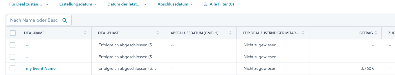

But, even in a complex or in a simple workflow, Pabbly is creating multiple empty entries in Hubspot.
One complete with all entries and multiple on top.

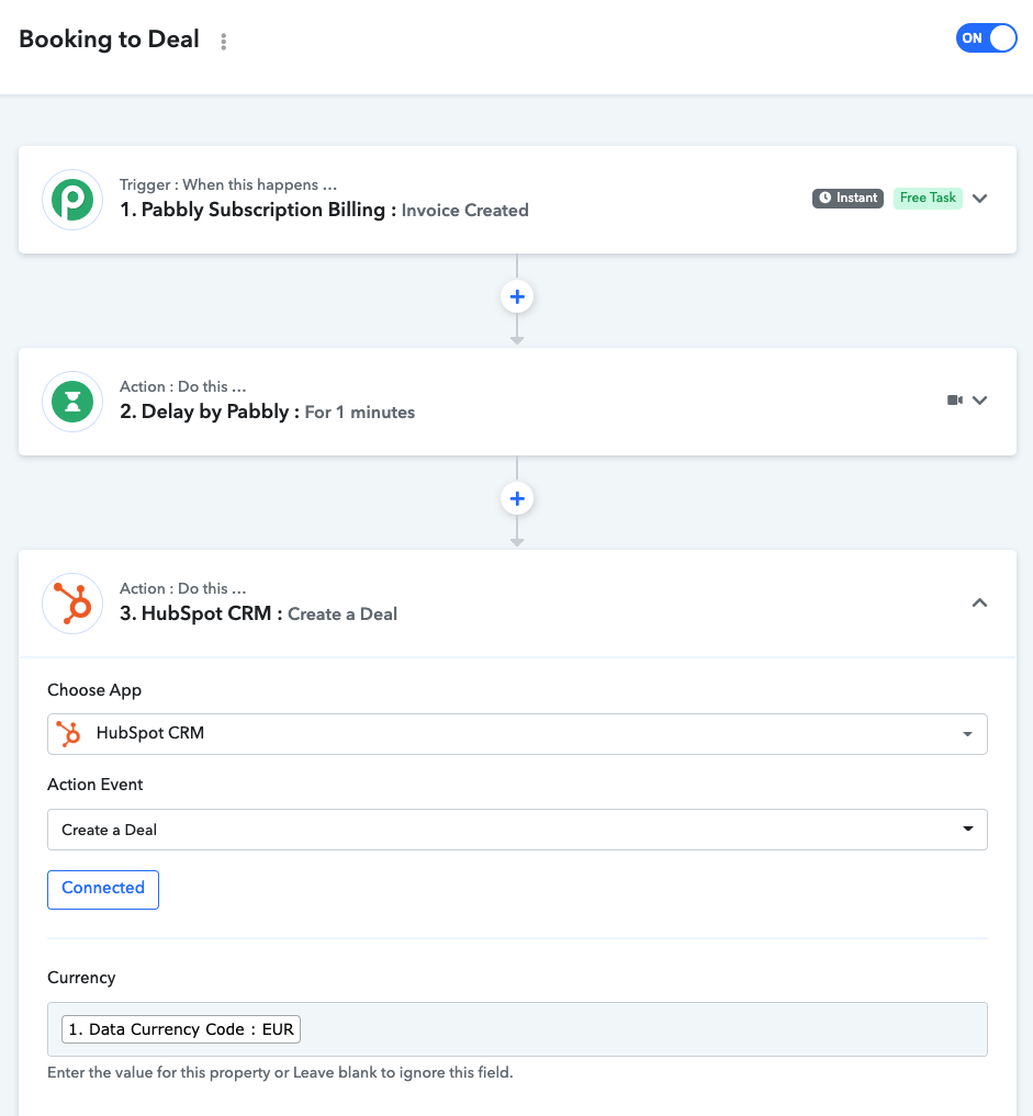

Including a delay of one minute is not fixing the issue.

Example of a simplified case. Deal with Product Name as Deal Name + Amount. Result = 3 entries
This is the simple workflow (delay not mandatory, but a guess for the test)

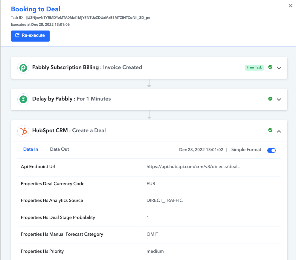

Here the history. Seems to work.

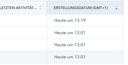

And 18 Minutes Later another complete Entry. Without doing anything. Weired

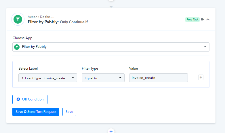

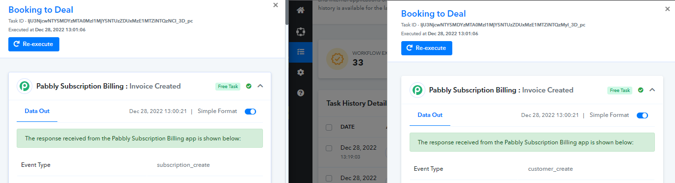

Hey @Michael RBD
It appears that you might have opted for multiple trigger events from your PSB account and because of that, you have got the same response with multiple events.
So, to only process a single event you can use the Filter action step after the trigger event.
