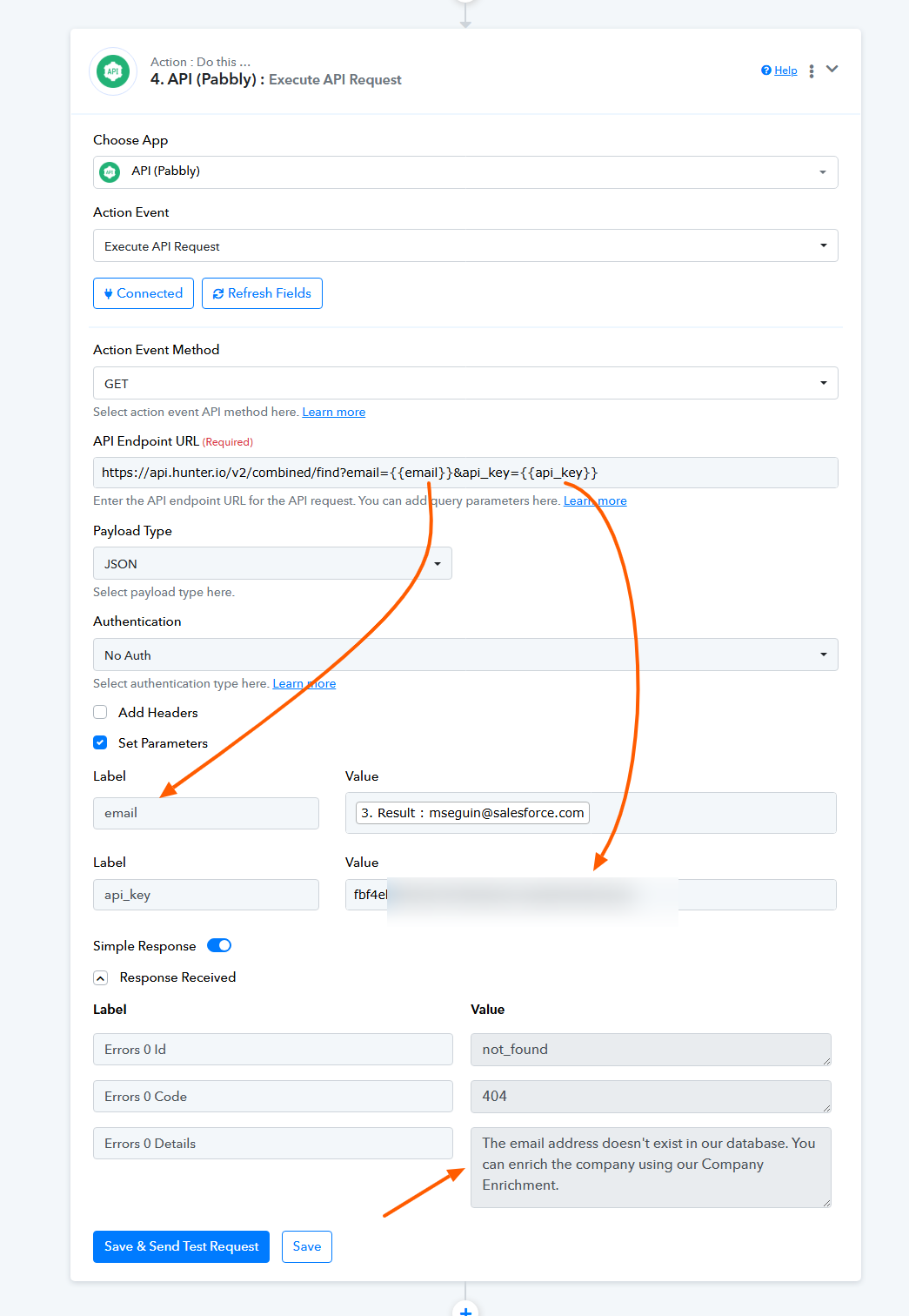

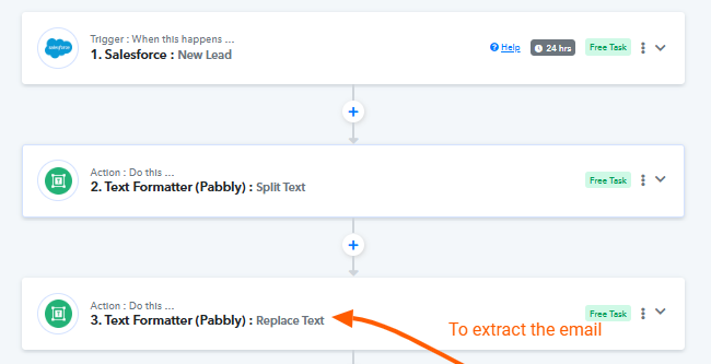

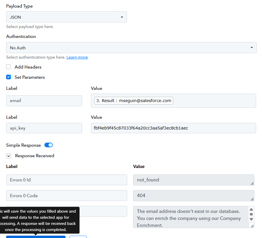

We have made some changes to your workflow to your workflow:
  1. Text Formatter (Pabbly): Replace Text – added this step to extract the email address
  2. API – made some changes to it.
The API by Pabbly returned a 400 error code since the email doesn't exist in your hunter database, please try testing with an existing email and it should return the correct response.
Also upon testing the Pabbly Email Verification action it seems you do not have enough credits to perform this action. You would require to purchase Pabbly Email verification in order to use it.

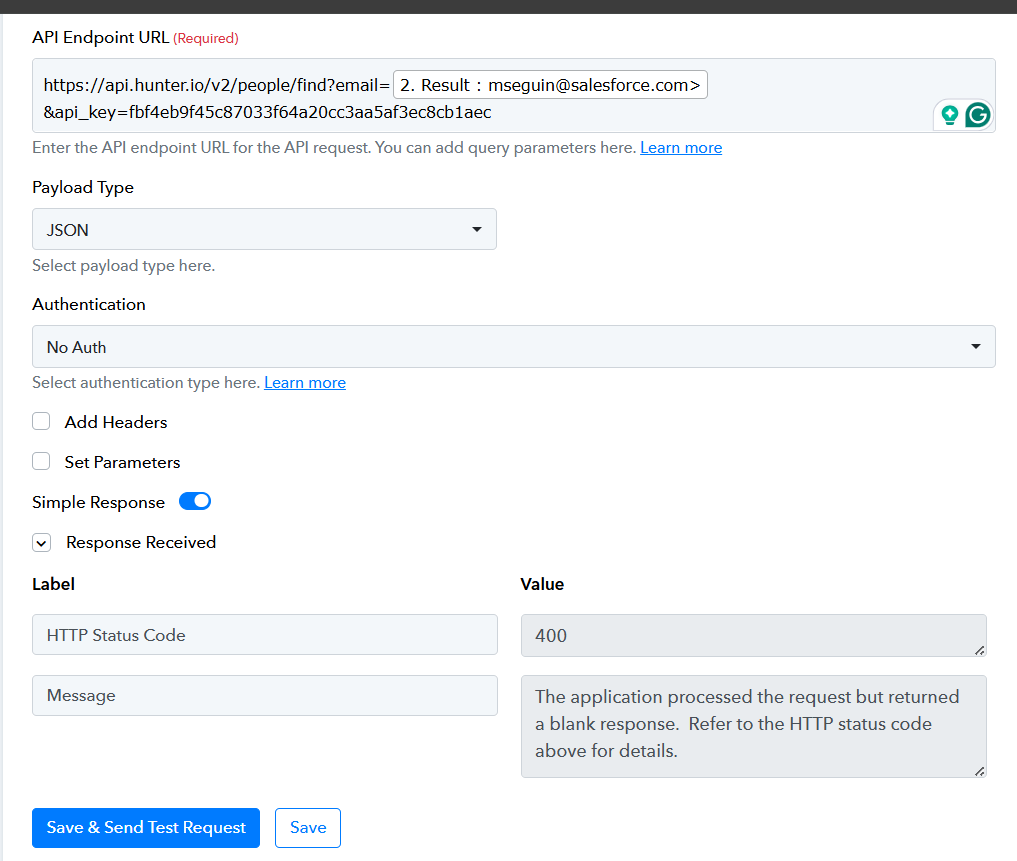

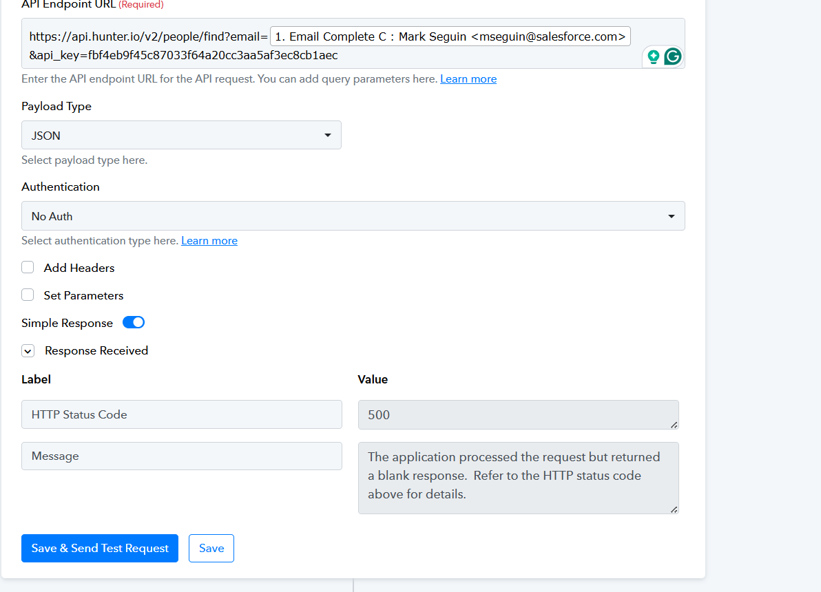

Hi, I am getting this response
Hello @kamblerohit724,

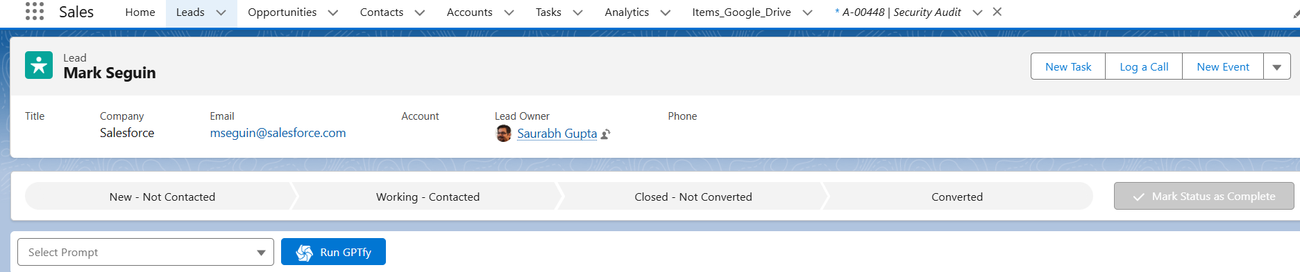

Thanks for the update.
Just to clarify, the restriction on not being able to update a lead once it’s converted comes from Salesforce. Since you're now able to retrieve data from Hunter.io (which we’d have suggested), that part is good to go.
It looks like the Salesforce: Update Lead step is not configured correctly. Before updating, you can run a Custom API Request to check the IsConverted field in the lead’s response — and proceed only if it’s not converted.
