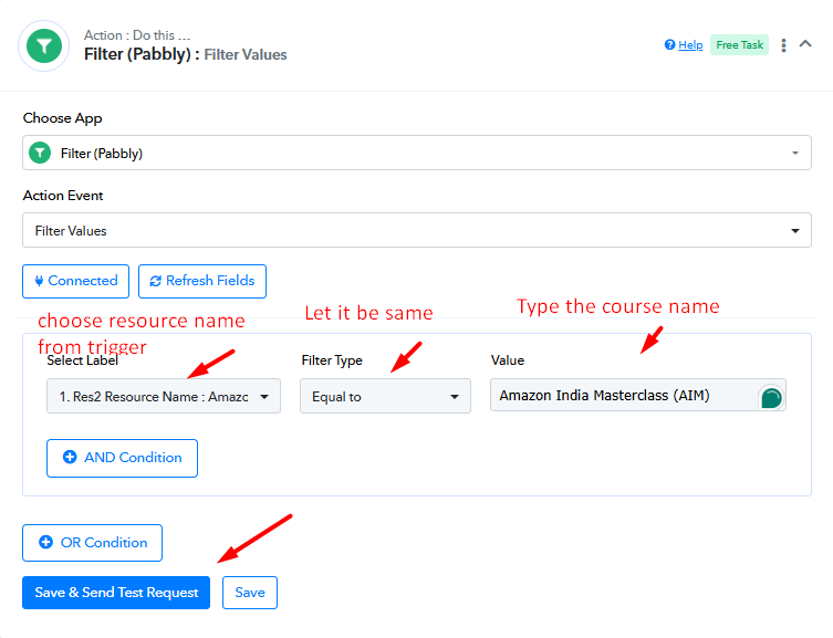

For your concern, you can either create different workflows and use Filter step to distinguish each workflows for different courses-
Or if you want to work under one workflow itself, then you can use the Router module after the Calendly step and use it for different courses-
This will work for you as per your requirement to distinguish between the courses the user has applied for .
