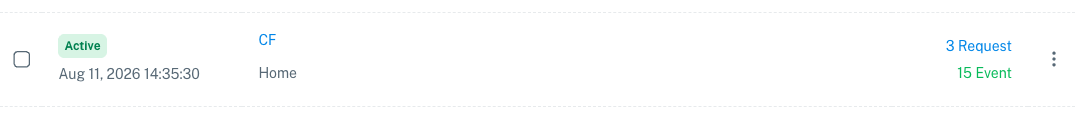

I am getting 15 event attempts

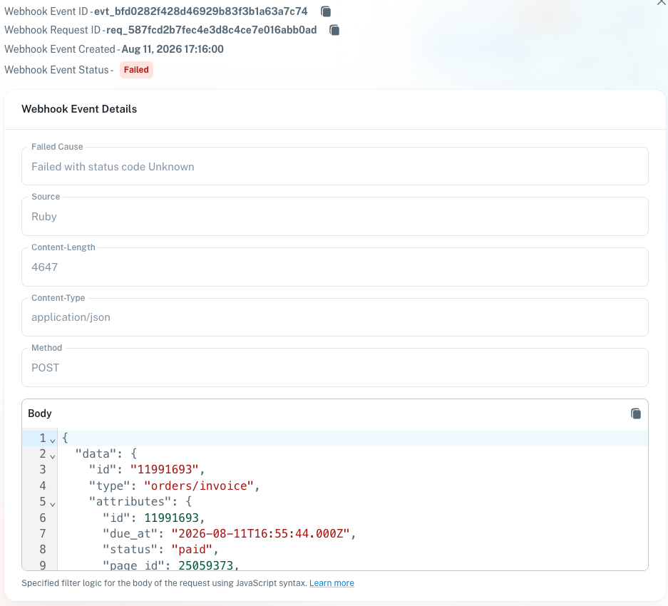

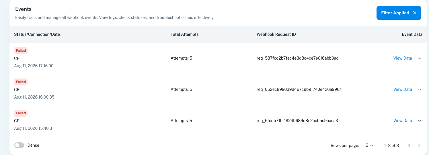

I made 3 test purchases, and I can see the 3 events on Pabbly
However, I can see failed attempts 15 times, 5 for each event
Any idea why this could be happening? Why are there so many attempts per event? I can see the payload on all of them, so I am not sure if this is an issue with my settings or what is going on

The repeated attempts you're seeing are expected retry behavior in Pabbly Hook. When a delivery to your destination isn't confirmed as successful, the system retries up to 5 total attempts, with a 5-minute delay between each — which explains the 5 attempts you're seeing per event (3 events x 5 = 15 attempts).
A key point to check: Pabbly Hook only treats an HTTP 200 response from the destination as a successful delivery. If your destination returns any other status code (such as 201 or 204), it is treated as a failure and retried, even though the payload was received and visible. This is a common cause of what you're describing.
Confirm what HTTP status your ClickFunnels/destination endpoint is returning — it needs to return HTTP 200 to be counted as a successful delivery and stop the retries.
