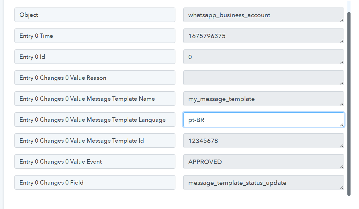

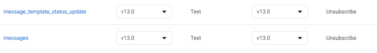

SO I did a detailed troubleshoot. Since, I was not recieving a test response for message webhook. I turned on message_template_status_update and hit test.
I am recieving a webhook response from whatsapp if I select "message_template_status_update" but no webhook response for test message.
The response ---

So, The test message didn't show up.. but I did a live test and live whatsapp message comes in pabbly.. so it means my issue is solved.

I have the same problem as you, I can't capture the 'message' response coming from facebook, only 'message_template', any solution?
RaghavGakhar — Reply ·
Subscribe for messages and then click on collect response, and send a message from your live whatsapp number (because test message is not working from facebook's end, there is some issue, no issues at pabbly end). The response will be collected. Then you can save it and it's done.
