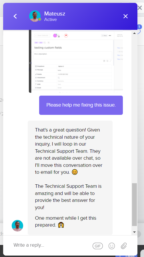

Hey @Rainie
We have contacted the ClickUp support team, till now we haven't gotten any response from them. Though we have contacted their support team on accounts service chat regarding the concern.

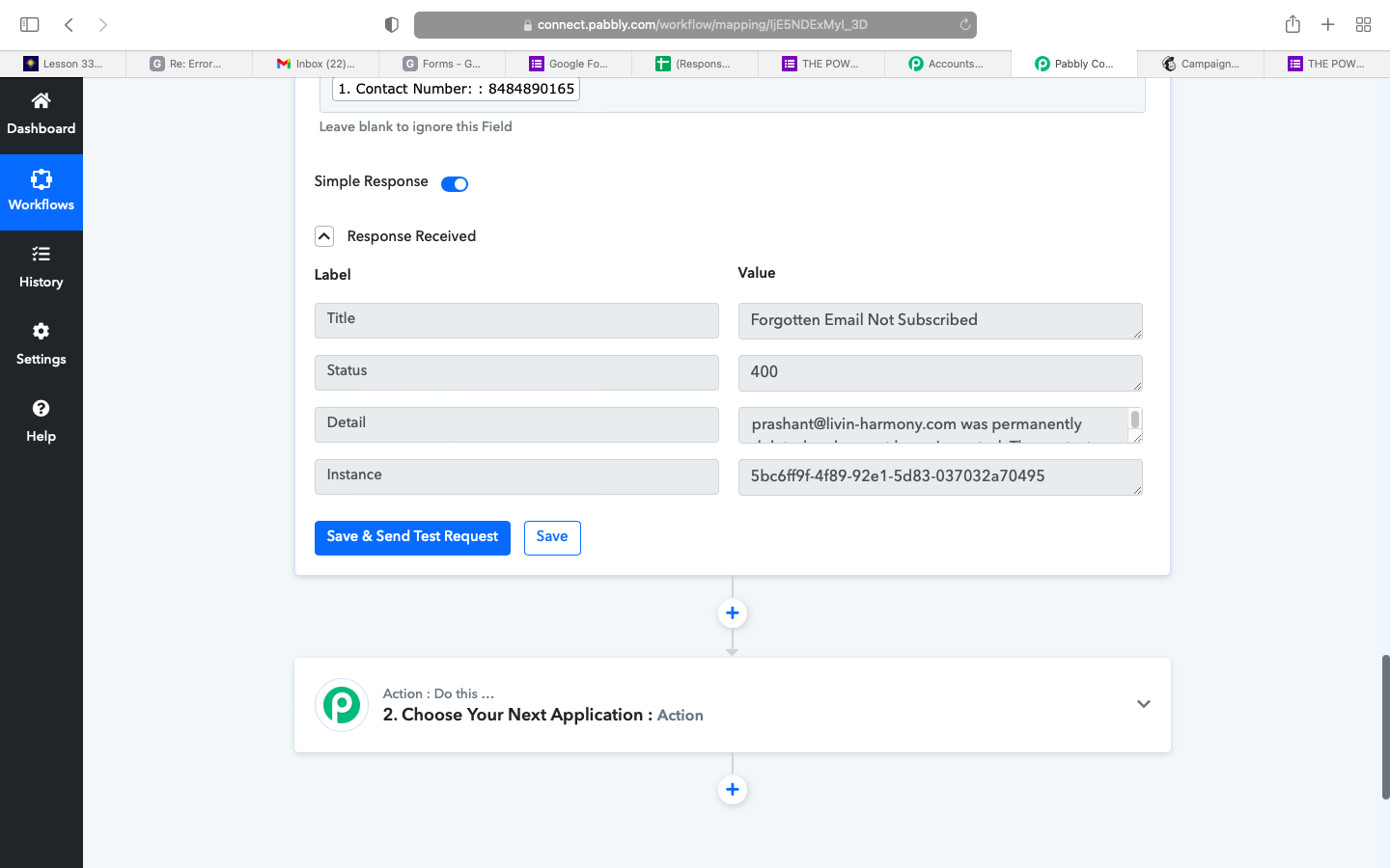

I’m facing issue with creating a workflow and getting a error message.

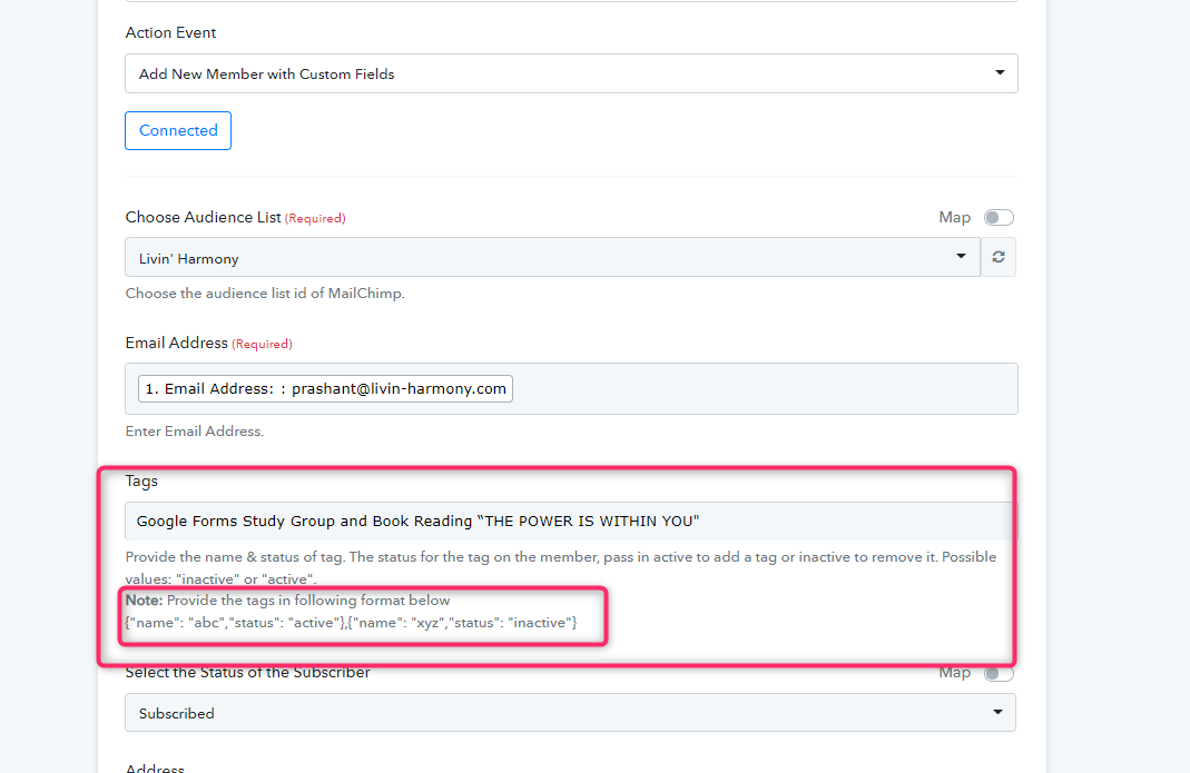

Hey @Livin’ Harmony
We looked into your action step and it seems like you might not have passed the tags in the correct format and because of that, the 400 error is occurring.
Documentation of Mailchimps Error message - https://mailchimp.com/developer/marketing/docs/errors/
Kindly try again with a different email address by re-capturing the webhook response. You might have deleted the respective email address from your account.

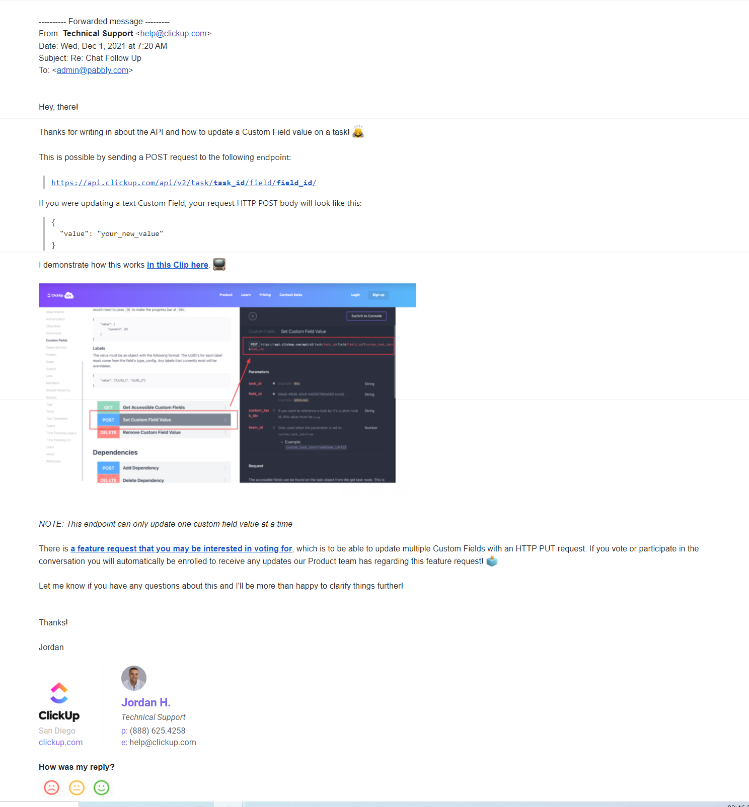

Hey @Rainie
We got the response from Clickup's support team and it seems like the API can only update one custom field at a time.
So as of now, we have to depreciate the action event. But you can use the action event without "Custom fields".

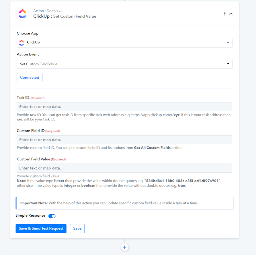

Hey @Atish Hire
I would like to inform you that it's not possible to use a custom field in the "update task" action event of the ClickUp application.
However, to use the custom field, you can use the "set custom field value" action event in the ClickUp application.
Please keep in mind that the API can only update one custom field at a time. So, you would need to create a separate "set custom field value" action event for each custom field that you want to update.
