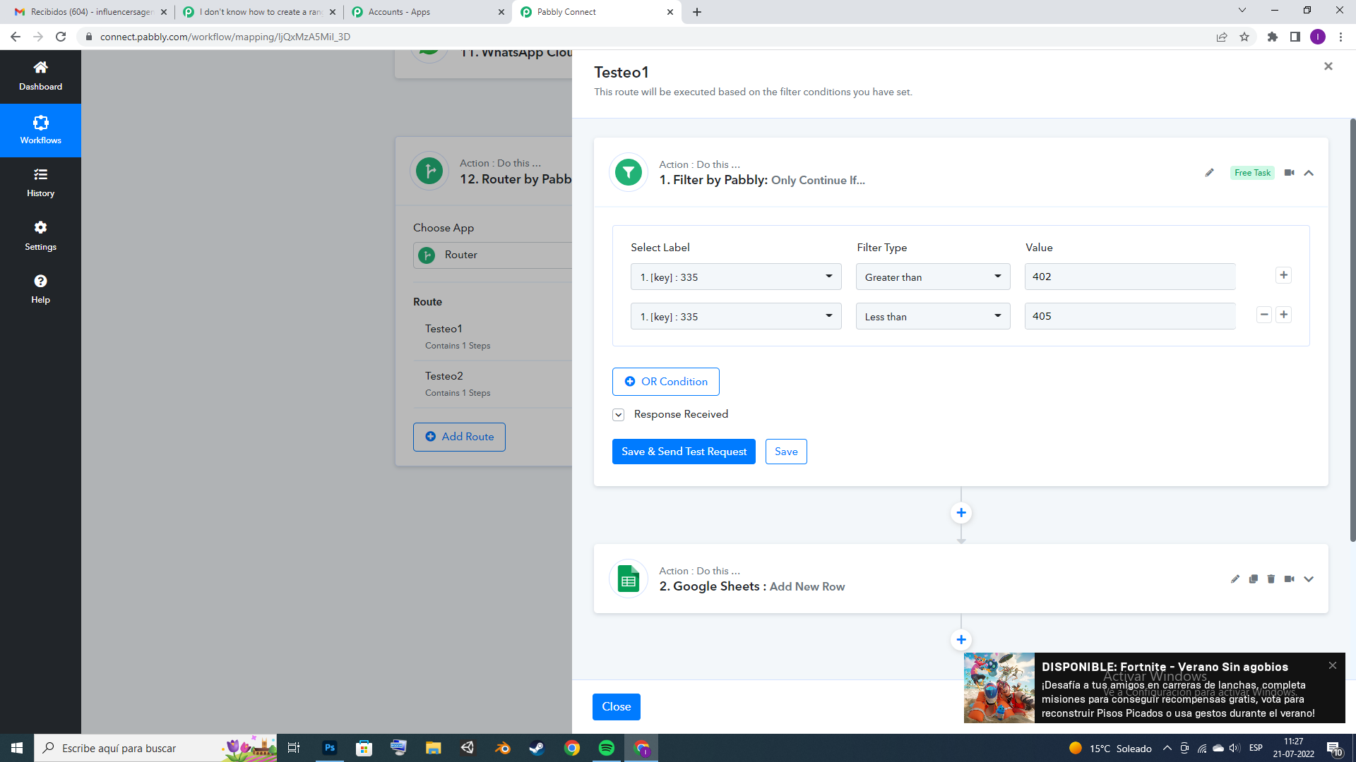

Please share the screenshot showing how you have setup the conation in routers.
Influencers Agency — Reply ·
Hey @pablol44
Kindly use the second condition in the OR condition instead of the AND condition (+ button) for your concern.

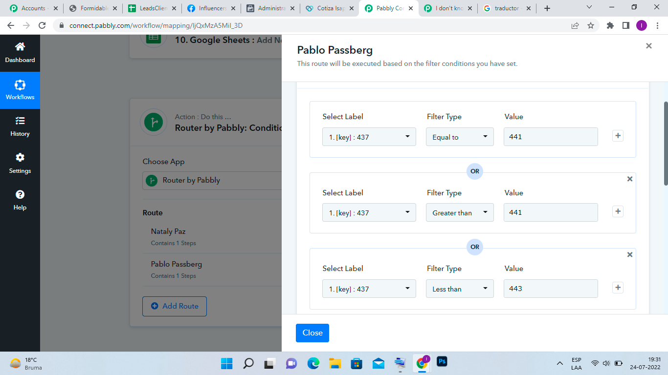

I did what they told me but it turned out that the range does not work I want it to only be activated between the numbers 441,442 but it was activated when the id was 438 so it made me think that I cannot make a range the idea is not to use the function equal to because I'm going to need a wide range of numbers

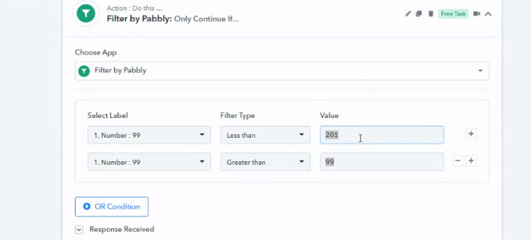

Hey @pablol44
Correction: You can refer to the following screenshot for getting the range.
E.g - If the desired range is 100 to 200.

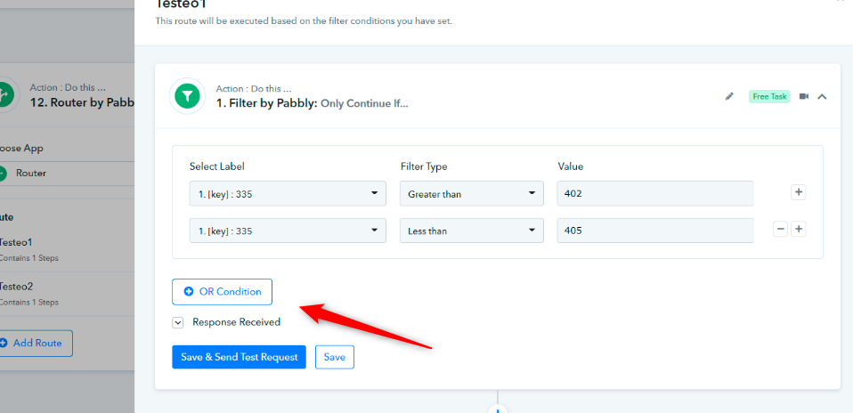

Hey @pablol44
