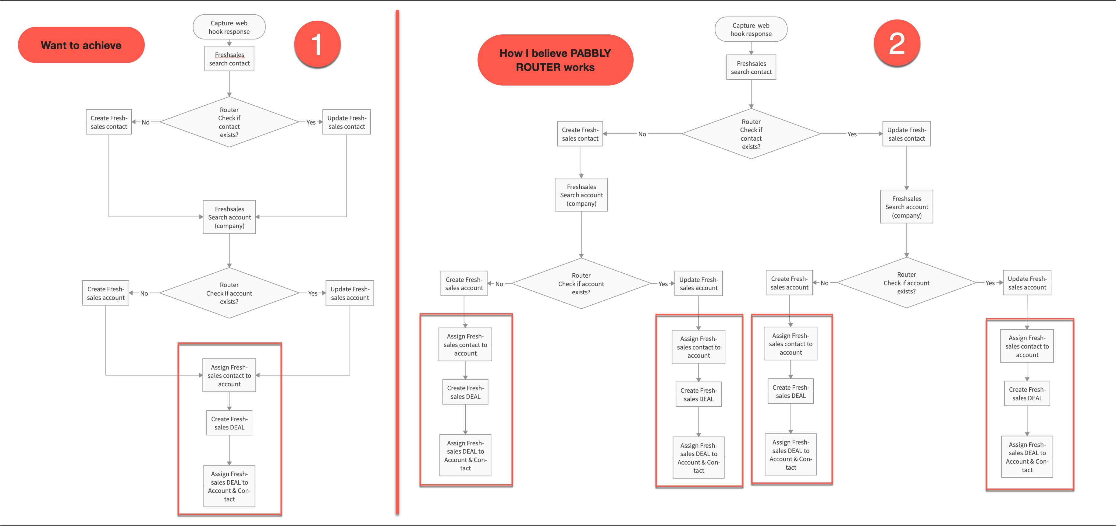

martarna — Reply ·
Hi @Kunal Valuskar
Thanks for assistance.
Maybe I am not understanding how Pabbly Router will work, or I haven't explained myself clearly on what I want to achieve. I have created a flowchart. The attached image has two flowchart images. On the left hand side, labelled 1, is what I want to achieve. On the right hand side, labelled 2, is what I believe the Pabbly router will do. On each side, I have put a rectangle around one part as an example that would appear once on the left hand side and on the right hand side appear 4 times.
I hope the flowcharts help to explain the efficiency I want and if my understanding is incorrect on using the Router you can explain how I can achieve 1 (left hand side) using the Pabbly Router or some other method.

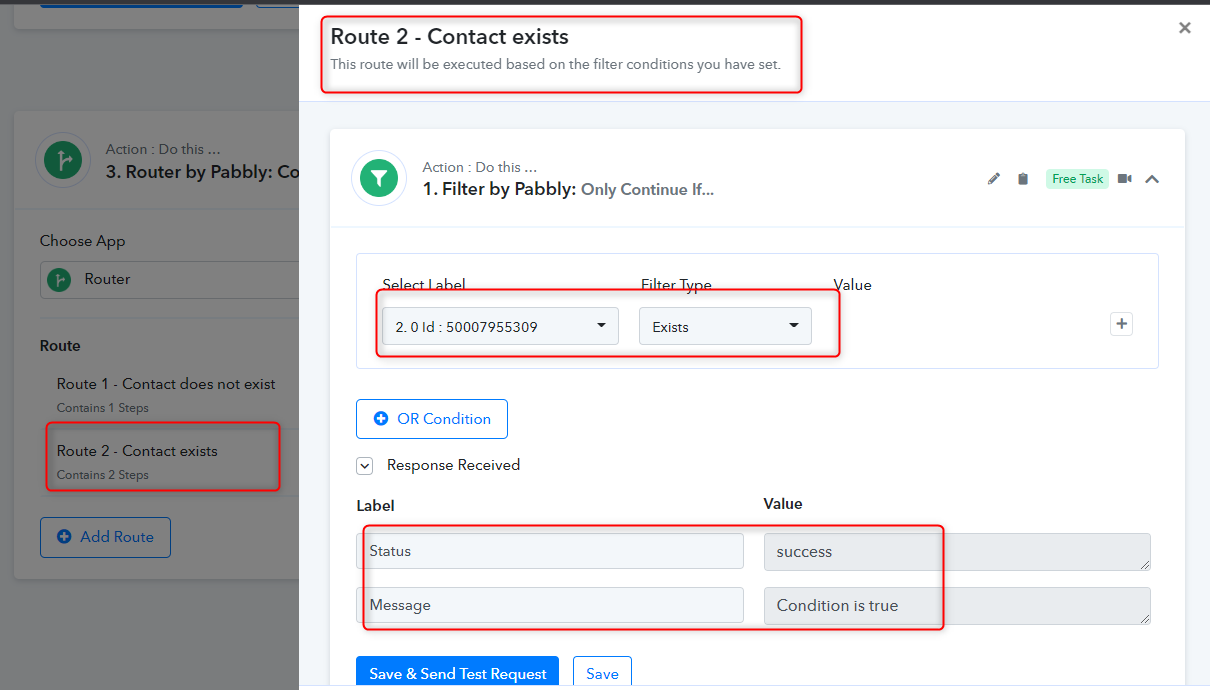

hey @martarna
You can simply use the Router and apply the if and else logic.
Router 1:- Check if your contact exists >> Update contact in Freshsales account >> Perform the next actions..
Router 2:- Check if your contact does not exist>> Create a contact in the Freshsales account >> Perform the next actions..
Please check the above steps and let me know if you have any questions or comments.

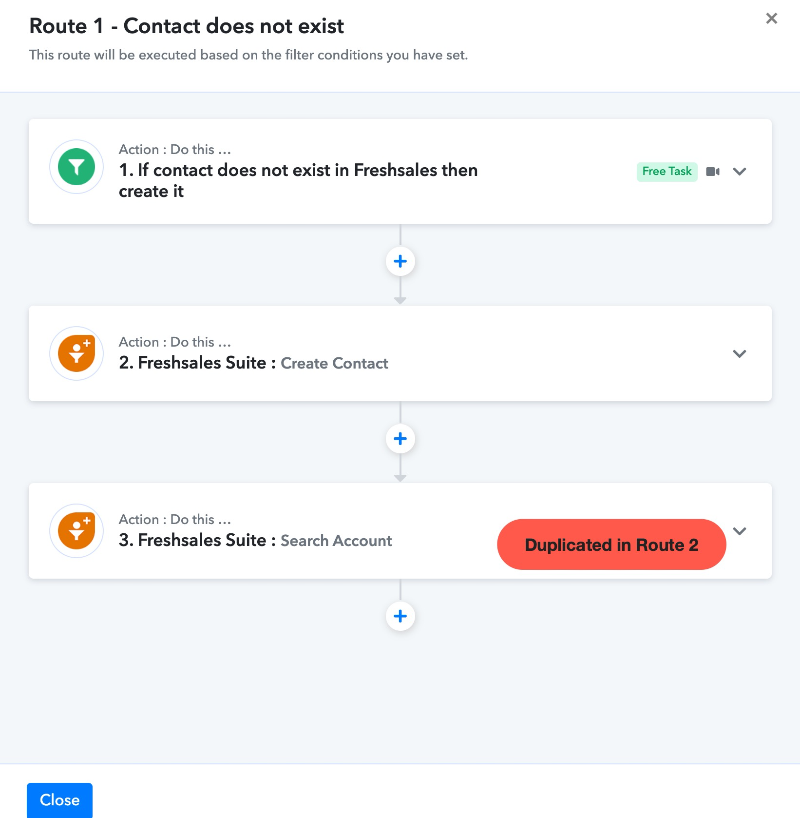

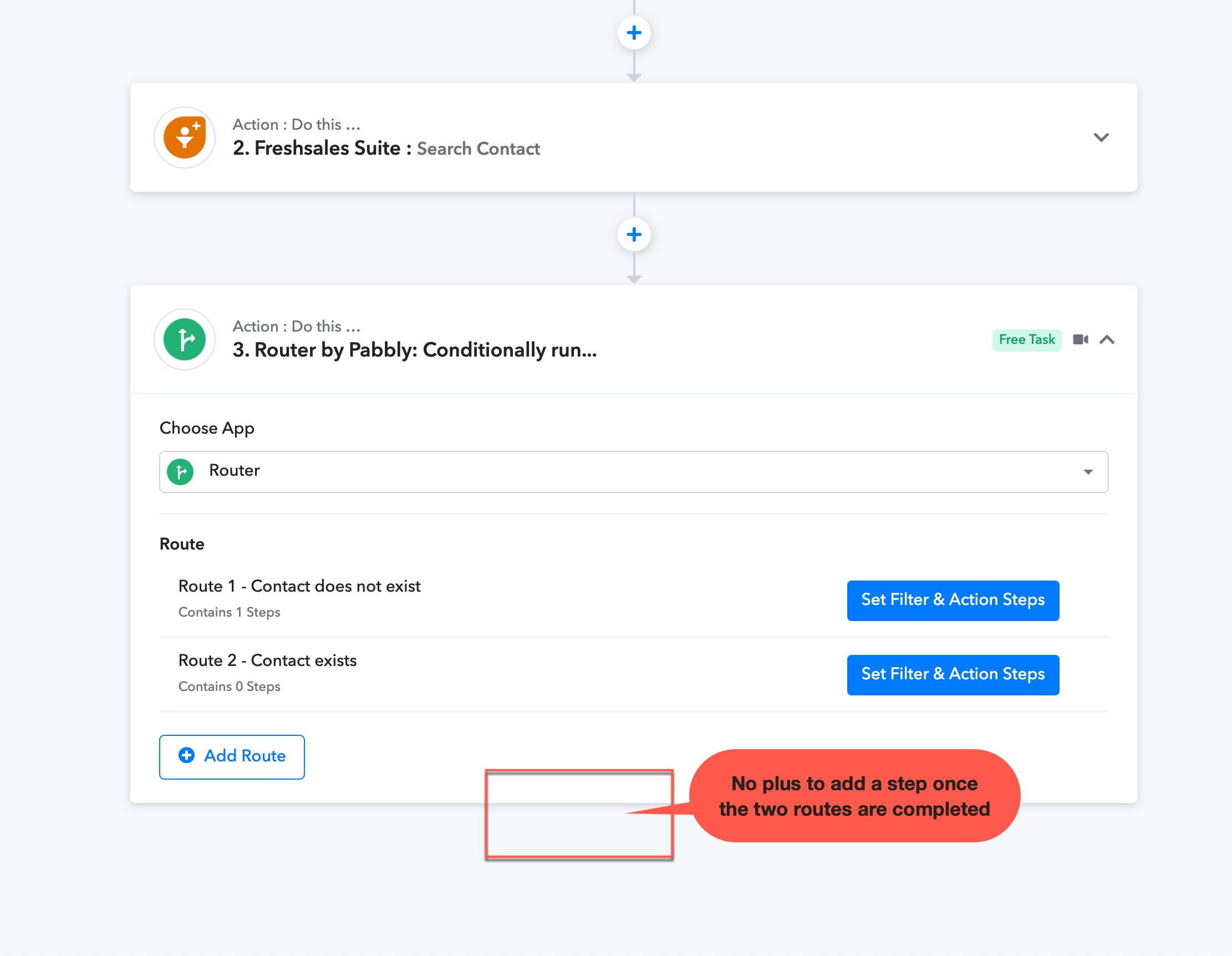

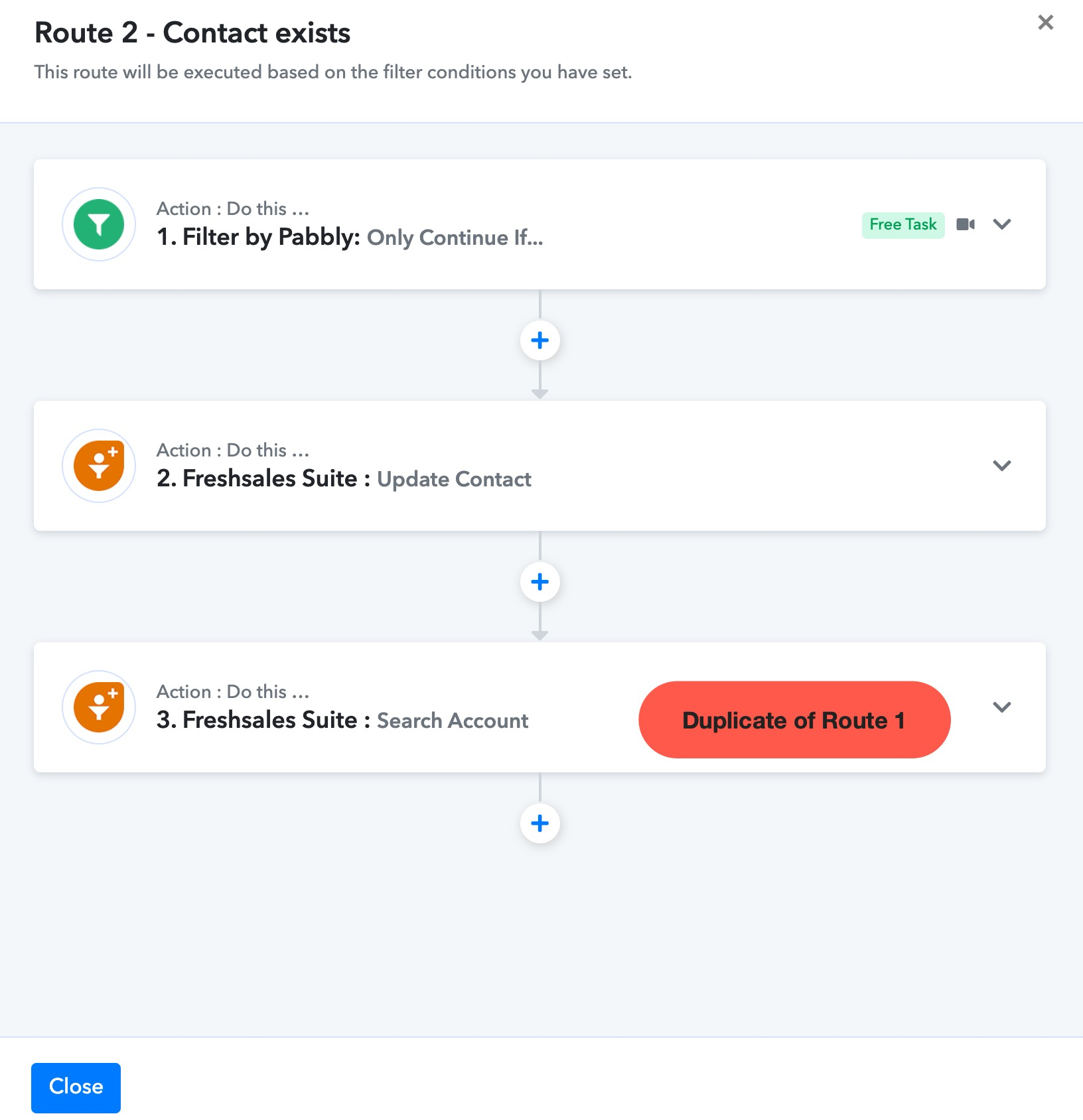

martarna — Reply ·
Hi @Kunal Valuskar
I have done as you suggested and completed the steps as per my number 1 flowchart. However, i do not find any plus sign to amalgamate the two route forks back into the one main workflow to continue with the next steps.
If I continue down Route 1 and add the further steps after creating the contact, I am creating a messy and unmanageable workflow to support.
I continued to enter a step in Route 1 and then duplicated in Route 2. However, this is inefficient. Is there a better way?

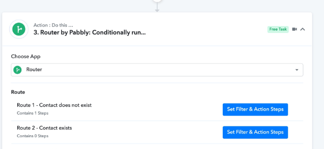

PabblyMember4 — Reply ·
Hey @martarna
We have checked your workflow and corrected the If condition (when contact does not exist) and else condition (contact exists). Kindly check the below screenshot and add the further actions in your workflow.
Kunal

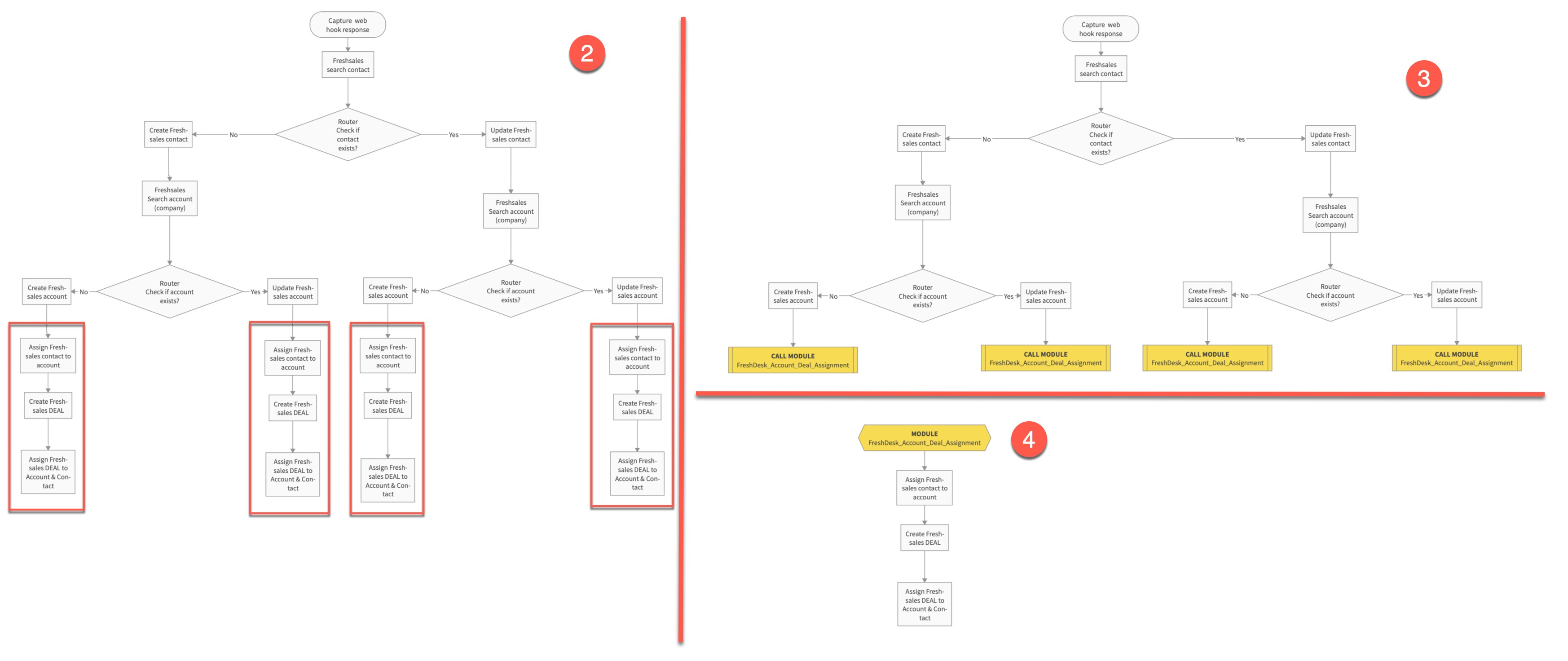

martarna — Reply ·
Hi @Kunal Valuskar,
I couldn't think what else to call them. In programming languages, there are modules. Whereby it contains code that allows the programmer to call upon at different points in a program.
If you look at the flowchart I posted back on the 12 Dec 2022 20:11 on label 2, you will find four red boxes. If the three items in the red box were a separate module, let's say we call them "FreshDesk_Account_Deal_Assignment". Then each time you want to process those same steps, you call the module "FreshDesk_Account_Deal_Assignment". Each time the module is called, you may send different values to the module to be used within the module steps.
The image below starts with the label 2 image from the 12 Dec 2022 20:11, and to the right two new images labelled 3 & 4. In label 2, you still have the four red boxes with three workflow steps. In the label 3 you find four calls to the module "FreshDesk_Account_Deal_Assignment". In label 4, is the module "FreshDesk_Account_Deal_Assignment" with the three steps.
You see from the image that there is a saving of placing the same three steps in four different areas.
Regards
Peter
