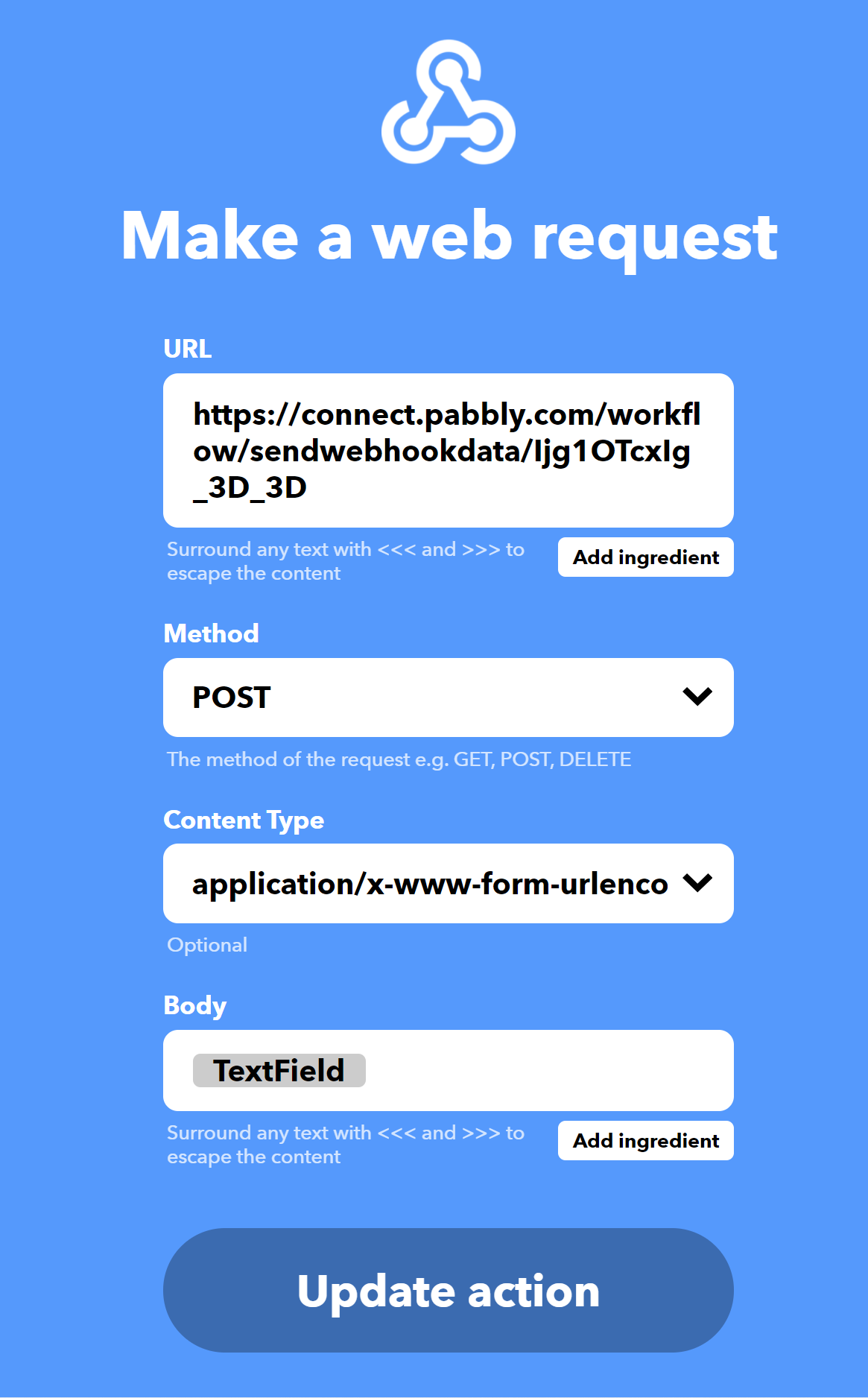

I am using IFTTT's webhook to send a POST to Pabbly's webhook url.... all good there... this is how the setup looks on IFTTT side of things:

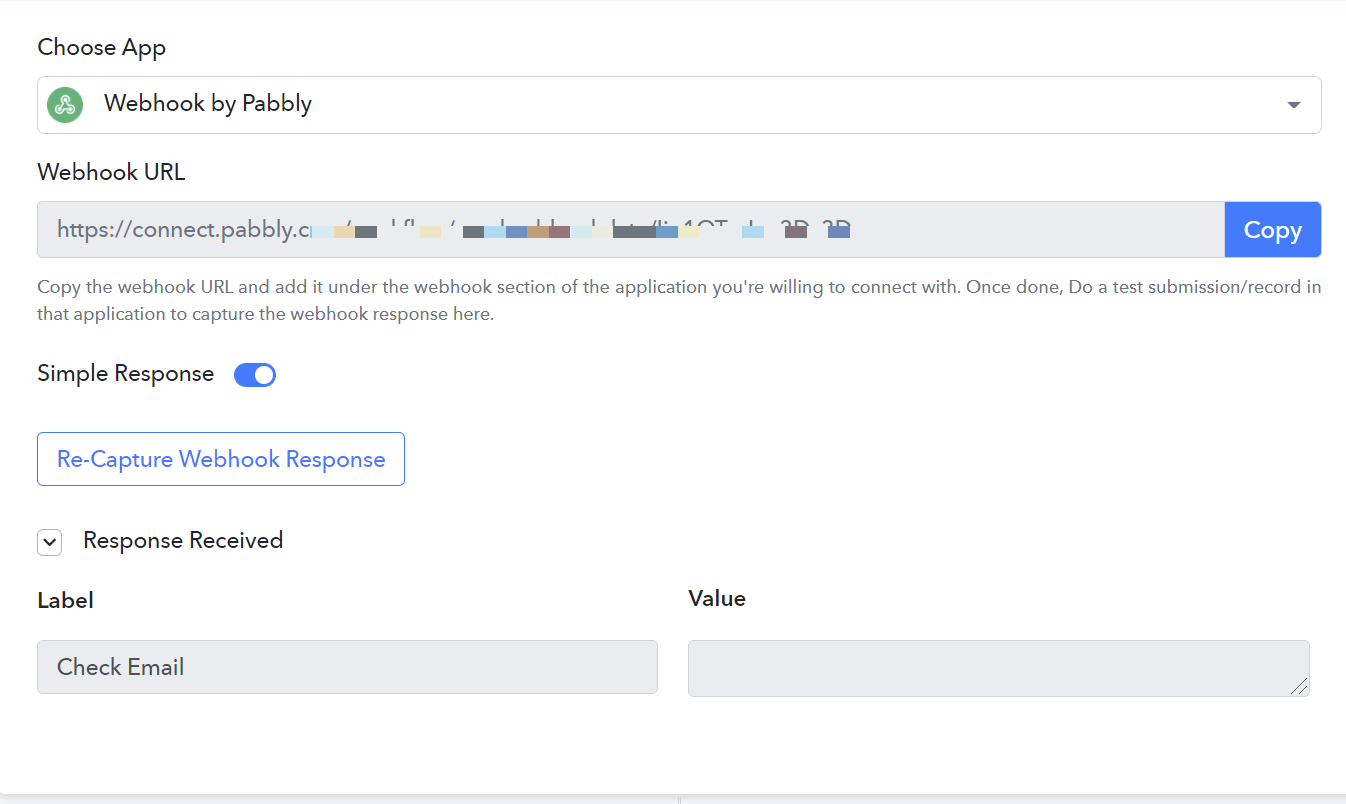

pretty simple...now the issue comes up when I get it in Pabbly. Notice that the {{TextField}} becomes a 'Label', while the value is empty.
QUESTION: how can I get the body to go into the Value field?

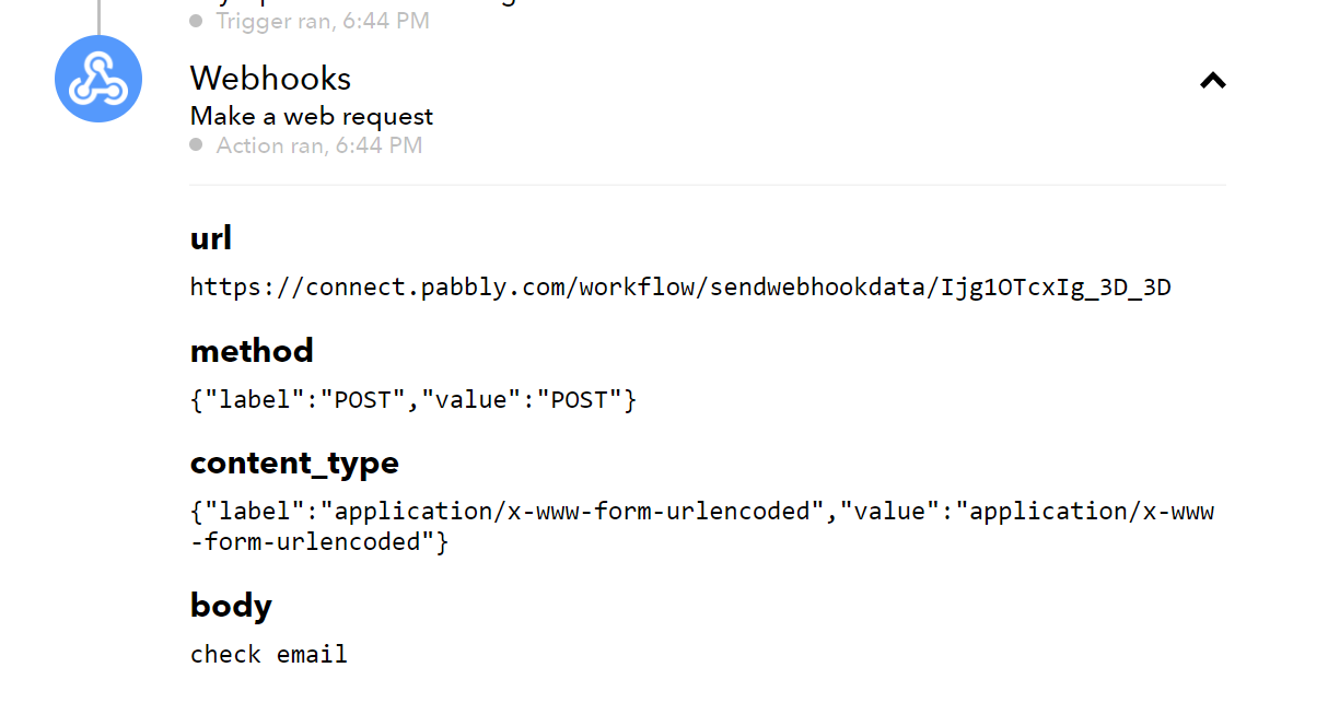

When I check the activity, I see the following webhook info in IFTTT:
You will ask, "Why did she use 'application/x-www-form-urlencoded" instead of plan text? Answer: that's the only option that sends the body over. Plain text option did not work.
