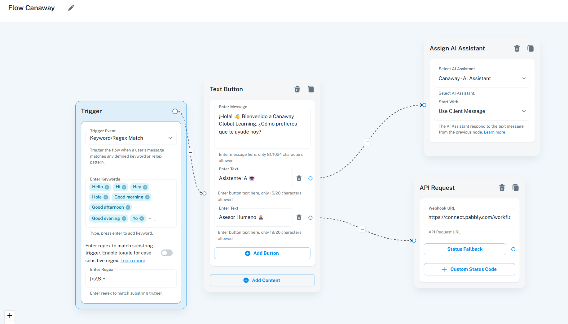

In this screenshot, I show you the initial Flow.
If the user chooses the “Asesor Humano” option, a Pabbly workflow is executed, which is https://connect.pabbly.com/workflow/mapping/IjU3NjYwNTZhMDYzMzA0M2M1MjY4NTUzZDUxMzUi_pc

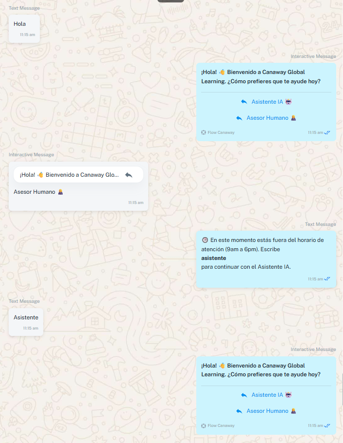

After interacting with the Flow, if it is not during a permitted time, you will receive a message asking if you want to talk to the AI assistant again. If you type the word “asistente,” it does not execute the flow it should, but instead executes the main flow.

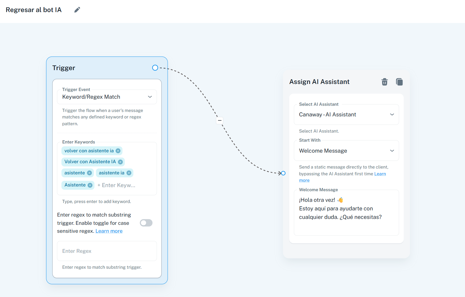

This is the flow for returning to talk to the AI:
Here is a screenshot of how it works now, which is not correct:

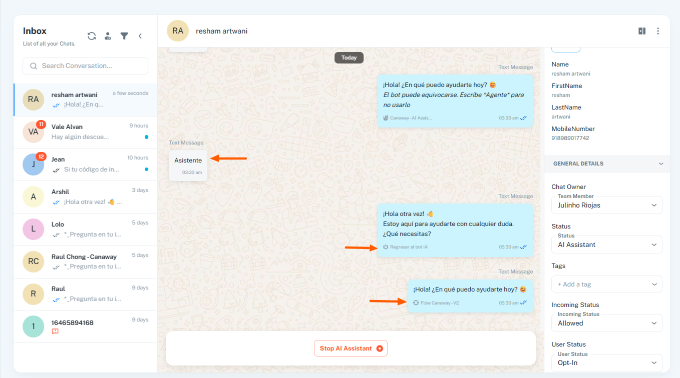

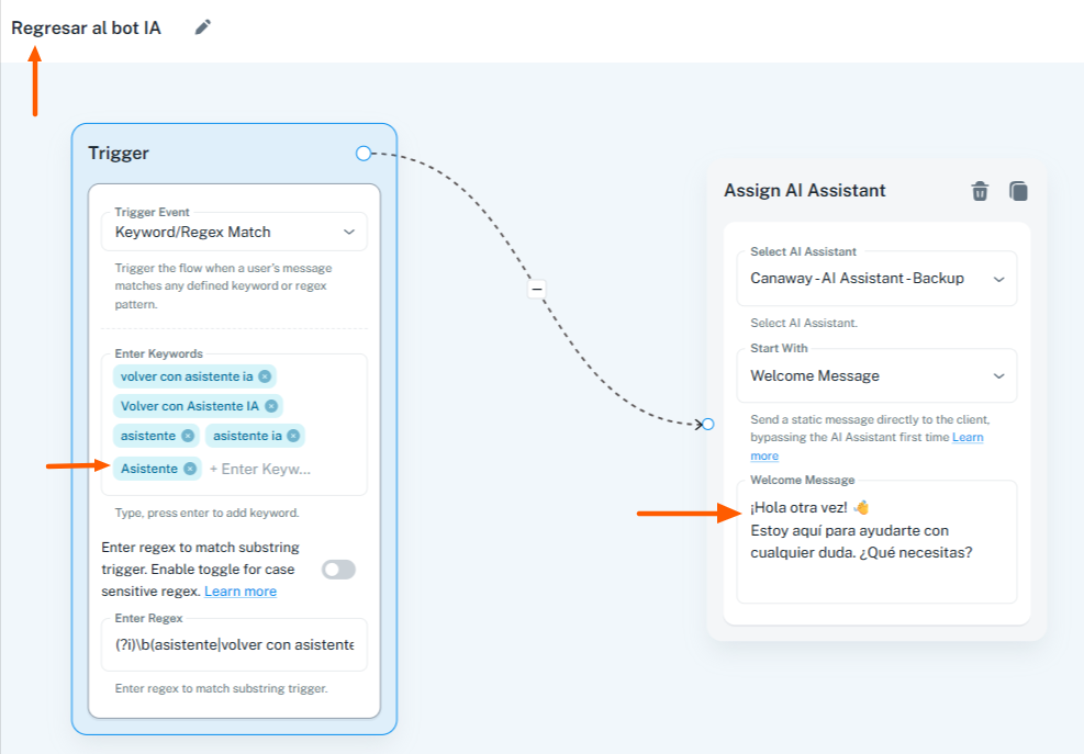

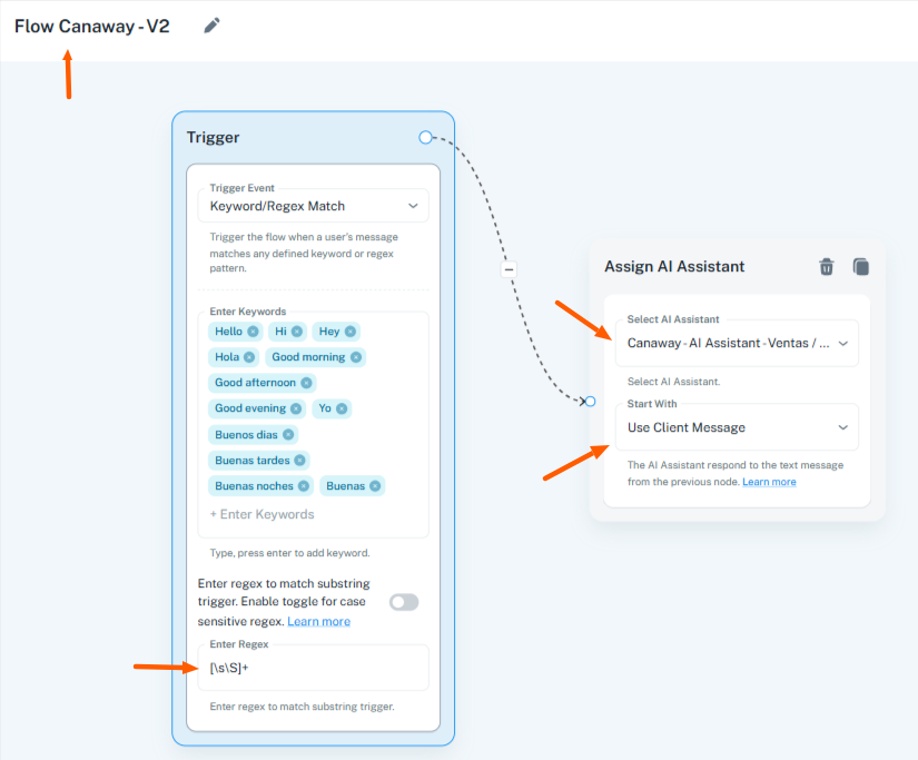

Hello @rfchong,
Upon reviewing the active flows in your account, we found the following (names listed below) to be functioning as expected.
Regresar al bot IA
Flow Canaway - V2
We conducted a test in which we attempted to send a text message with the Asistente. In both cases, the flows triggered as intended. One of the flows contains a regex that accepts any text string sent by the user that is longer than one character. As a result, such messages are being captured, triggering the flow, and subsequently assigning the AI Assistant with the welcome message.
This is why you are receiving two messages in this situation.
For further clarity, we have attached screenshots below illustrating the conditions and their impact.
