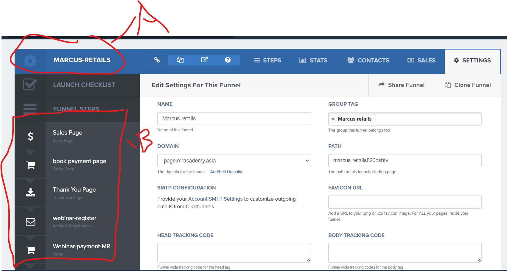

As inside Clickfunnel, each funnel step only can put one webhook. you can see the picture i attached
A: is my funnel
B: is the different step under one funnel
Now my situation is like this:
1. the pabbly webhook will capture all the data from one funnel, which means all my step in the funnel will be capture and record in one google sheet
2. So my questions is how can i separate different funnel step to different google sheet?
thank you.

Hey @market think
If you are using the same webhook URL in all the other funnels and If you are receiving the responses from other funnels aswell you can use the Router action step to distribute them by creating individual routes and storing them in the respective Google Sheets by configuring them in each route.
You can check the following video tutorial on how you can use the router action step -
