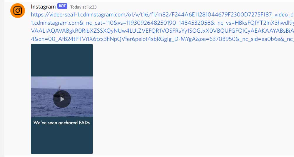

I'm trying to get Instagram to send a post to Discord. I've managed to both connect and send messages to a Discord channel but it is including the link, as well as the media.
I watched your Insta integration video on YouTube but it appears to be using a different set of drop-downs. The only options I have are Username, Timestamp, Permalink, Media URL, Media Type, and ID.
In my HTML message the only option I can use is Media URL, which posts the video ok but also includes the link. When I run a test post it returns The application processed the request but returned a blank response. Refer to the HTTP status code above for details. The code is 204.
I'm sure there's a simple explanation, but how do I post the media only without the ugly long link?

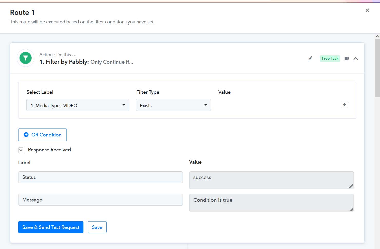

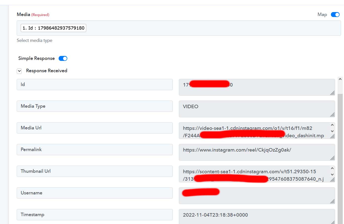

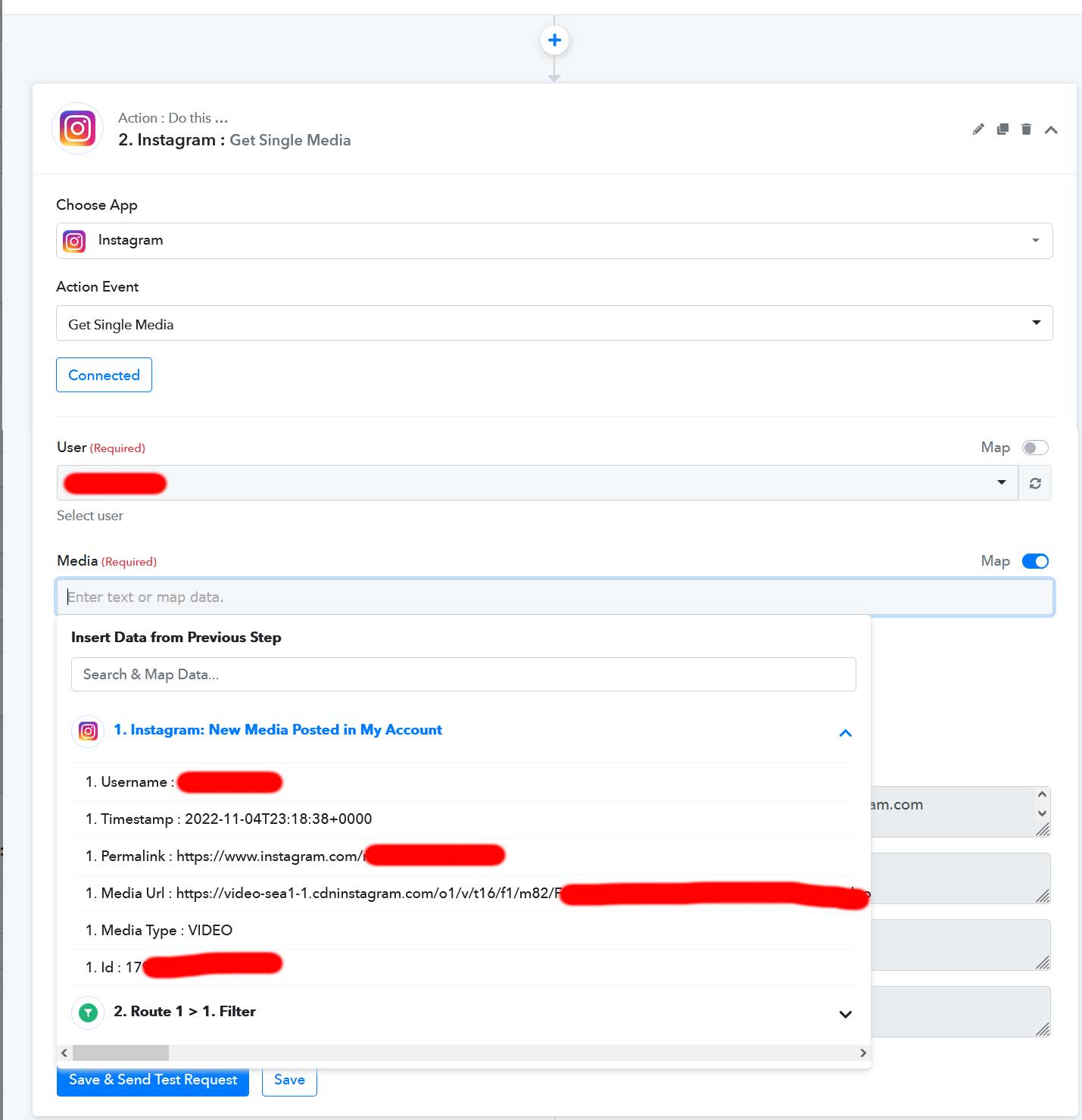

OK, so I understand the concept of individual routes, but I am not understanding how I extract the media file. The video you directed me to was about WhatsApp, not Instagram, and goes into detail about the WhatsApp bot providing a URL and other stuff. The Instagram version doesn't have this. This is what my route looks like so far:

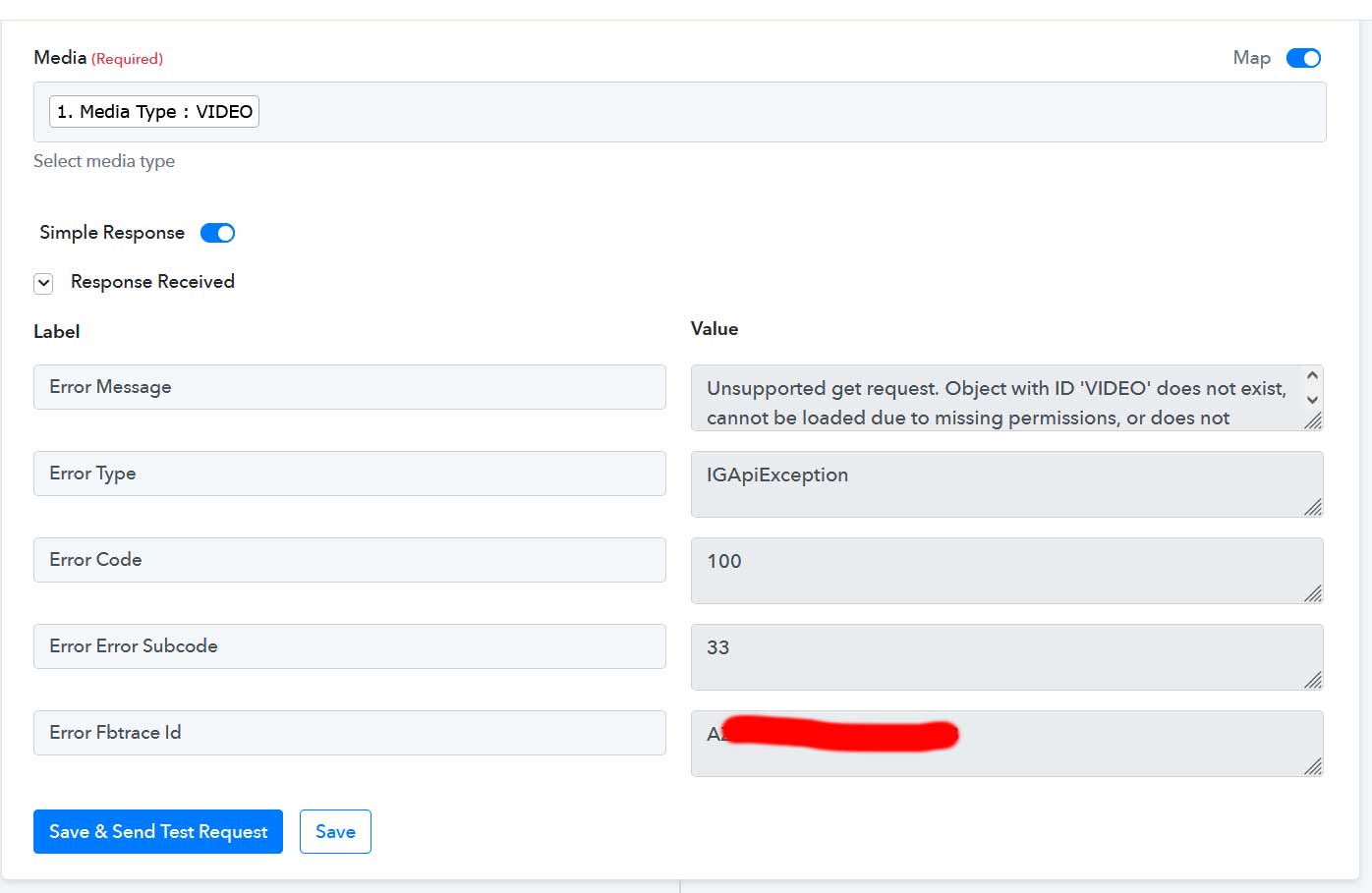

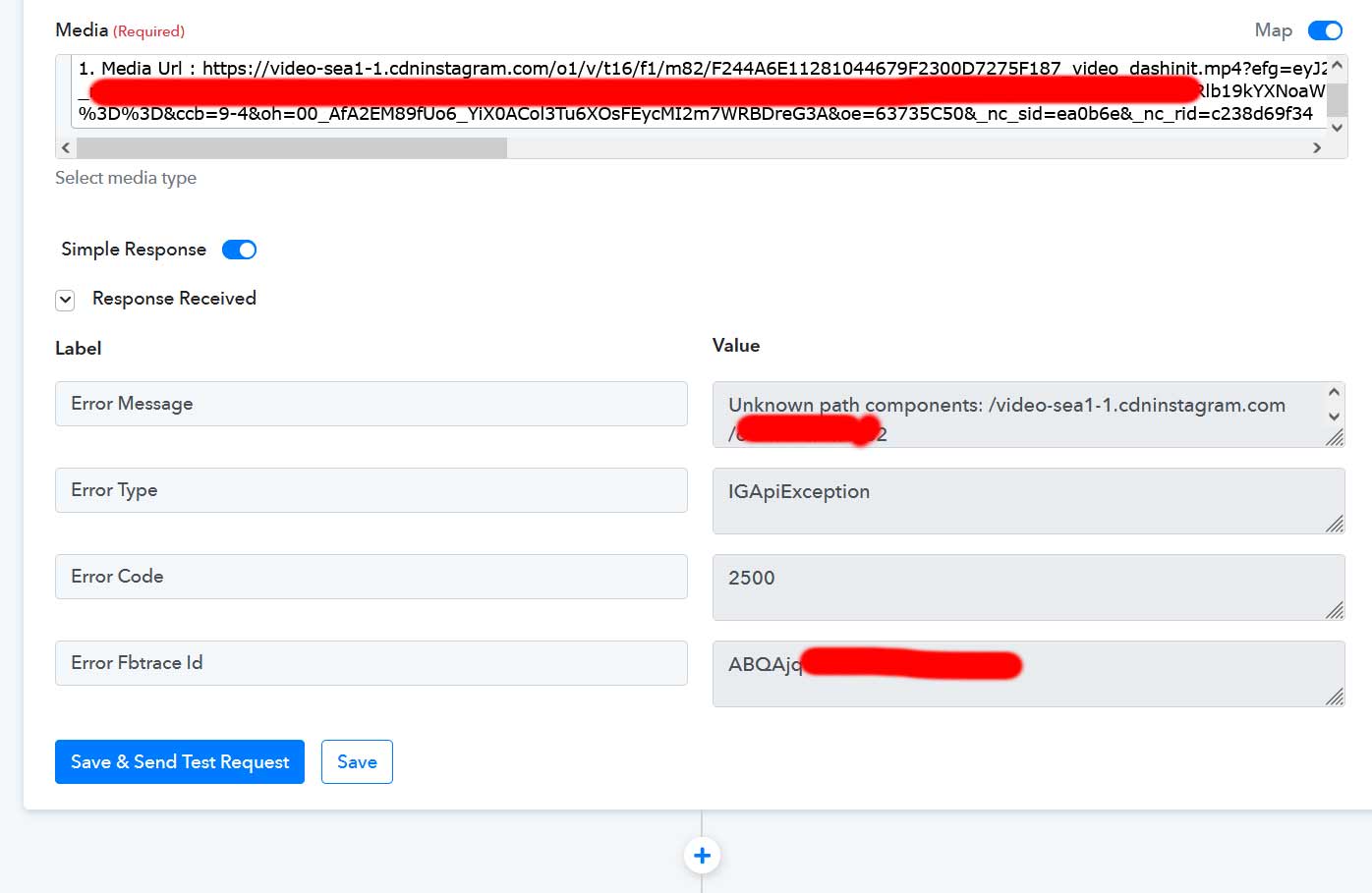

At this point I'm back to where I was originally. That is, I have the same media options and the same media URL. If select the media URL and run a test, I get an error:
... and the same if I select VIDEO...
The one that gives a positive result is ID...

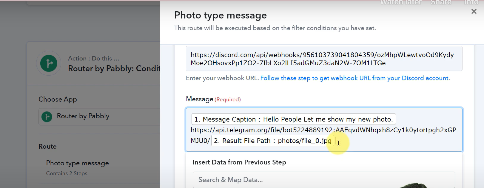

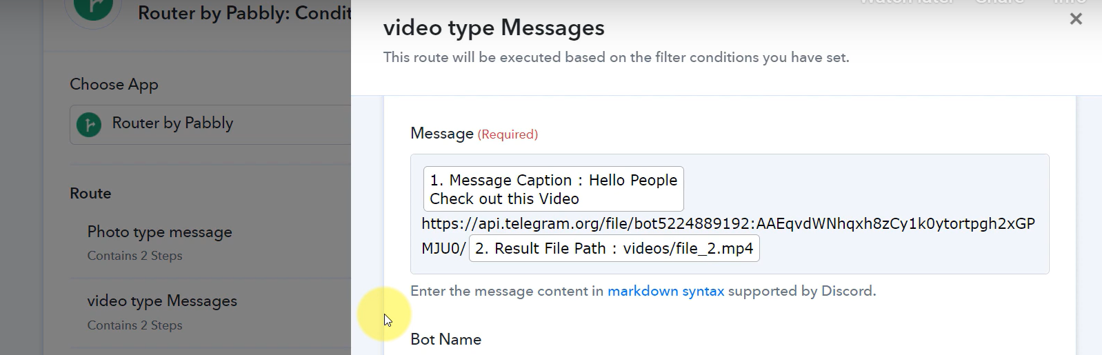

Further, as we can see from your workflow as well, you haven't passed the media file yet.
To send the image to the Discord channel -
(To send the video on Discord)

I CAN send a media file to Discord, this is not the problem. The problem is that it is sending the media file AND the really long link, as per my original post. Please look at the screenshot I embedded in my original post.

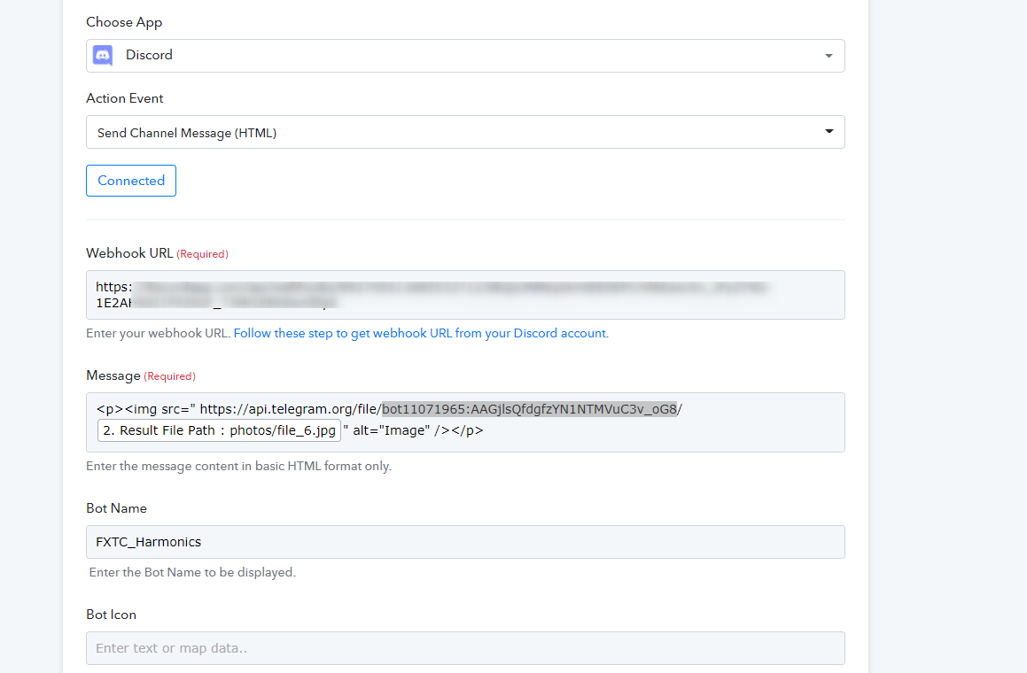

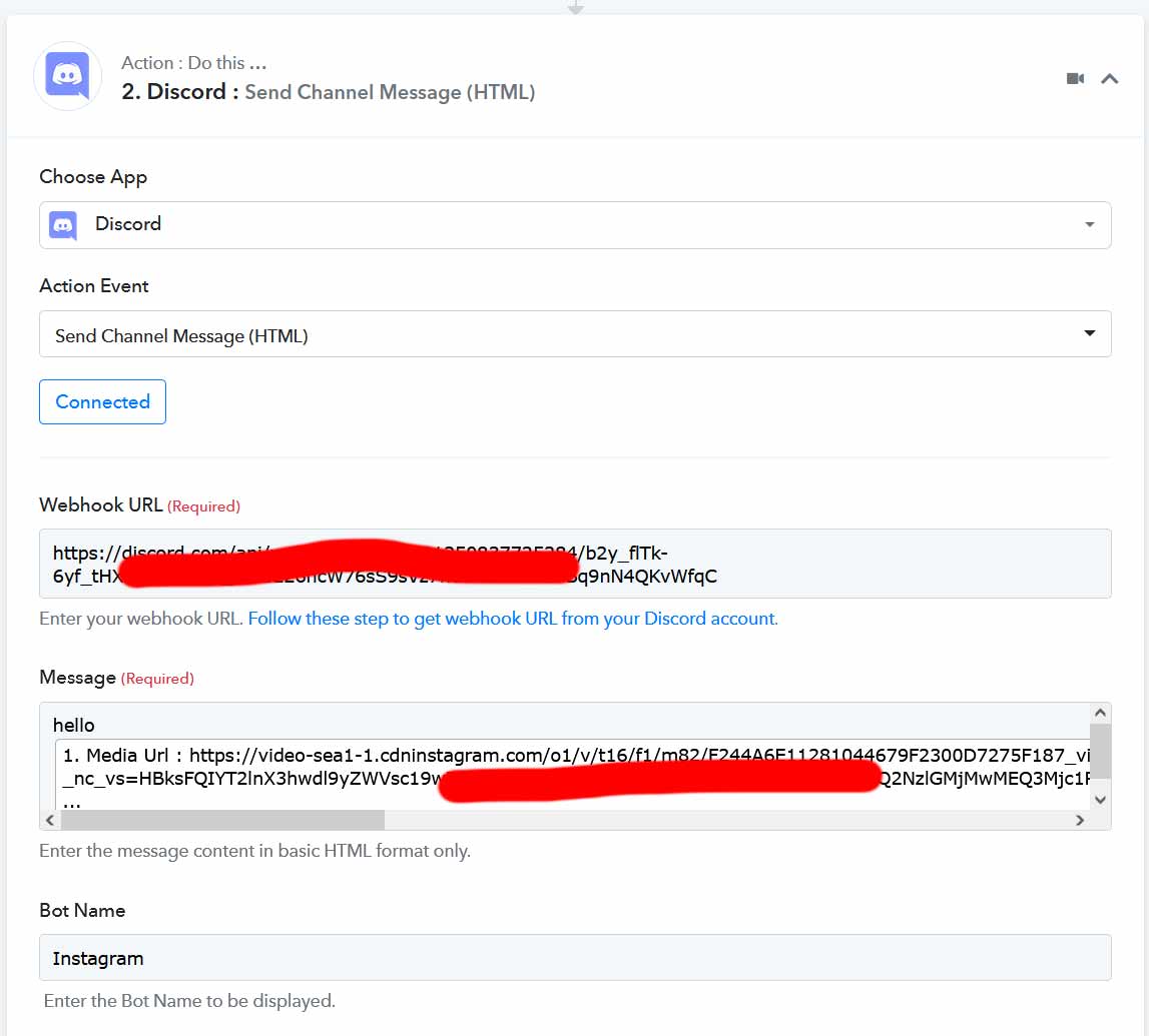

Here is the Discord part of my workflow:

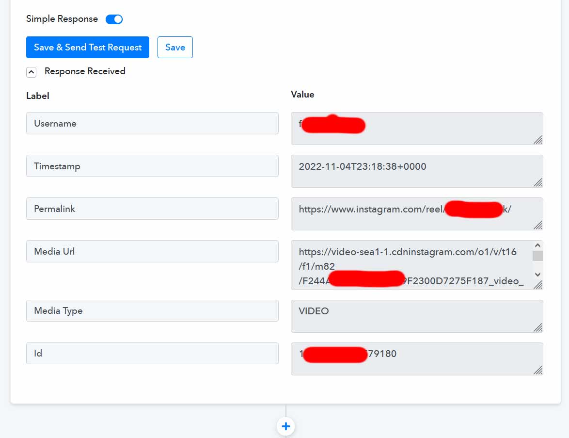

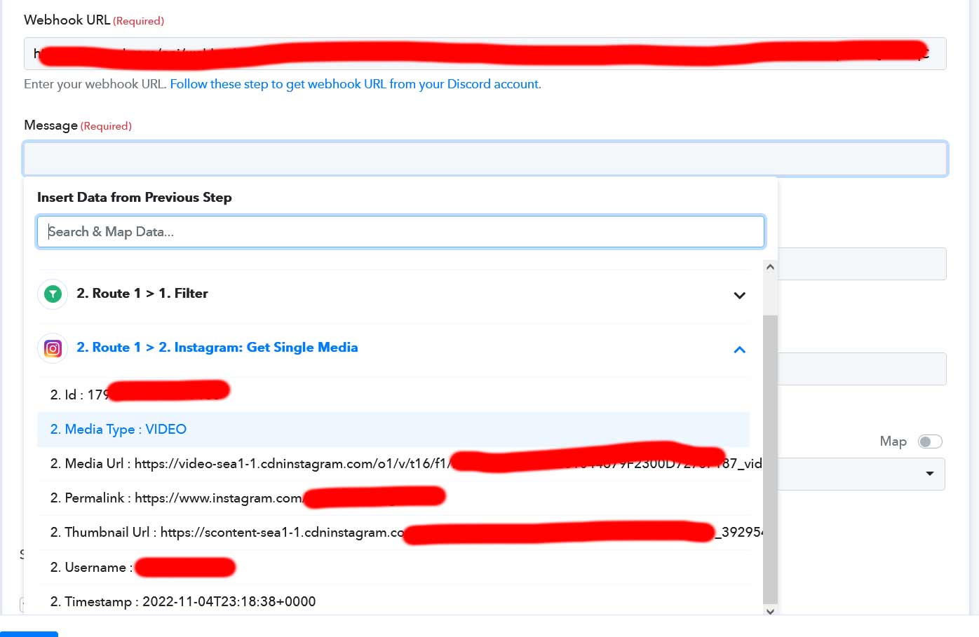

What you are telling me to do is related to TELEGRAM, which has a Results File Path, as per your image. INSTAGRAM does not have this. This is what Instagram delivers:
So how do I use that Media Url to send the video only, without the link?

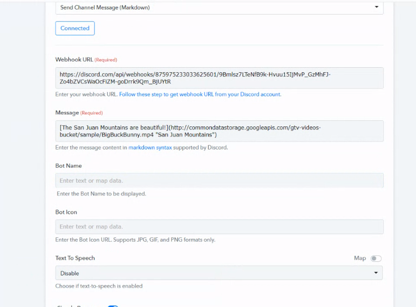

[IMG width="567px" alt="1668839179325.png"]https://forum.pabbly.com/attachments/1668839179325-png.18053/[/IMG]
Since you are trying the HTML in your Discord action step and we have suggested you use Markdown to send the Video so that it might not show the entire URL only the image of the video.
Please check the screenshot carefully and try it.

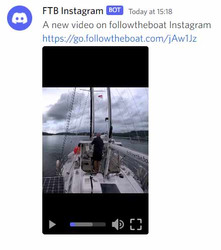

OK, I have worked it out, and it has nothing to do with my workflow. I thought I would include this update for anyone else having the same problem, but what I was doing was correct right from the start.
The problem is at the Discord end. Discord will always include the link of whatever media it is embedding. You can turn off the inclusion of embeds, but Discord will always include the link. I've yet to find a way of turning this off.
The best workaround I came up with was to use short.io, setting up a new cname on my server (as instructed on short.io's website) and have created a much neater-looking link. It doesn't remove the link but it does make it look a lot tidier.
