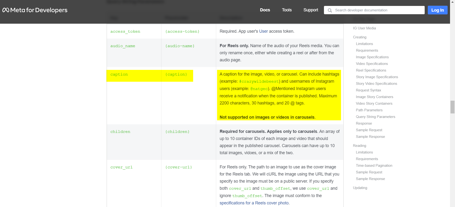

I have made several attempts using various combinations, and it seems that the workflow functions properly when I do not include captions generated from Open AI. I'm not sure why the error 500 occurred, which appeared to be related to a verification issue. However, I discovered that the workflow functions correctly when captions are omitted. Now I need to determine the maximum allowable length for captions in order to successfully publish reels on Instagram.
