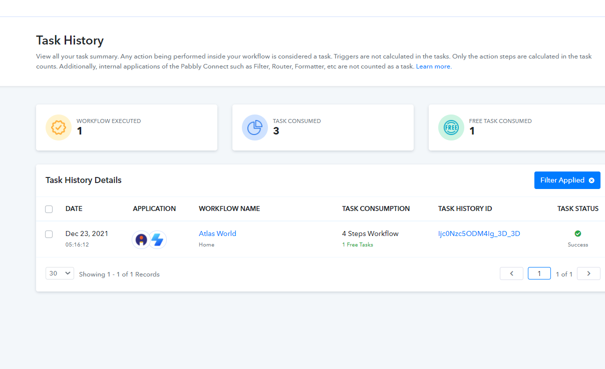

I made an automation that started with a web hook being fired on payment being received on instamojo. I made this automation on 15th Dec. It was fired and perfectly executed for the first time on 17 dec. Today (22nd Dec), second payment came through the same link, but the automation was not executed even 1 hour after the payment was made on instamojo. Way out from here ?
Hey @peterpan
We looked into your account and checked your workflow (Atlas World) created on 15 Dec and it seems like the workflow is executed perfectly.
Please check the workflow history which shows all the executions.
peterpan — Reply ·
Yes, that executes perfectly. I was talking about another one (Laxmikant + Atlases Package). It didn't fire yesterday and then I tried with my own test payments and still it refused to execute. I then, remapped the data using web hook testing tool in instamojo and today while another payment came in, it fired perfectly again.
The point is that, with such erratic behaviour, I am not at ease and rest assured that my automations are being taken care of . Please let me know if I can do anything on my end to rest assured that such inconsistency in execution of my automations can be avoided.
Hey @peterpan
The Instamojo's trigger is a descriptive-based webhook trigger for which the trigger captures the data directly coming from the Instamojo's API as the trigger is a webhook type trigger.
