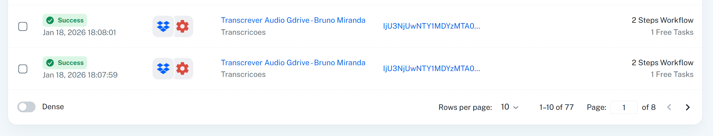

Hello, i was trying the new File (Instant) Trigger.. i think there is one problem... If i add to a folder, let's say 4 files.. im having repeated triggers for the same file.. These two at the screenshot have the same file being triggered.. so im having twice or triple times the smae workflow... im trying to add a intermediary var to double check but this should not be the normal behaviour.. maybe its happening because i have dropbox connected to other devices?

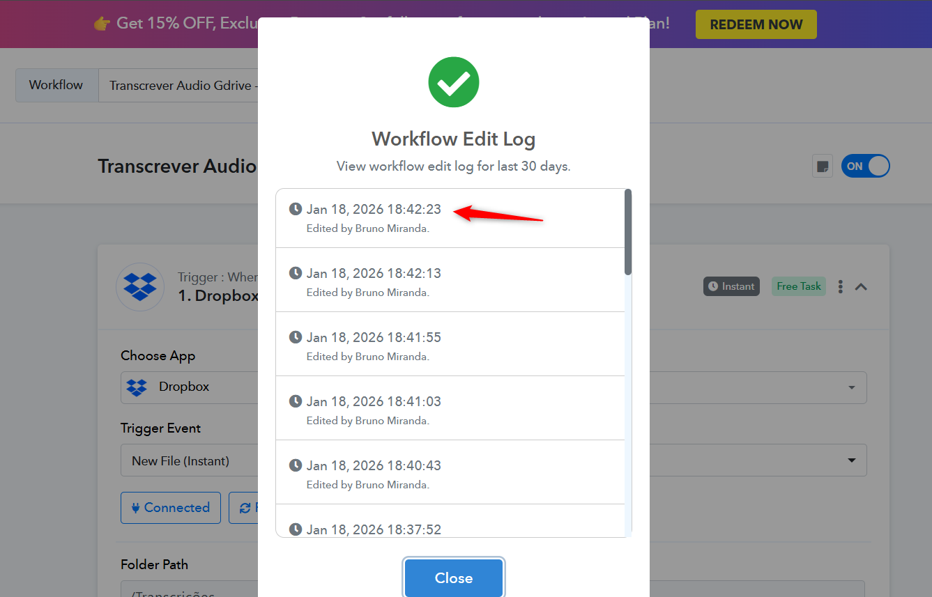

Based on your Task History, we can see that there is a file that triggered your workflow twice when it was uploaded to your Dropbox account. However, since changes were made to the workflow after those tasks, we’re unable to determine the exact cause of the issue you encountered.
Task History ID - IjU3NjUwNTY1MDYzMTA0Mzc1MjZjNTUzMTUxMzI1MTYyNTQzNjBmMzki_pc
Task History ID - IjU3NjUwNTY1MDYzMTA0Mzc1MjZjNTUzMTUxMzI1MTYyNTQzOTBmMzci_pc
Based on your most recent task history, we couldn’t find any file whose upload triggered the workflow twice. We suggest monitoring the workflow for some time, and if the issue persists, please let us know without making any further changes to the workflow.
