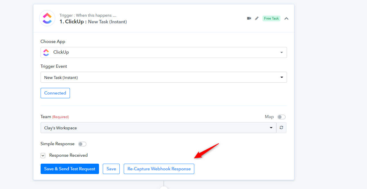

Hey @BoomShaka
Please click on the recapture button and then do create a sample task in ClickUp.
Further, make sure to not click over the "Save & Send Button".

OK. I have clicked the recapture button and then created a new sample task.

I've tested the workflow a couple of times now, and it appears to be working correctly....with no more repetitions! Is there anything you can share that I was doing wrong, so that this doesn't happen to me with future Pabbly workflows? Or was this just a bug in the system?

Just don't click over the "Save & Send Button" button as that was creating multiple trigger events in your ClickUp account and thus you where getting multiple data every time.

Just don't click over the "Save & Send Button" button as that was creating multiple trigger even in your ClickUp account and thus you where getting multiple data every time.

Got it. I figured that might have been the problem, so thanks for confirming. Thank you again for all of your help! Very happy with the support you provide!
