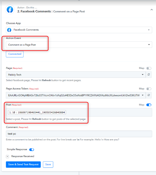

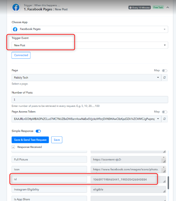

Yes, you can achieve this scenario by adding Facebook - New Post as trigger event in your workflow and you will get the Id for that post. Screenshot for your refernece :-
Once you get the id from the Facebook Post then you can map it in action Facebook - Comments on Page Post and add the comments that you want to add in the posts.
By above you will able to auto post reply to all the Facebook posts that you will be posted. Kindly check the solution and let us know if it helps.

No, you don't need to create a new workflow for each post.
See the 2nd screenshot , you need to map Post Id from step in step 2 , so whenever any post is published it will auto-reply on that particular post.
For all future posts, unless you turn-off the worlflow.
