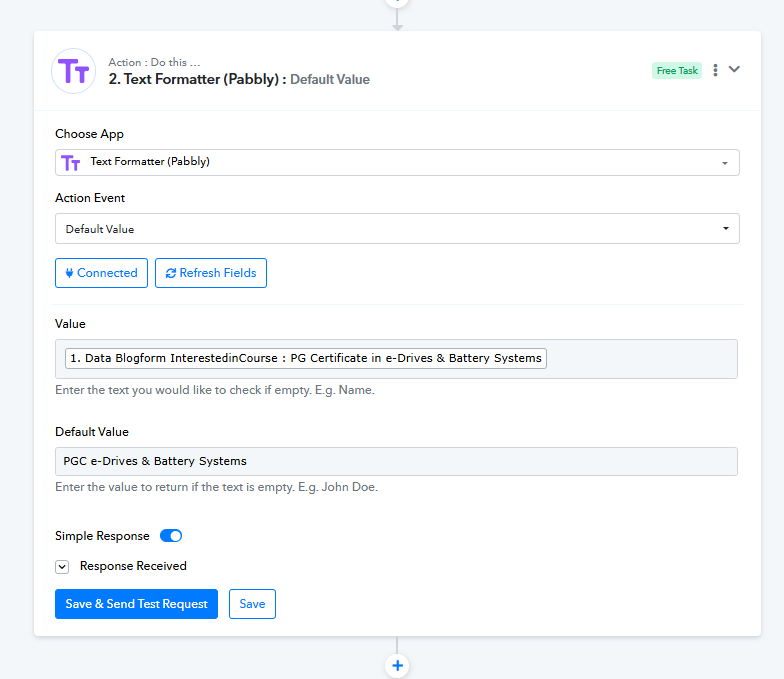

Hello @Pmanifold
You can use “Text Formatter (Pabbly): Default Value” to replace the dropdown values with corresponding CRM mapping values, as shown in the image. However, since you have four values, you’ll need to use the Router (Pabbly): Conditionally Run feature to create four separate routes — one for each dropdown value. Under each route, add the “Text Formatter (Pabbly): Default Value” step for its respective dropdown value.

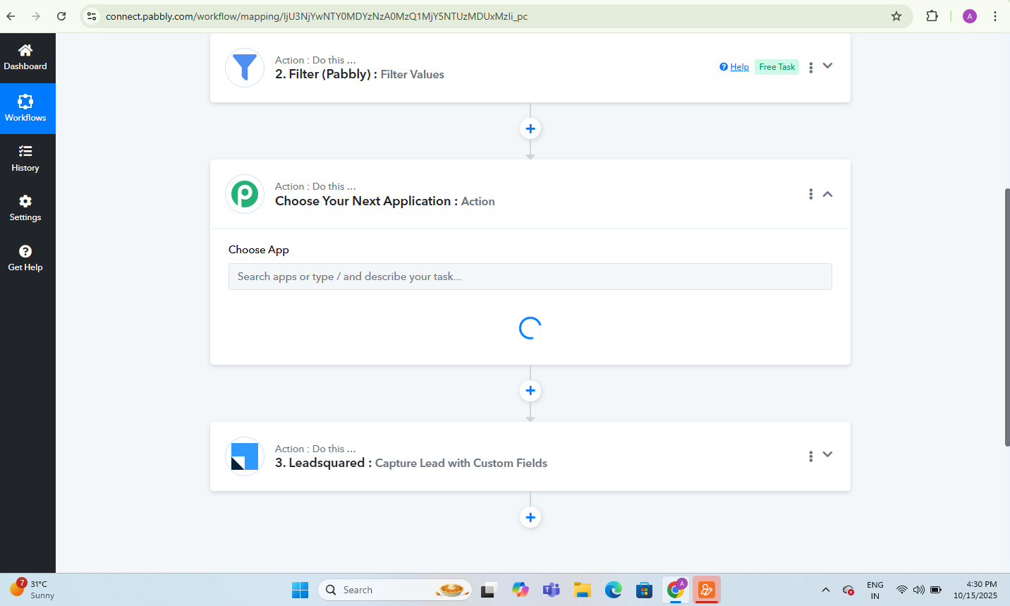

Hi Soumya,
I tried connecting the Router (Pabbly) and every time it displays that it is loading but does not open.
Is there any issue here?
Hello @Pmanifold,
If you’re trying to add a Router between the steps, please note that a router can only be added at the last step of the workflow. Any steps you want to add after the router should be placed under the respective routes.
Please try adding the router at the end of your workflow. If you still face the same issue, try clearing your browser cache and attempt again. Let us know how it goes.
