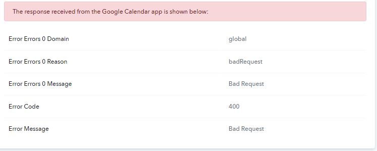

I have a connection created with PIPEFY in which I use the action "Get Card Info by ID" and use this information to create an event in Google Calendar, however, I am having some issues because on several occasions these events are not being created because when the workflow was created in Pabbly Connect, the selected fields were assigned by a numeric order instead of being unique fields.

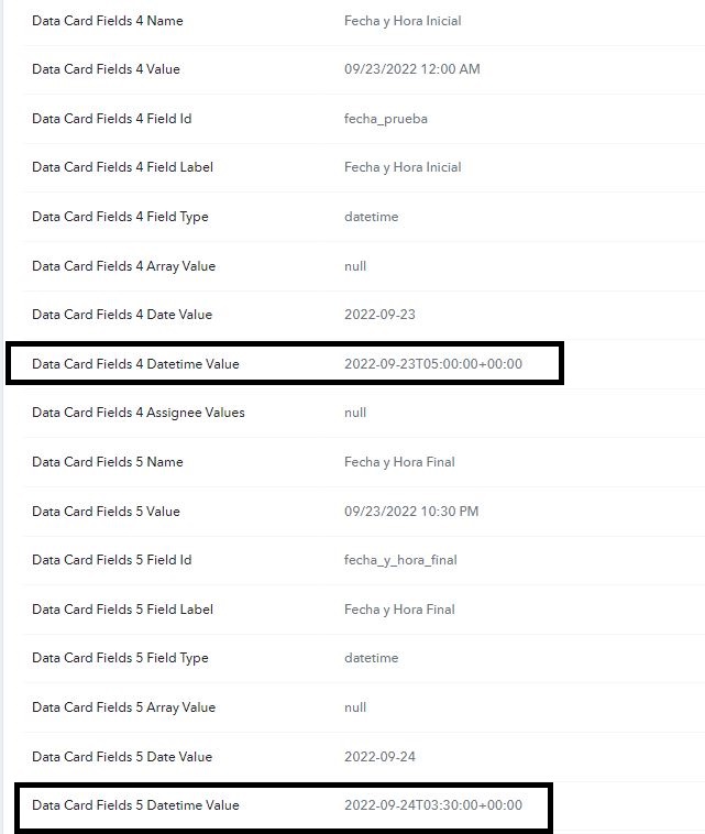

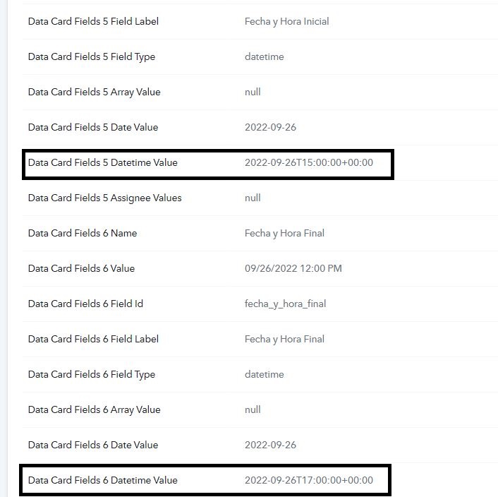

For example, when the workflow was created, if an initial date field was in position "Data Card Fields 5 Datetime Value", and at the moment that the Pipefy card information was filled, this field was created in position "Data Card Fields 4 Datetime Value", the event is not created in Google Calendar, as it is shown below:
Witouth error:
With error:

For your concern, we would suggest you use the router action step where you can create 1st route where you can process the date time coming 5 and 6 DateTime value and on the second route, you can process another date time coming 4 and 5 DateTime value.
