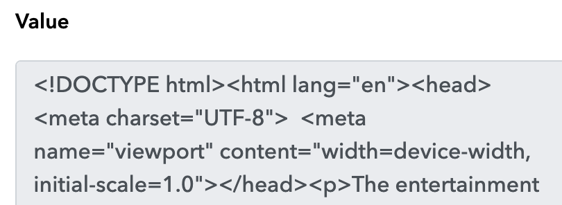

hi this is the output i am getting for rewritten content. it automatically adds the that code in header when i ask it to rewritter and split the output in h2 tags. i have tried changing prompt but this is the only output that i creating the content and formatting it nicely, the only issue is it adds this doctype code in header. if i ask it to provide without that code then it would add '''html in start which shows in published post and i dont want that too.
the workflow was publising the posts on wordpress even like this earlier which was fine for me. but now i noticed it is creating issue for that doctype code. and when i remove that then posts are publised again on wordpress.
could you please recommend or optimise my prompt so it generates the nicely formatted wordpress post with proper h2 tags.

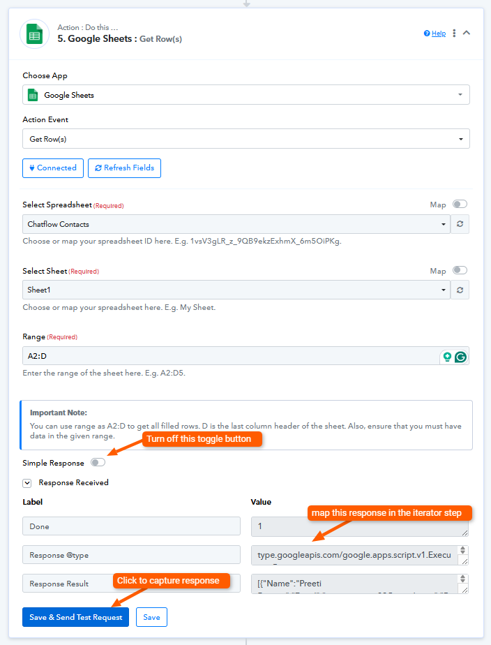

To achieve your new use case, you can set up the workflow as follows:
  1. Scheduler – Set it to run once (or as needed).
  2. Google Sheets: Get Rows (Advanced Format) – To fetch all rows.
  3. Iterator – To loop through each row.
  4. Filter – Check if the link column is empty (i.e., process only unprocessed rows).
  5. Delay – Add a delay step (you can configure the time as needed between each post).
  6. Content Rewriting Action – Use the tool or service you prefer for rewriting.
  7. WordPress: Create Post – To publish the rewritten content.
  8. Google Sheets: Update Row – To update the link column with the newly created post URL.

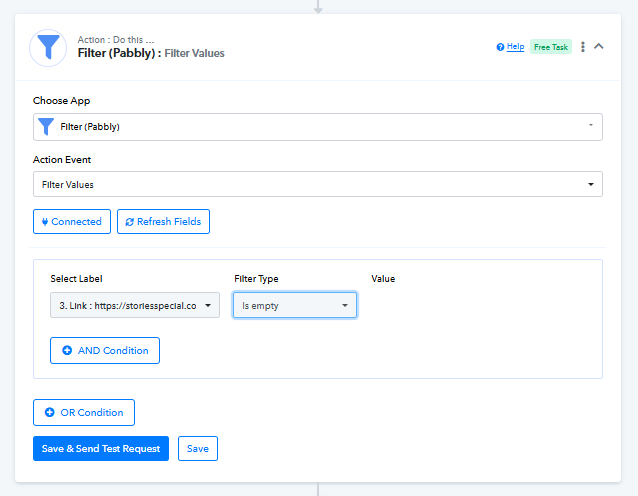

hi i setup iterator action. now how would i use filter action? i am not understanding which values to select there. as i selected advanced response in google sheet action so i am only getting the array data that is mapped in iterator but for filter action google sheet is not showing any data. that could be mapped in filter action.
do i add one more action to get rows of google sheet and map that data in filter? plus i need to know how to use filter action. so it detects if link column has any url added or is empty. it should work when the column is empty.
ok now i was able to setup this filter. now if the condition is false then the workflow will not proceed further after this? and when the workflow starts again at next scheduled time then it will start from 3 row now? as previously it worked in row 2 ?

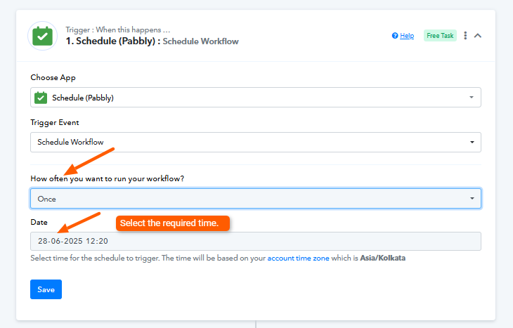

The scheduler you've configured runs at a specific time as expected. However, since we're using an Iterator in the workflow, it will loop through each row in the Google Sheet because we’re passing an array into it.
To align this with your use case, I recommend setting the scheduler to run only once, as shown in the attached image. Then, immediately after the Iterator, you can add a Delay step. For example, you can set a delay of 24 hours, so that each post is spaced one day apart.
This way:
  • If the first post goes out today at 10:00 AM,
  • The second post will go out tomorrow at 10:00 AM,
  • And so on...
This approach ensures that your posts are spaced correctly without needing the scheduler to run multiple times.

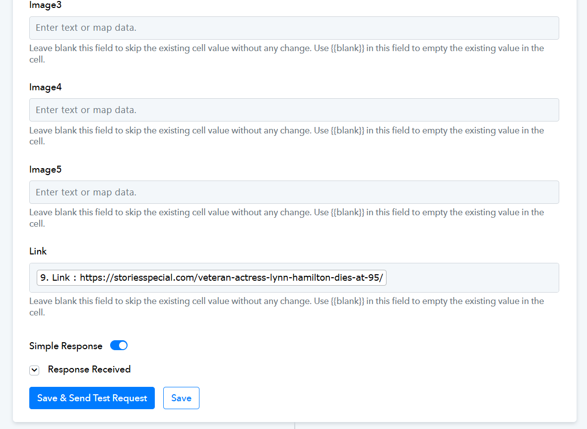

i am stuck on last step in this workflow. in last step i want the google sheet column "link" updated with post link for each row for which the content is being written.
ArshilAhmad
Moderator
The 'Google Sheets: Update Row' action step is already set up correctly for this use case. The post link will be added to the row for which the content is being written. Could you please elaborate a bit more on the exact issue you’re encountering?
