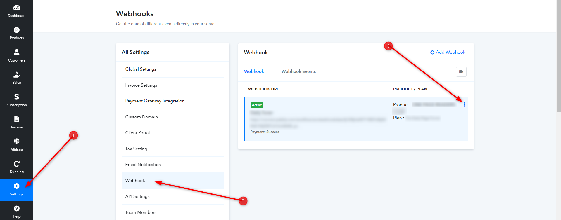

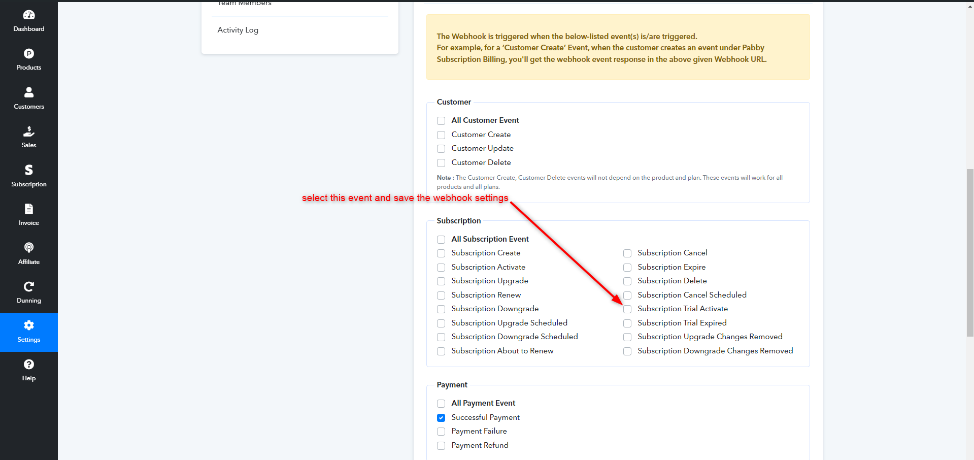

Hey @Mkmubashir
After investigating your concern, it seems that the webhook configured in Pabbly Subscription Billing is activated solely upon successful payments. We kindly request you to include an additional trigger event within the same webhook for "Subscription Trial Activation." This can be done by accessing your Pabbly Subscription Billing account and locating the webhook in the settings section. For detailed instructions, please consult the images provided below.
You can do some test entries to make sure the workflow executes for trial plans too.
Feel free to reach out to us again if you get stuck at any step.
