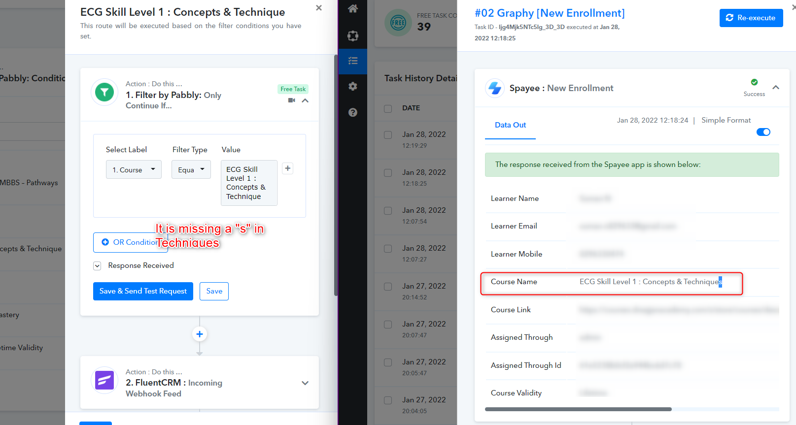

Work Group - Graphy/ Spayee Automation
Work Flow - #02 Graphy [New Enrollment]
Application used - Spayee =>Text Formatter by Pabbly => Number Formatter by Pabbly => Route => Filter => Fluent CRM
We have made automation and whenever a new person enroll for the course in Spayee App that data should move by using automation from Spayee To Fluent CRM and in between we have used some of the Pabbly Application also to make some changes in the data but the issue is this automation is not only working from beginning to end please verify and let us know in which step we went wrong.
Hey @quepreonpay
It seems like your router condition misses a letter "s" at the end of the word Technique which you have set in your router condition and because of that, the execution gets false in the execution.
Kindly correct it at your end and try again.
quepreonpay — Reply ·
Okay Thank you, But I think you have made it great because you have identified such a little mistake that we made.
Thank you so much sir next we will be careful at all points sir.
