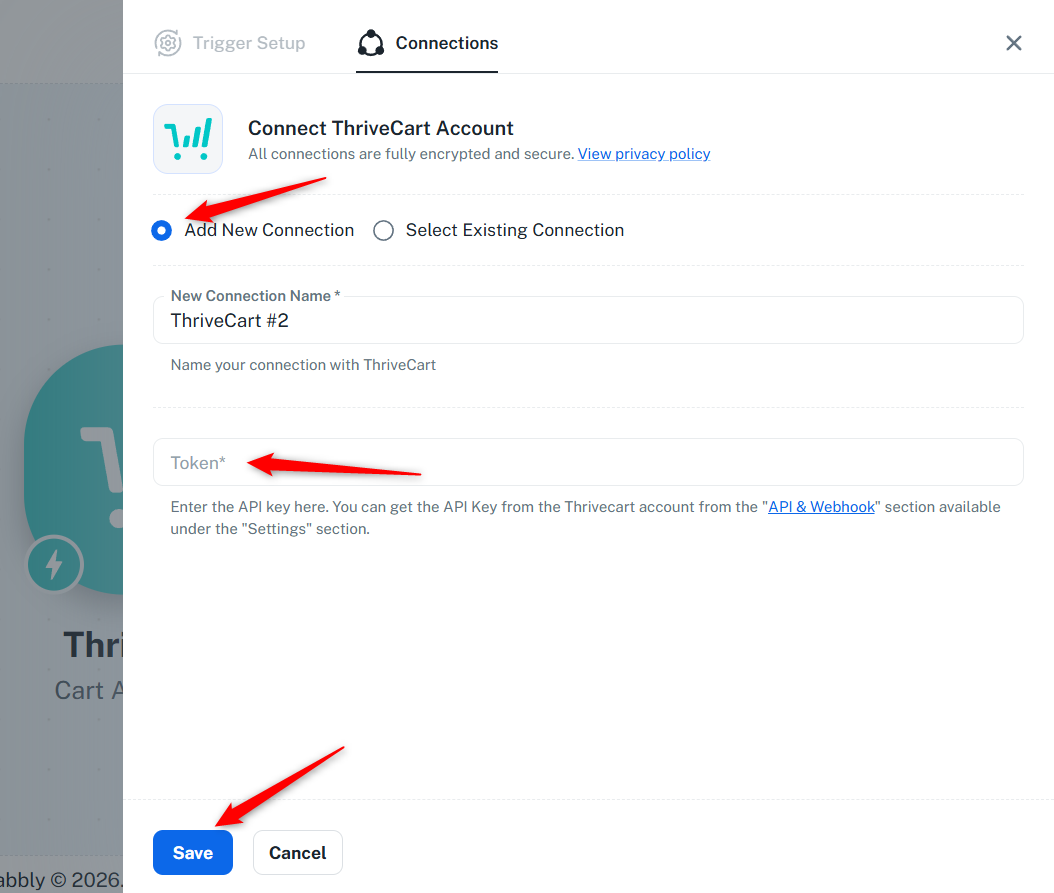

The issue appears to be related to your use of an old connection. Please establish a new connection with your ThriveCart account and let us know so we can attempt to set up the trigger step on your behalf.
