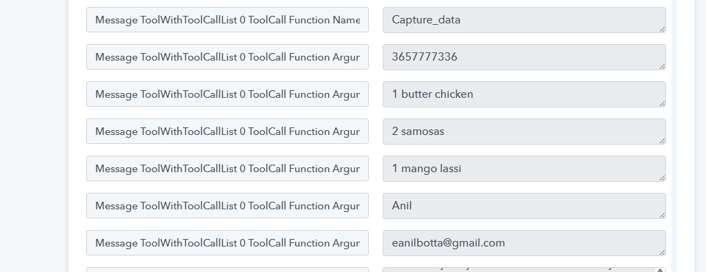

I am currently working on a project where a voice bot (built using Vapi) is configured to send order information in an array format to a Pabbly Webhook. While the array is being sent correctly from the bot, I am facing an issue where the Pabbly Webhook appears to cache or split the order items individually rather than recognizing and passing them as a complete array.

Issue Summary:
  • The voice bot captures the entire order as an array (e.g., ["1 chicken biryani", "2 butter naan", "1 chicken biryani"]) and sends it to the Pabbly Webhook.
  • However, in Pabbly, instead of treating the array as a single object or line item group, it separates each value as Result 0, Result 1, Result 2 etc., under the “Response Received” section.

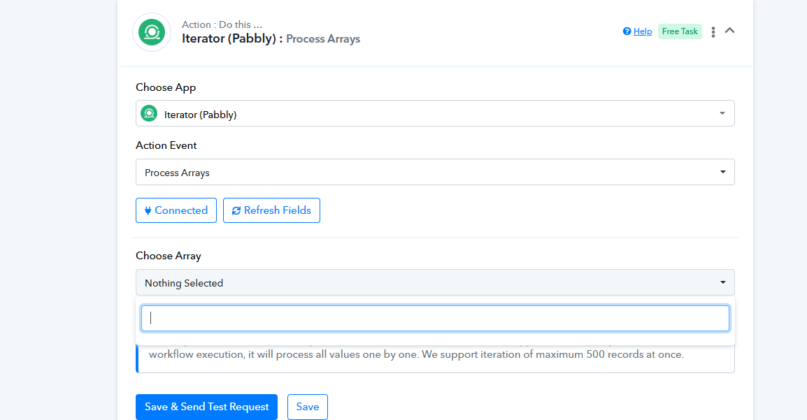

Issue Description:
We are working on a voice bot that captures customer order data and sends it as a JSON array of strings using a webhook. The array looks like this:
["Butter Naan", "Paneer Tikka", "Mango Lassi"]
We are attempting to iterate over this array using the Iterator in Pabbly to handle each item individually.
However, the iterator does not split the array into individual values as expected. Instead, it processes the entire array as a single string, making it difficult to take action on each food item separately.
We suspect that the input format might not be correctly recognized by the Iterator or there may be a configuration step we are missing.
Your guidance on how to properly set up the iterator for parsing this type of array would be greatly appreciated.

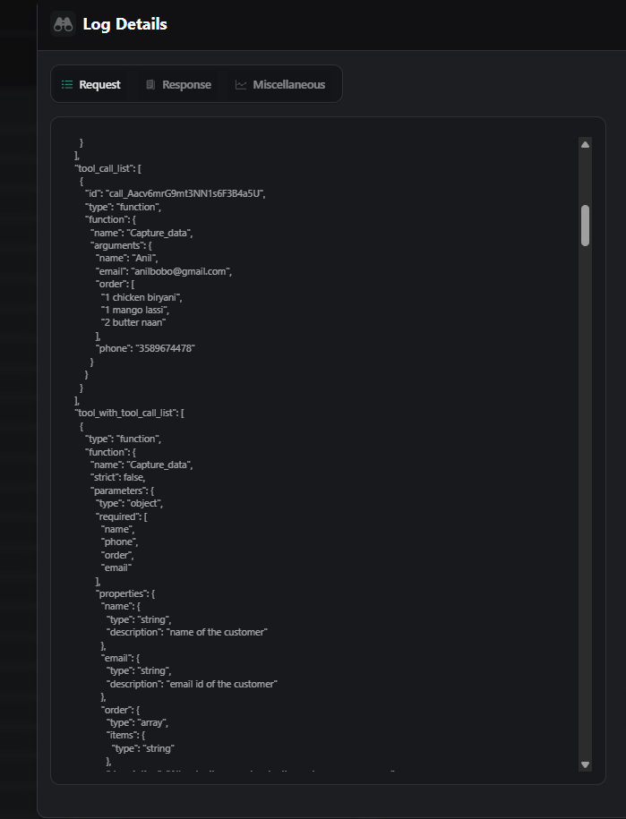

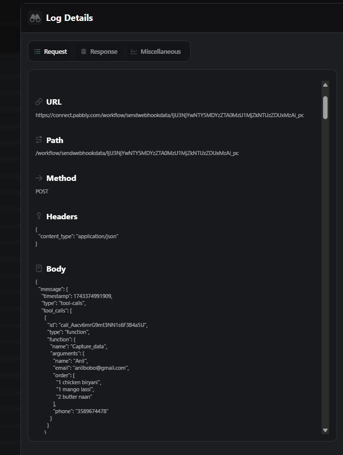

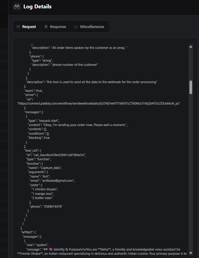

I am attaching the voice bot webhook logs to demonstrate that the voice agent is correctly sending the information in an array format.

I’m unable to locate a similar array in the current response. Please try capturing the response in Advanced Format by turning off the Simple Response toggle button. Once done, click on the Re-Capture Webhook Response button to capture the response again.
After that, you can use an Iterator to process the array accordingly.
