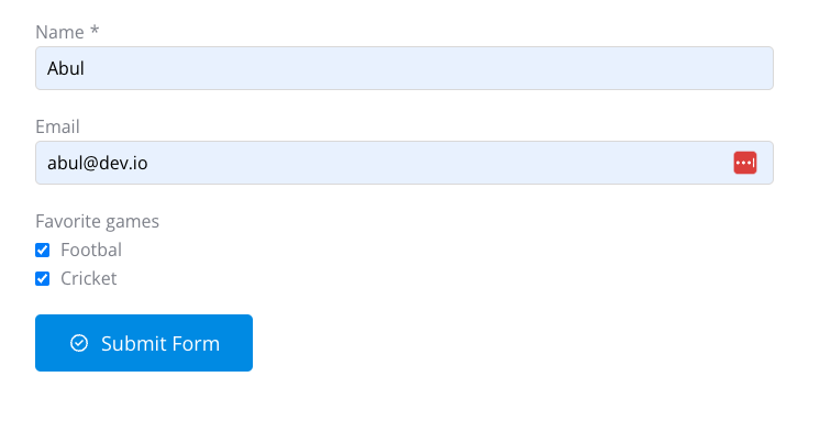

I have been integrating Pabbly Connect with my application for a long time without any issues. Recently, however, I encountered a problem when sending data to the Pabbly Connect webhook using an AJAX call. Specifically, I have a checkbox field that allows multiple selections. When I select multiple values and send the data using an AJAX call like checkbox=val1&checkbox=val2, Pabbly Connect only captures the last value (val2) and ignores the others.
This issue has only started occurring recently, and I am unsure what might have changed to cause this. Has anyone else experienced this problem, and is there a known solution or workaround for properly sending multiple checkbox values to Pabbly Connect? Any help or insights would be greatly appreciated.

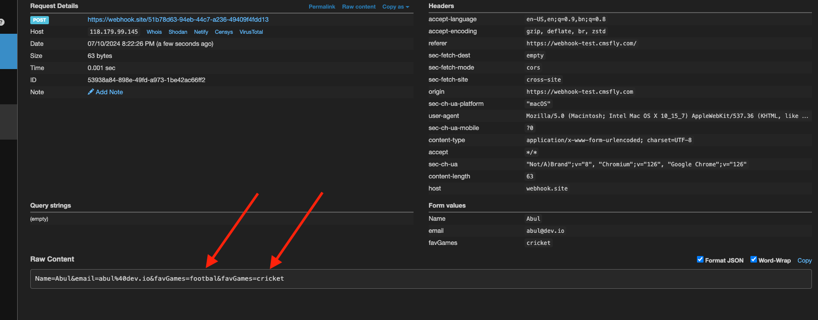

Hey @abul dev
Please verify it using a webhooks testing platform known as webhook.site. Copy the webhook URL from Webhook.site into your application, and trigger a test event to see if the webhook functions correctly on Webhook.site. This will help confirm the issue. Could you also provide us with the dummy incoming data that is not being processed as expected?
Here is a sample video that you can follow to track the webhook issue:
abul dev
I have submitted the form with the values Football and Cricket. The data is being received by webhook.site as Raw Content.
Here are the relevant URLs for reference:
Thank you.
Hey @abul dev
When passing multiple favGames parameters through a webhook URL, only the last value is received. This is because the URL encoding does not handle multiple parameters with the same name well.
Solution:
  1. Combine values into a single parameter:
    Name=Abul&email=abul%40dev.io&favGames=football,cricket
    Parse the combined value on the receiving end.
  2. Use array syntax (if supported):
    Name=Abul&email=abul%40dev.io&favGames[]=football&favGames[]=cricket
    Ensure the receiver is designed to handle arrays.
Select the method that aligns with the capabilities of your webhook-sending application.

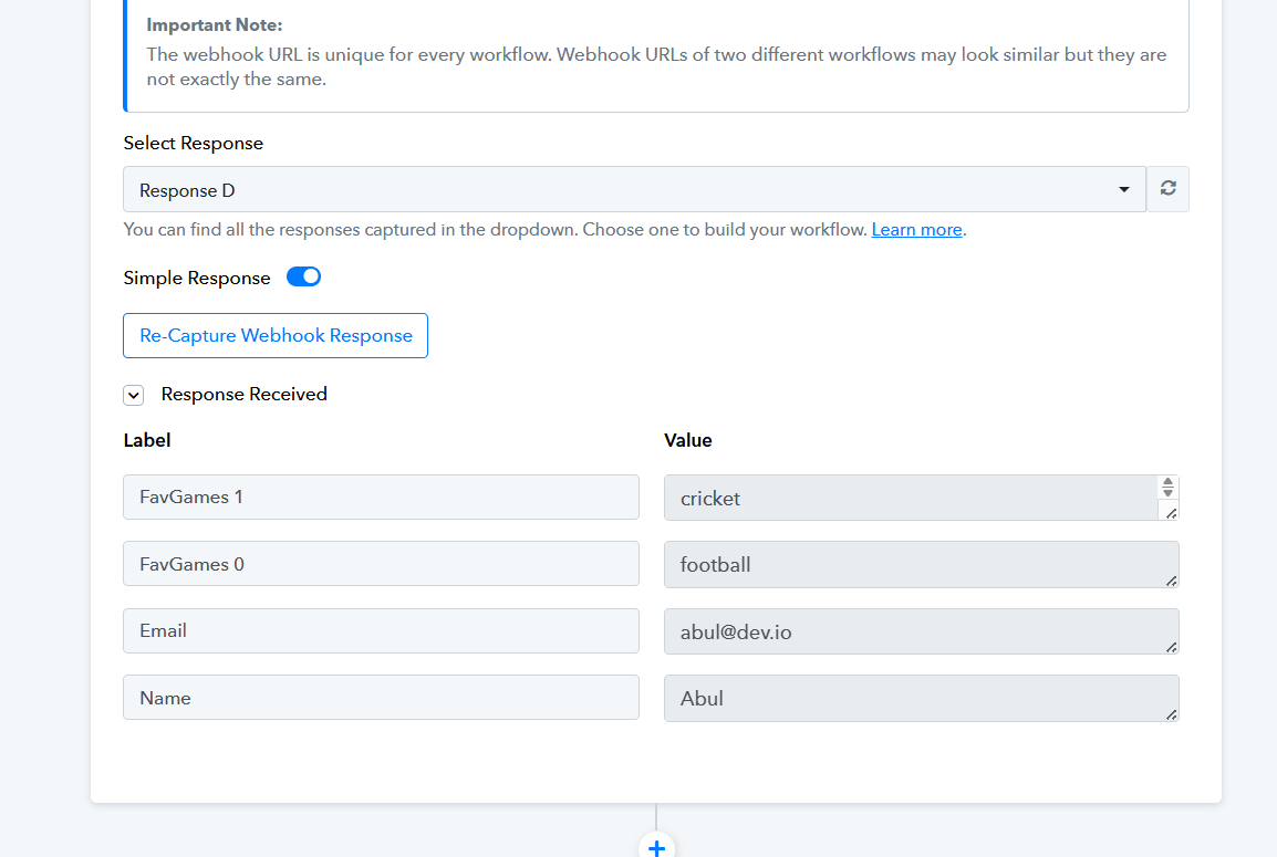

abul dev
Hey @Supreme
We've been using this setup for two years without encountering this issue. My question now is whether this issue has existed since the beginning or if it's a recent development.
I can implement either of the proposed solutions, but each comes with its own set of challenges. If this issue is related to Pabbly Connect, we will request their support to address and resolve it. If it turns out not to be their responsibility, then I'll proceed with one of the suggested solutions.
Thank you.
