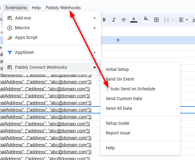

Hey @moriro3436
Can you please confirm if you have selected the Pabbly Connects ad ("Send On Event" or "Auto Send On Event").
While setting up the Google Sheets, if you are getting the data from the Google Application or you are feeding the data manually then you can only use "Send On Event" and if the data is coming from a third-party application then you might need to select "Auto Send On Schedule" and "Send on Schedule" which will take exactly 1 hr to forward it.
