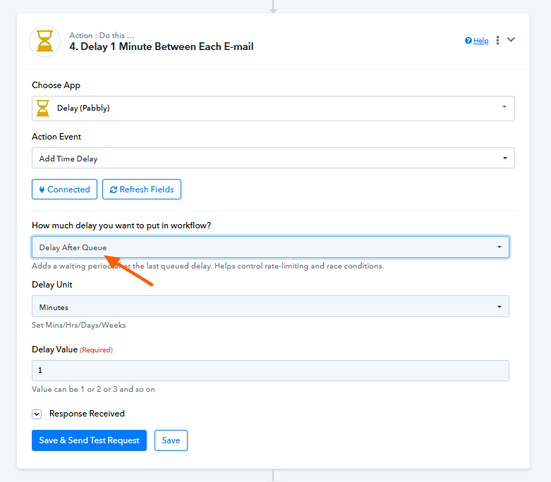

I've made a clone from the original workflow which I've used before & worked fine.
However, in this clone - my iterator isn't going through the entry one by one after 1 minute delay in-between. Instead, it bulk send everything & the Gmail account got rate limited. It has consumed my tasks as well.
What went wrong?
I also have another workflow that faced the same issue.
URL: https://connect.pabbly.com/workflow/mapping/IjU3NjcwNTZkMDYzMjA0MzI1MjZiNTUzNTUxMzIi_pc
Hello @HelpMeLearn,
Thanks for reaching out to us. Please try replacing the Delay For with Delay after queue and let us know if it helps.
HelpMeLearn — Reply ·
Hello @HelpMeLearn,

Thank you for your reply. It seemed to have worked.
I have another question. If I have a delay after queue running first, then another delay set for 16 hours after (it's meant to run in the same queue) - will it work?
Meaning, I have an iterator. It runs through my list & is set to delay after queue for 2 minutes each. Then, in the same workflow, I have a delay for 16 hours set that is meant to run within the same queue. Is my logic correct?
Example workflow: https://connect.pabbly.com/workflow/mapping/IjU3NjcwNTZjMDYzMDA0MzI1MjY4NTUzNjUxM2Ei_pc
Hi @HelpMeLearn,
Yes, your logic is correct.
For each iteration:
  1. It will first wait 2 minutes (Delay After Queue).
  2. Then the next steps will execute.
  3. When it reaches the 16-hour delay, that particular iteration will pause.
  4. After 16 hours, the remaining steps for that same iteration will continue.
This process will happen individually for each item in the iterator, so it should work exactly as per your intended setup.
Let us know if you notice any unexpected behavior.
