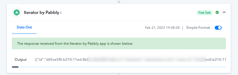

Hey @aoris
As we can see from your workflows tasks history Id, it appears that the action step is not getting the data label that should come from the Iterator action step.
So, please check your task history ID once whether you are getting the mapped data from the Iterator action step or not.
aoris — Reply ·
Well, the new workflow is working fine, so I guess that we can close the conversation. I must have introduced a glitch in the data selection or something at the time. Thanks for looking into the matter!
