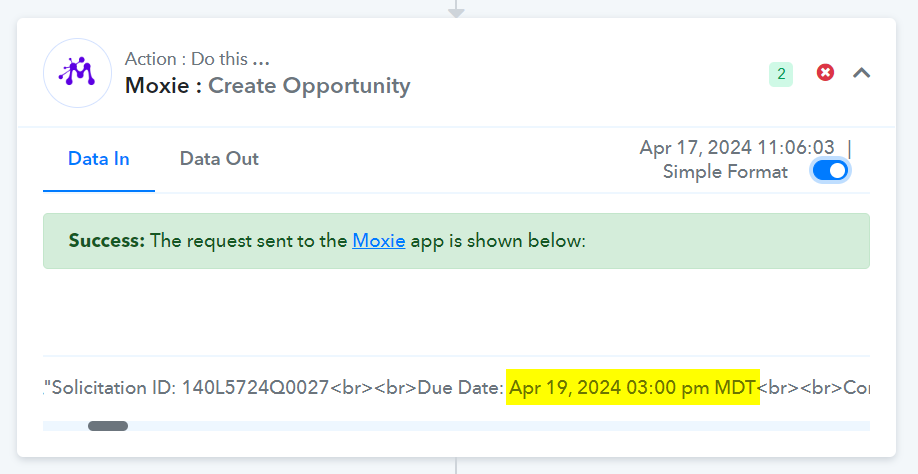

Hi @fisto,
Task History ID - IjU3NmMwNTZjMDYzZTA0MzM1MjY5NTUzZDUxMzI1MTY2NTQzNiI_3D_pc
It seems that you are not passing the Due Date in the correct format, which appears to be causing the issue you are encountering.

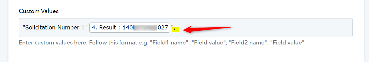

I have fixed the due date, but keep getting the "CTRL-CHAR, code 9" error in several of my workflows.
Here is an example task history URL: https://connect.pabbly.com/task/history?filter_status=applied&filter_by_workflow_id=IjU3NjUwNTY4MDYzMzA0MzM1MjZhNTUzMjUxMzYi_pc#
There was an unnecessary comma at the end in the Custom Values field. Removing that comma seems to have fixed your issue.
