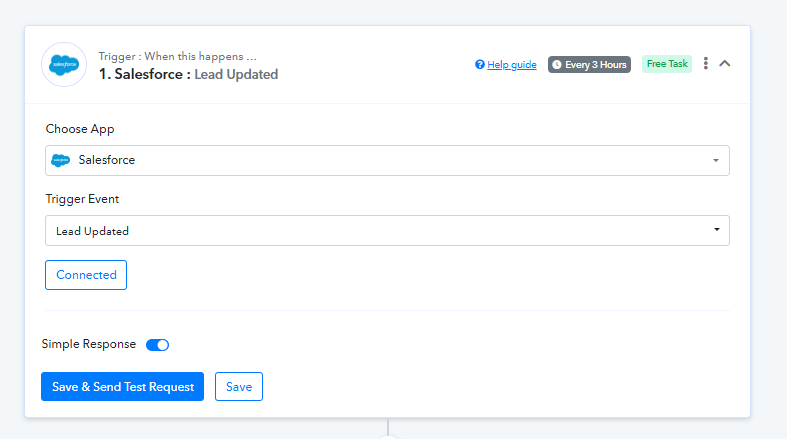

Hey @shaily
You can use the "Salesforce: Lead Updated" trigger event to fetch the updated leads.

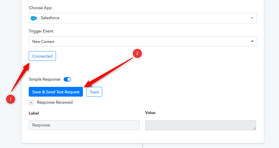

Pabbly is connecting to my Salesforce but when I click to the blue Save & Send Request button, no value comes back. ( see attachment)
Thanks, JJK
Hey @JJK
Can you check your connection for Salesforce once and then try again? Also, do create a new dummy contact in your account once.
