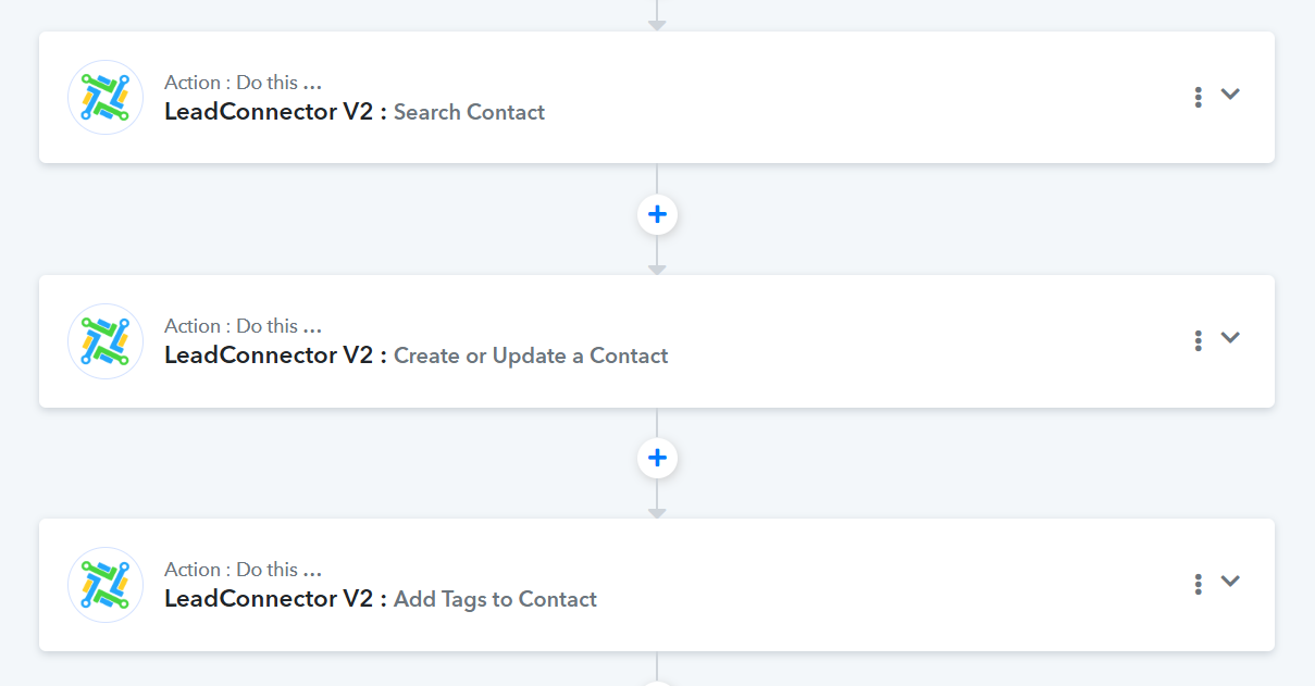

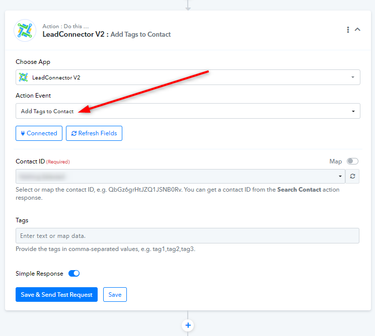

Hey @Clement
We would recommend you to use "Add Tag to Contact" action step for this use case. Instead of removing the existing tags and adding the new one, this action step will append the new tag with the previously existing ones.
Thanks for this - suggestions on how I can have an automation that searches contact, creates one IF they do not exist, and then does 'add tag?' Thank you :)
@Donkeytron, Use the 'Search Contact', 'Create or Update a Contact', and 'Add Tags to Contact' action steps together to achieve your use case. The 'Search Contact' action step will search for a contact using their email address. Then, the 'Create or Update a Contact' action step will either create a new contact if it doesn't already exist or update the same contact if it does exist. Finally, the 'Add Tags to Contact' action step will add tags to those contacts.
