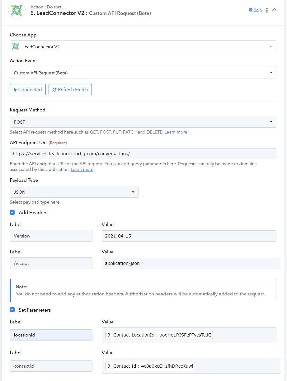

I am trying to use the Custom API action with the LeadConnecter V2.
I am trying to create a conversation via the API as per the documentation here - https://highlevel.stoplight.io/docs/integrations/8d0b19e09176e-create-conversation
Error Received: 401 Error The token is not authorized for this scope.
Do we have the conversations.write scope enabled/passed in the auth request?

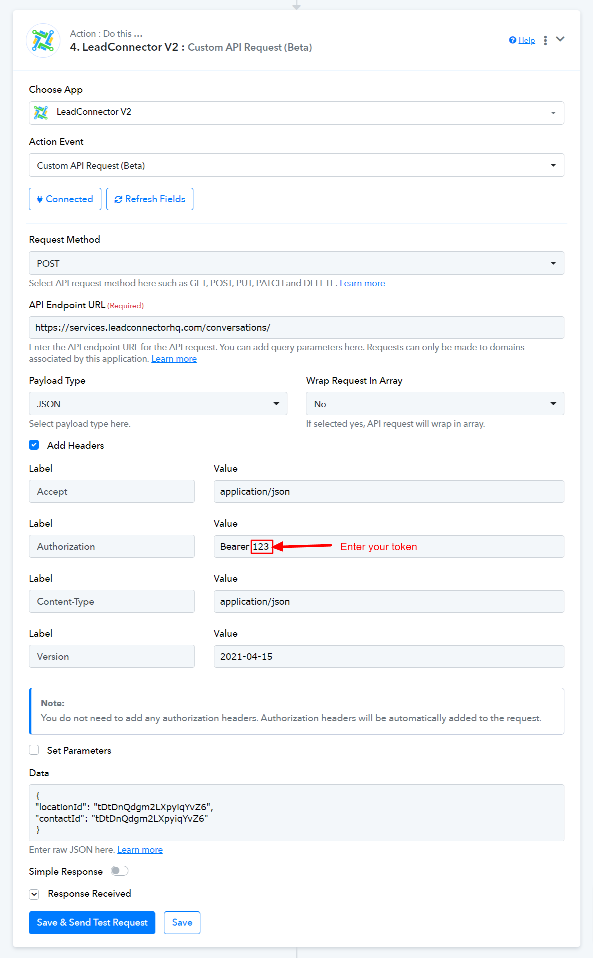

Hi @Kri8itDigital,
Please try setting up the endpoint in this manner and see if that fixes your issue.

Hi @Kri8itDigital,
The token is created by the LeadConnector V2 connection from Pabbly. How can we access this token?
Can you please share the workflow URL once in which you have tried the same so that we can look into it?
Also please refer to the following short recorded video on how you can get the API token from your GHL(LeadConnector) account.
https://www.screenpresso.com/=FjWtf

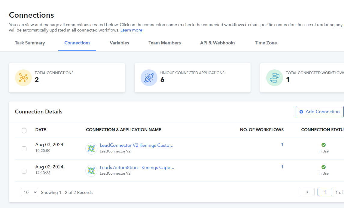

With regards to the API key - I don't know if that will work as the API has updated to work with the OAuth flow when connecting the action listed under Connections.
The token required would be from that connection and not the standard API key on the account.

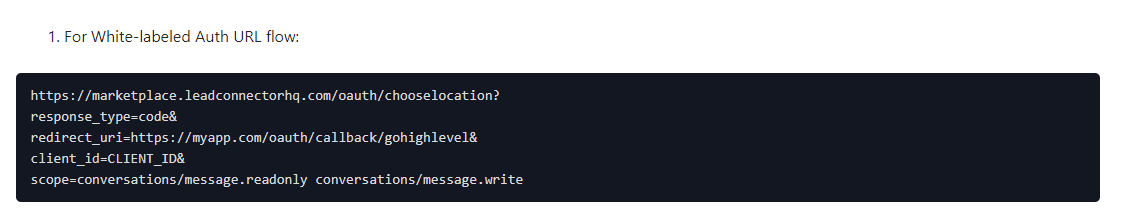

When creating the OAuth connection to LeadConnector the URL generated to grant the access contains the scopes that will be enabled. So the url has a parameter called "&scope=" with a space separated list of scopes as below.
The current list of scopes in the Pabbly integration are:
&scope=conversations/message.readonly%20conversations/message.write%20campaigns.readonly%20locations/customFields.readonly%20locations/customFields.write%20contacts.readonly%20contacts.write%20opportunities.readonly%20opportunities.write%20users.readonly%20users.write%20locations.readonly%20locations.write%20locations/tasks.readonly%20workflows.readonly%20businesses.write%20businesses.readonly%20calendars.readonly%20calendars/events.write%20locations/templates.readonly%20locations/customValues.readonly%20locations/customValues.write%20funnels/redirect.write
We are missing "conversations.write%20conversations.readonly%20"

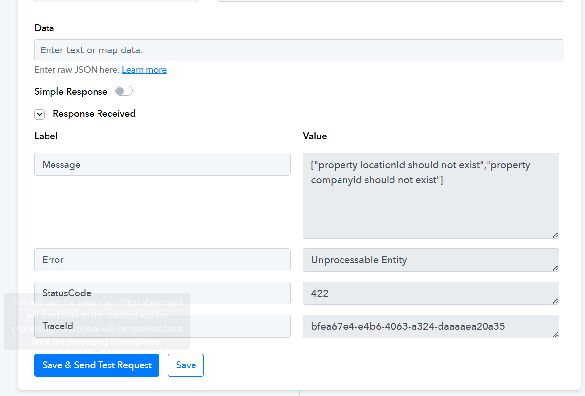

Did this reach a resolution? The current list of scopes should also contain 'calendar/events.read' but it's missing.
Overriding the authorised scopes list when configuring the connection allows the token scope to change but the 'Custom API Request' is sending erroneous properties.
My guess is these scopes are intentionally left out by Pabbly as their integration is yet to support them.
