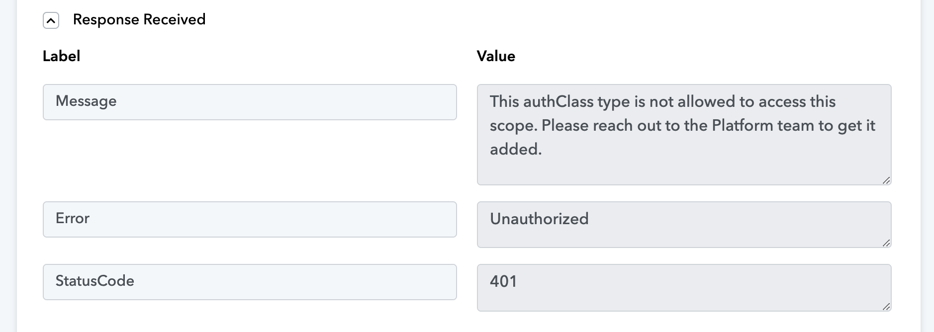

I've authenticated myself and added Pabbly to our Agency account with connect to all sub-account, with connect to all future sub-account too and wanted to setup a workflow to update Custom Values in locations but the response that I received back during testing says:
Message: "This authClass type is not allowed to access this scope. Please reach out to the Platform team to get it added."
Error: "Unauthorized"
StatusCode: "401"
I've checked it, it is working if I setup the connection to a specific Sub-account when authenticating Pabbly app. But, if I chose the Agency account, then chose give access to all existing sub-account and all future sub-accounts, the request fails.

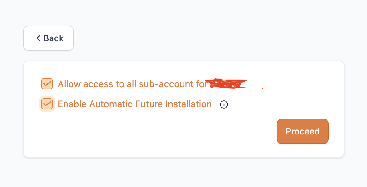

I'm confused a bit, then what is the purpose of the below settings. I mean isn't this should install Pabbly to all of my sub-accounts and all future sub-accounts. So, in my understanding with the install this should generate access tokens for all sub-account where the app was installed or am I misunderstand something? Could you give me a use-case when the below settings can be used? Also, is my use-case can be achieved by using the "Custom API Request (beta)" action event, or it doesn't matter because I have to authenticate the sub-accounts on a request basis?

[IMG width="354px" alt="1718716989122.png"]https://forum.pabbly.com/attachments/1718716989122-png.43535/[/IMG]

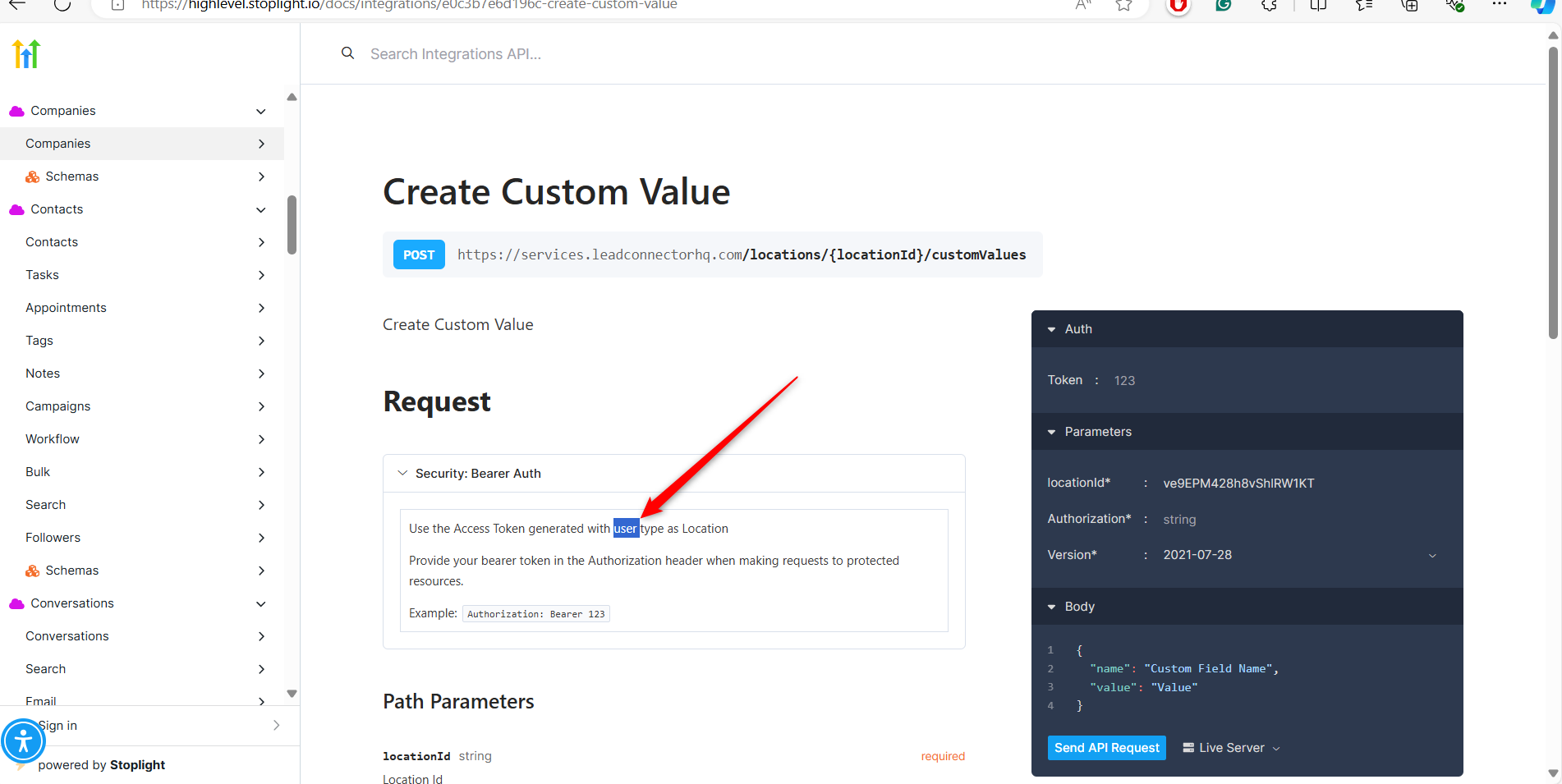

We have verified with the Agency account on LeadConnector, and the API does not permit the creation of new values therefore, you must use the Sub-account exclusively. Additionally, even if you utilize the Custom API request, it will only access the Sub-account as mentioned in the API documentation.
We recommend you contact the LeadConnector support team related to the same.

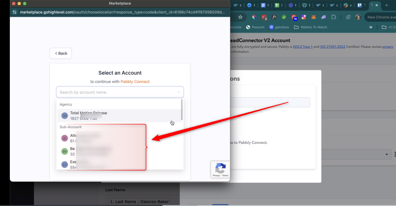

hi Cpt_noriss - Norbert, were you able to resolve this issue? Unfortunately GHL support is not helpful. We're trying to automate using Leadconnector V2 APIs without manually authenticating everytime there's a new sub account. I thought this feature will work but i dont have any success at all or maybe I'm missing something. Thanks! --Salm

we want to automate creating of calendars in GHL using lead connector v2 for new sub account/location. Currently we have to manually connect to that sub account to make it work , if we use agency level connection, we're getting 401 scope error.
Hello @SalM
Unfortunately, your use case does not appear to be achievable at the moment. The trigger you mentioned, "sub-account created", would require establishing a connection with the newly created sub-account to create a location within it. However, we currently do not have any functionality to create such connections within the automation.
