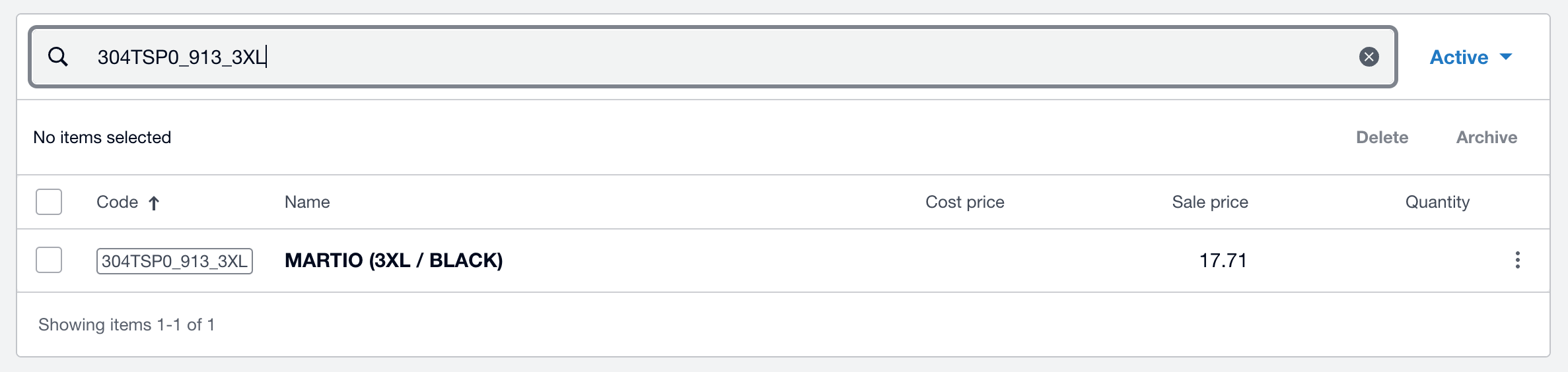

I've now setup line itemizer but I am getting a huge amount of validation errors when I try to pass this data into Xero.

Could you please check whether the Line Item codes of the product which you are passing from Shopify are exactly present in your Xero or not?
