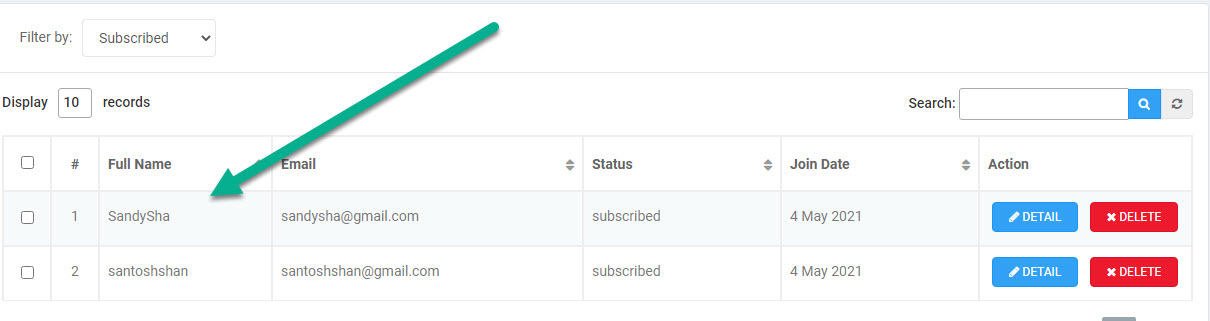

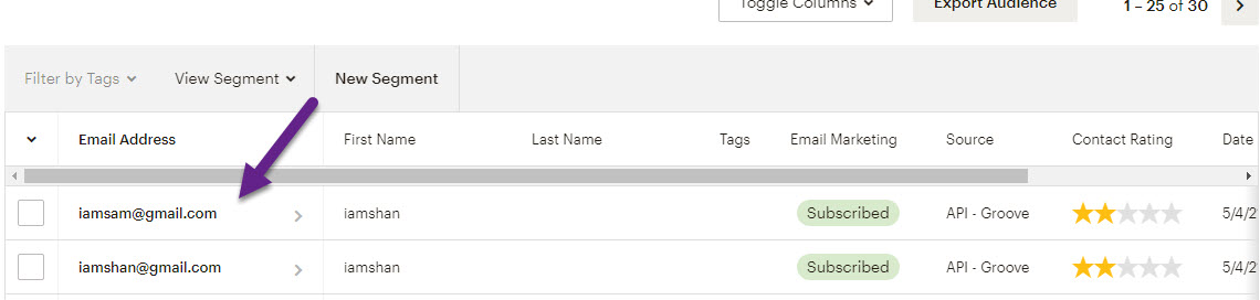

As you can clearly see in the image below, the subscriber is added to my Mailchimp audience list using Groove API but the same audience is not adding up in the kirim audience list. Checked my workflow as well. It seems to have no error. Does that take a longer time to add the subscriber?
Audience shows In the second screenshot is added up manually while capturing response using Pabbly. But actual subscriber is not adding u.

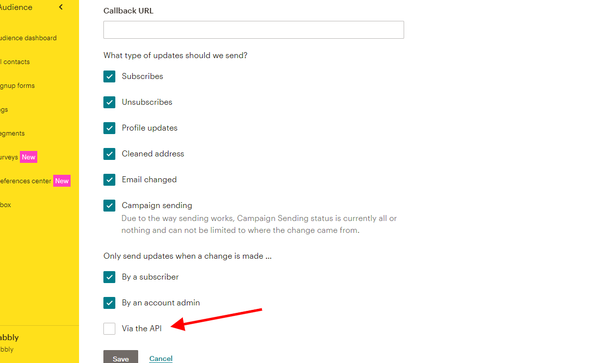

Can you confirm if you have selected the API as well while setting up the webhooks? If not, then please select it, and capture the webhook response again.
