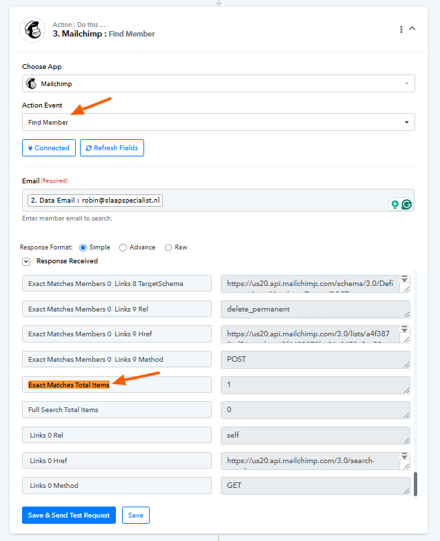

Hey @nibz,
Thank you for reaching out.
To avoid this issue, you can first check whether the subscriber already exists in Mailchimp before adding them.
Here’s how you can do it:
  1. Add the “Find Member” action in Mailchimp and search using the email address
  2. This action will return a field called “Exact Matches Total Items”, which indicates how many matching records were found
  3. Add a Filter step right after this action
  4. Set the condition as:
    • Exact Matches Total Items = 0
With this setup:
  • If the value is 0 → the user does not exist → the Add Member action will run
  • If the value is greater than 0 → the user already exists → the workflow will skip adding them
This will help you avoid duplicate subscriber errors.
Let us know if you need help setting this up.
