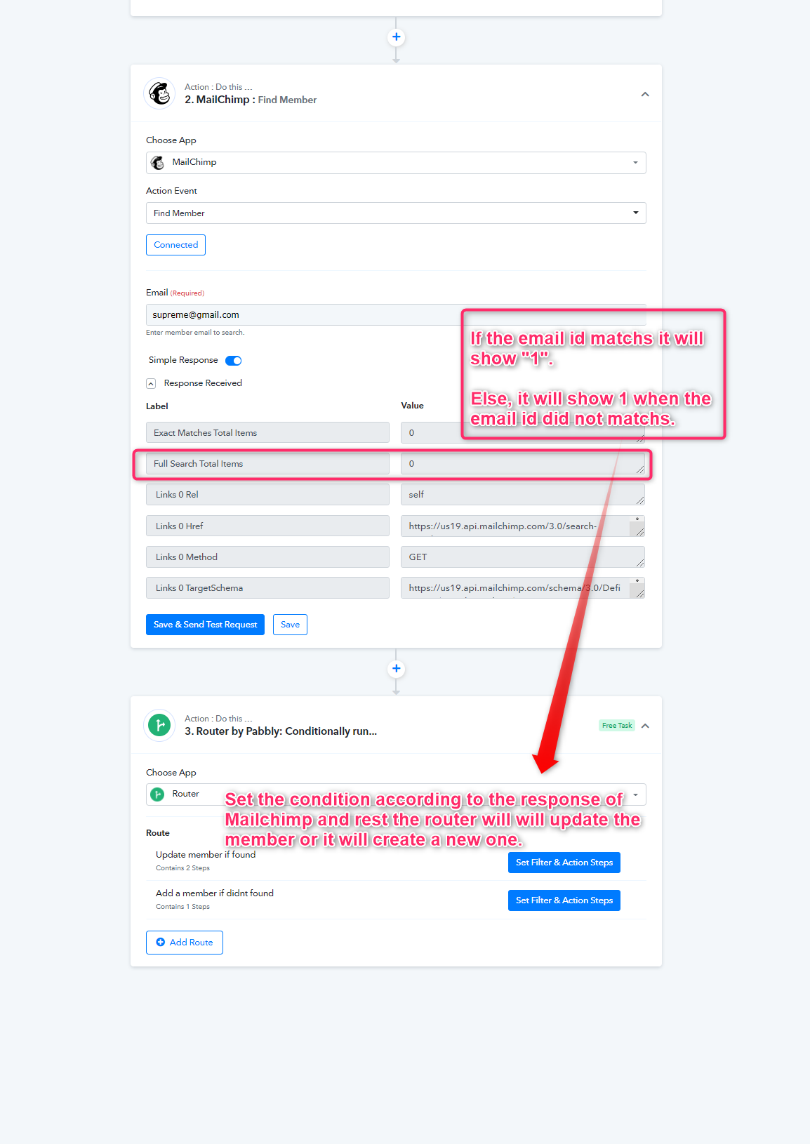

Add/Update member task in Zapier - this appears to be 2 different tasks in Pabbly. If I use Add New Member in Pabbly, will the action just fail if the person is already a member? If I use Update Member, it is wanting me to select a specific member. I need to update the person based on whatever source I am using.
Yes, in Pabbly as of now we have 2 separate endpoints to Add/Update a Member. But you can manage the work with the help of Router Conditions where you can establish the condition on the presence of Mailchimp's Members.
Please check out the following screenshot for a better understanding
Respective workflow - https://connect.pabbly.com/workflow/share/CkJTYVUSBi4ASQlzVDlTN1hMAyoHTQFXB2ABEw##

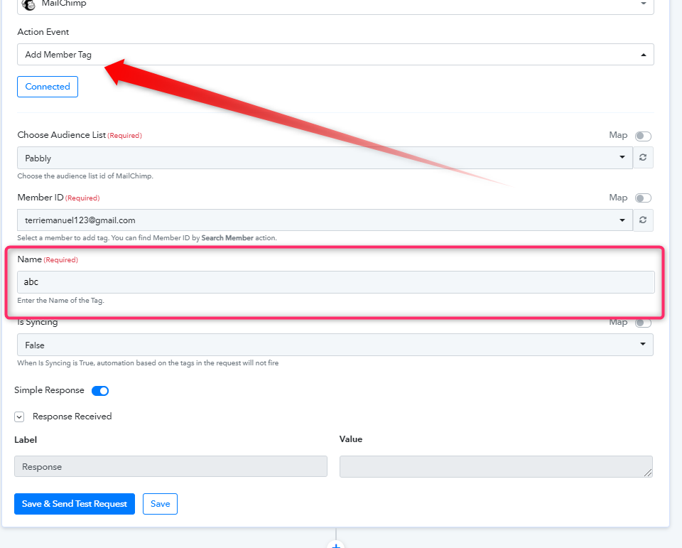

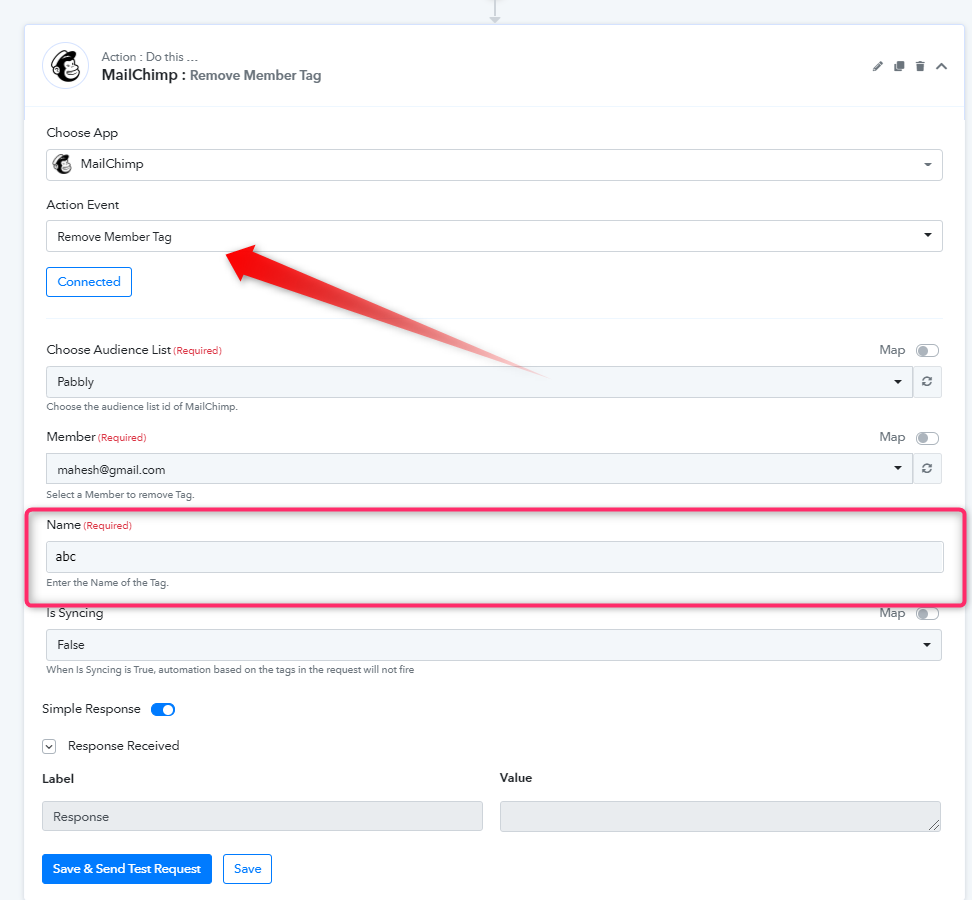

You can add or remove a member tag in MailChimp to a member -

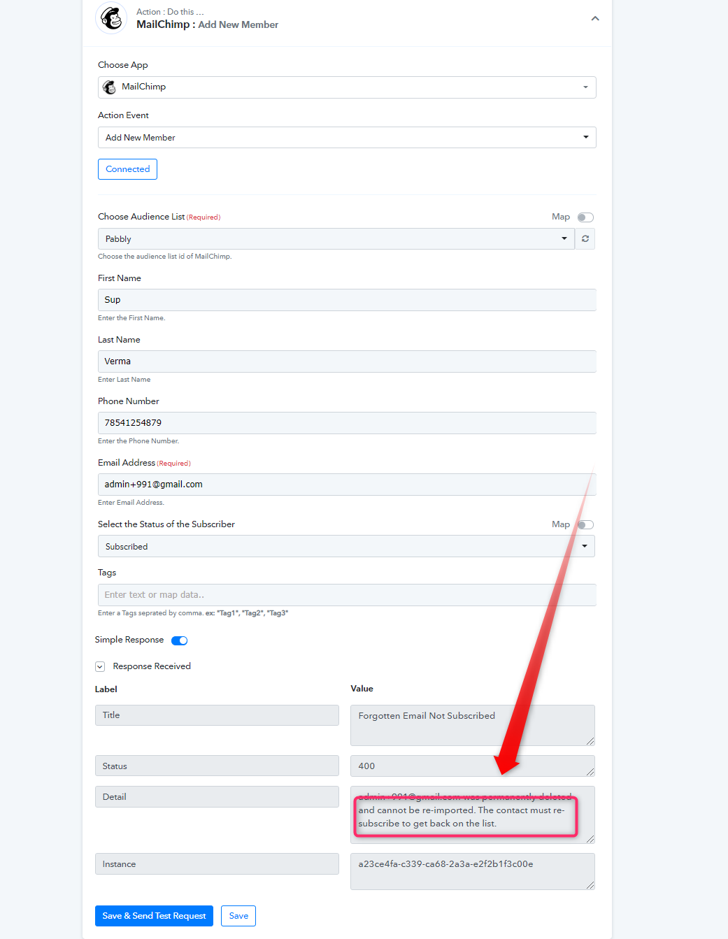

And if you are using Add New Member and the member already exists the response would be like this
