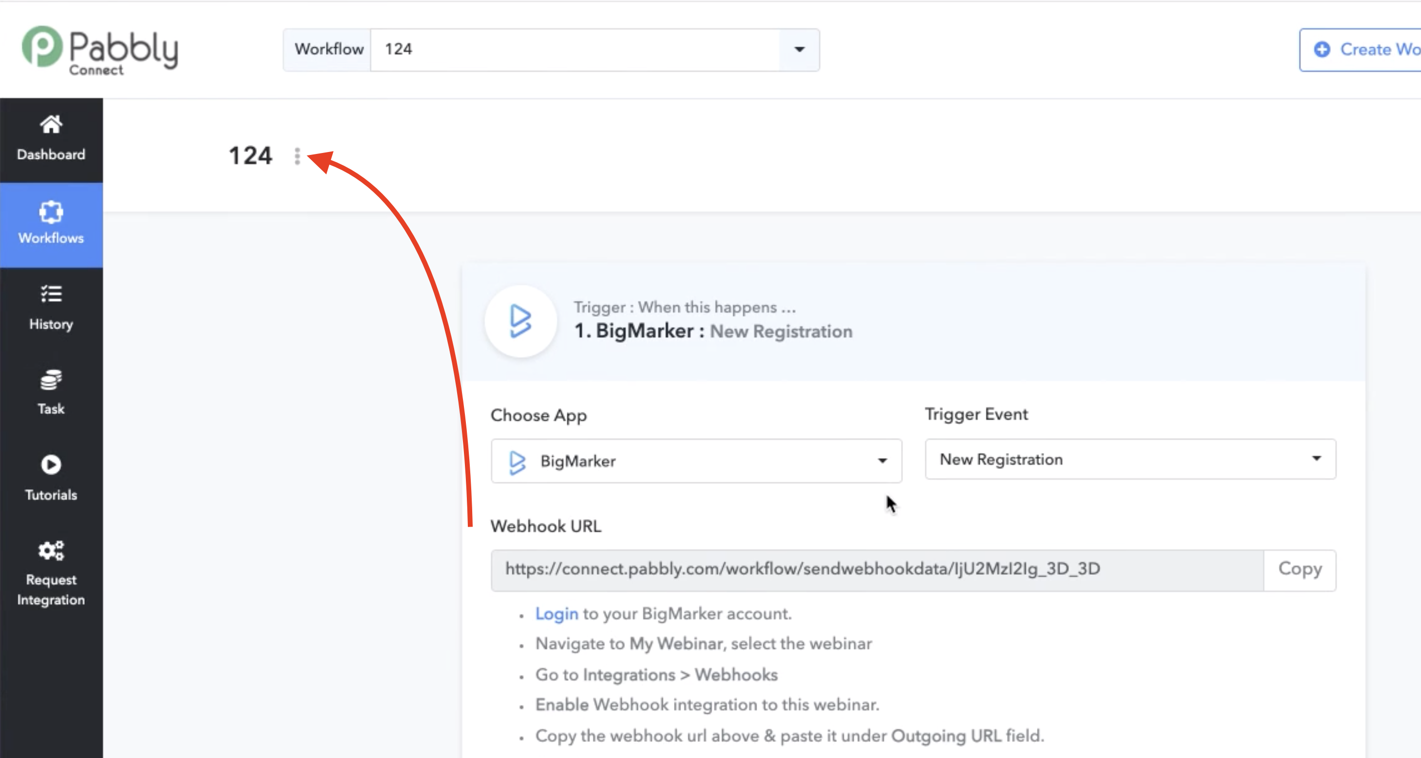

I double checked....
Actually, no matter what app I choose, I Always get the same webhook...
https://share.sendspark.com/view/5xosovddfu7y2cjd
Whats going on?

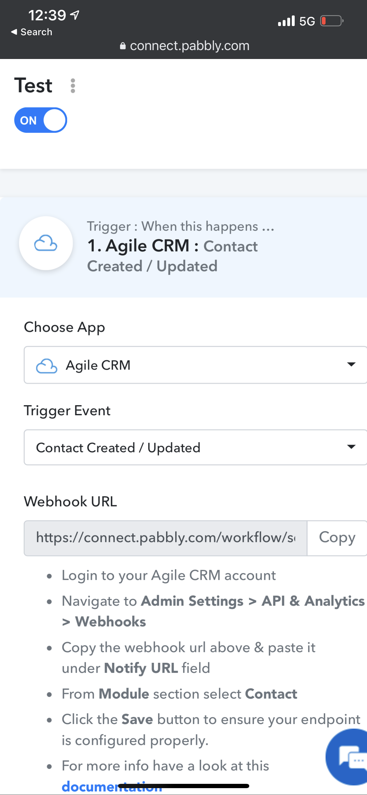

i just tried creating a flow now, from my phone.
It is the SAME webhook for ANY trigger
See, different applications which are webhook based triggers then, the URL will be same because, you will have to use one app at a time in trigger. But if you check same webhook based app in trigger module of another workflow, you will see different URL.

Is this normal?https://share.sendspark.com/view/cci4spci74qlwtmz
Yes/No
Yes, all the webhook based apps for this workflow 124 will be same.
Naveen
It is the same webhook if I creat ANY NEW workflows....
What do you mean workflow 124?
Naveen
It is the same webhook if I creat ANY NEW workflows....What do you mean workflow 124?
