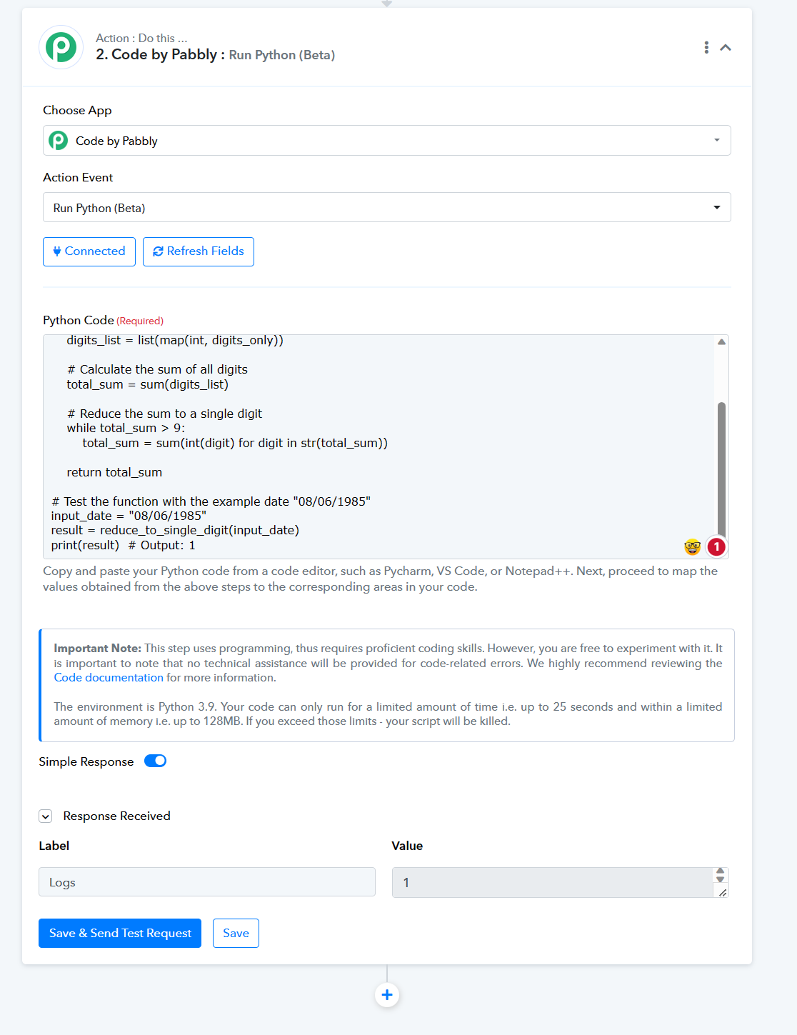

Hey @Nitai Chand
Regarding your concern, you can use the Code action step with Python language where you can perform the same calculation accordingly.
Please refer to the following screenshot for a better understanding.
def reduce_to_single_digit(date_str): # Remove any non-numeric characters from the date string digits_only = ''.join(filter(str.isdigit, date_str)) # Convert the string to a list of digits digits_list = list(map(int, digits_only)) # Calculate the sum of all digits total_sum = sum(digits_list) # Reduce the sum to a single digit while total_sum > 9: total_sum = sum(int(digit) for digit in str(total_sum)) return total_sum # Test the function with the example date "08/06/1985" input_date = "08/06/1985" result = reduce_to_single_digit(input_date) print(result) # Output: 1
