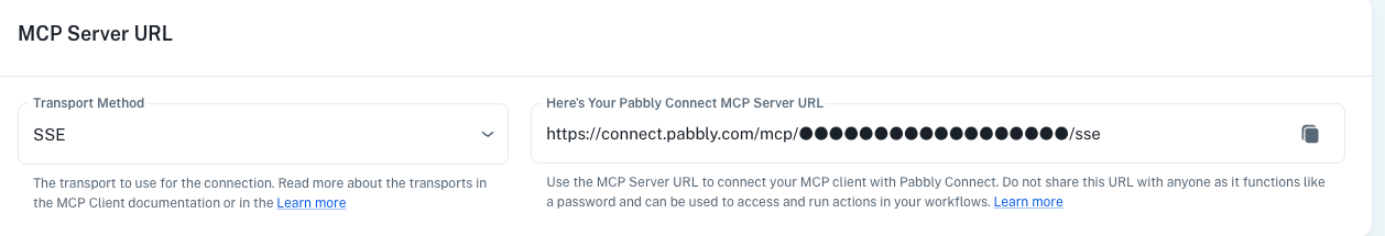

I have reason to believe the transport method is also an issue. I change the method to https but it doesn't save. With each refresh it still appears as SSE. Please advise.

Hi @unbleachedmuslin,
Thank you for your patience.
We’ve received an update from our team regarding this behavior. The transport method selection (SSE / Streamable HTTP) is currently not persisted, which means it will reset (default to SSE) upon page refresh.
This is expected behavior at the moment. The dropdown is primarily provided to help you copy the corresponding MCP Server URL based on the selected transport method, and it does not impact the underlying functionality.
If you select a transport method and copy the URL, it will work correctly for that specific option—even if the UI resets afterward.
Please let us know if you need any further clarification.
