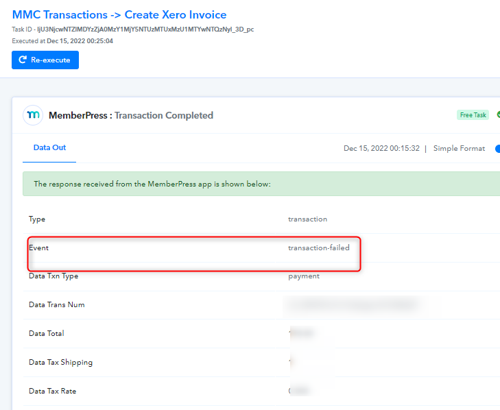

Hi there - I'm new to Pabbly so this could absolutely be user error but I've created a workflow to be triggered when a transaction is completed in Memberpress that creates an invoice in Xero. It is triggering multiple times, despite the fact that the only transaction completed today is the test transaction I created.
Can anyone help to troubleshoot this?

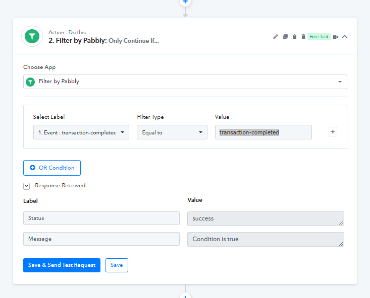

It appears that you might have selected multiple trigger events in your Memberpress or Memberpress is sending the data with multiple trigger events.
So, as a solution, we would recommend you use the Filter action step after the trigger event with "transaction-completed", which will only process the data which has the "transaction-completed".

Hi - it looks like this has already been done but is there a trigger that ONLY fires when a payment is made? It looks like this trigger of “Memberpress: Transaction Completed” is firing for many different things - even when someone just logs in.
We can stop it creating invoices by using a filter, but it’s going to be really hard to troubleshoot issues with payments with so many different transactions going through.
For that, we have already suggested you use the Filter action step as mentioned above which will process the transaction accordingly.

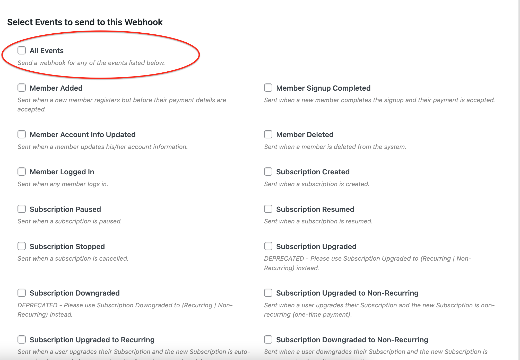

For anyone else reading this thread later, here's what I was doing wrong. I didn't realise that when you set up your webhook for Memberpress you need a separate webhook for each event you want to track. I had All Events checked so make sure you have only the one event checked per webhook.
