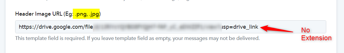

The issue seems to be related to the URL you are sending in the message not having an extension at the end. Please try using a URL that ends with a proper extension and see if that fixes your issue.

Thanks for looking into this. I have modified a link to a dropbox link: https://www.dropbox.com/scl/fi/z9t2jpfr2ezljuklcdnd6/Furnished_Flat_8x11.png
It still does not work. I got a test hello world message to which I responded and went back to change to a templated approved message and sent it. Pabbly show that message was accepted, but I don't receive the templated message on my whatsapp.
Please use the publicly accessible file to obtain the file ID required for the Dropbox action step to upload the file. The URL you have created does not provide a direct download link, making it neither accessible nor downloadable.
The dropbox link I had provided is a publicly accessible file with permission to have any one with link access the contents.
I have created another template with out the header. It consists of text. I was able to successfully send it and receive the message. I want the message to be sent out with a flyer. If someone can assist on how I can send a templated message with a header that has a link to the image, it would be greatly appreciated.
I have uploaded my image to a different site and it is now working as expected. Thanks again for all your help.
