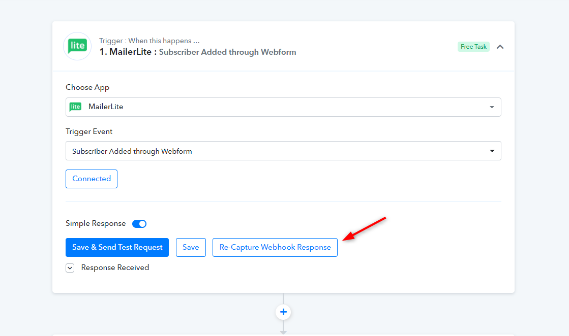

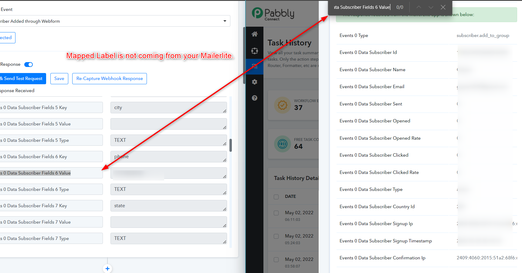

Hey @Anamitra
Seems like you might have done some changes in your MailerLite form and because of that, your Phone Number field is not coming at the right label which you have mapped previously.
Kindly re-capture the webhook response and try again.

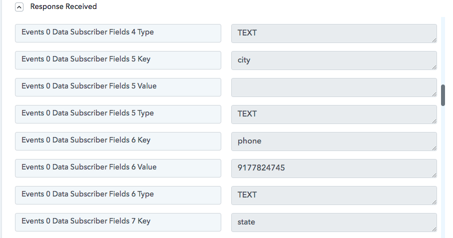

See when I am testing manually, the No is coming from Mailerlite. But Automatically its not coming. Can You pls call me 9177824745
Hey @Anamitra
Again the cause of the issue is still the same since you made some changes in your Form the fields sending the data in different labels now.
So, as a solution, we would recommend you to re-capture the webhook response again and map the respective action event accordingly.
