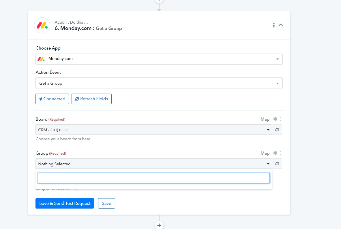

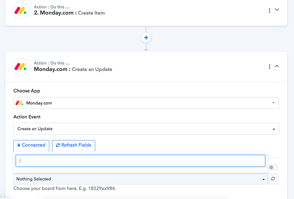

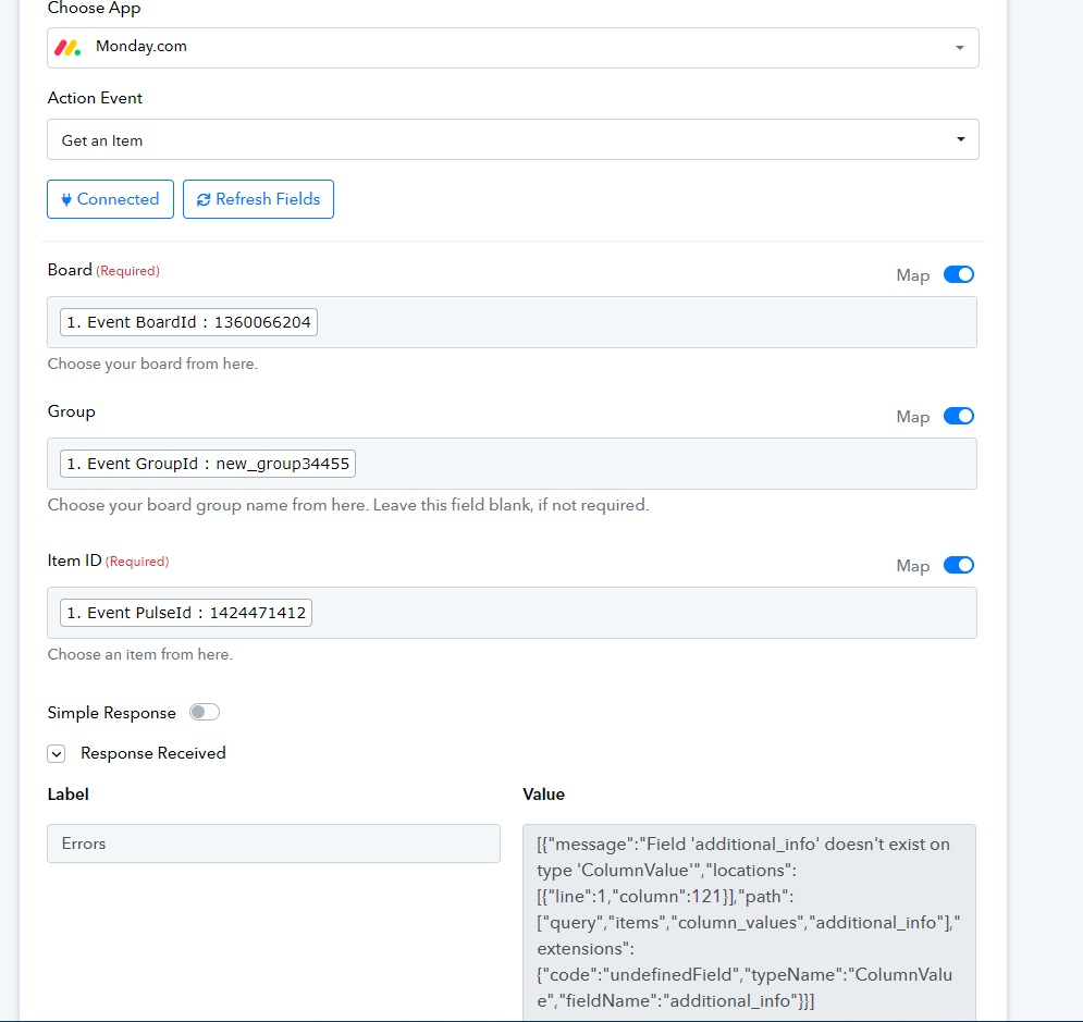

All my Pabbly Connect automations stopped working. the webhook works fine, but when i use the “get item” or “get board” i get errors and can’t see any groups or items in the “group” or “item” field.
here’s what chatgpt had to say about the error: " It indicates that within your query to Monday.com’s API, you’re attempting to access a field named additional_info on an object of type ColumnValue , but this field does not exist according to the schema defined by Monday.com’s API."

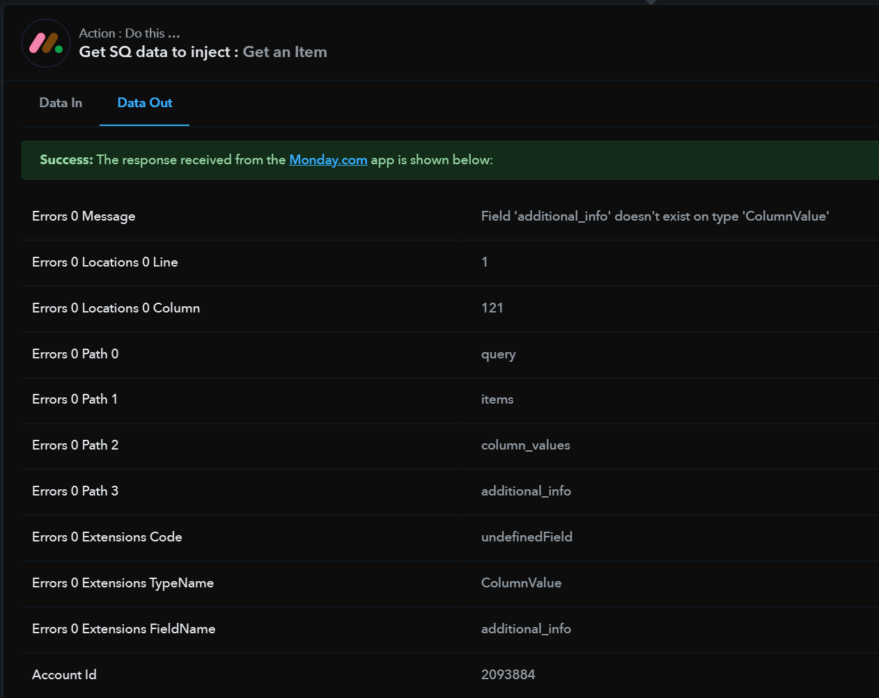

Nivesh I need your urgent help Get an Item and Search items by Column Value is still not working on my side. We cant afford another day with these actions not working. They are really crucial for our daily operations. I have just re-executed one task, you can check it
Task History ID -
IjU3NjMwNTZhMDYzMTA0MzM1MjY4NTUzNjUxMzM1MTYxNTQzNyI_3D_pc

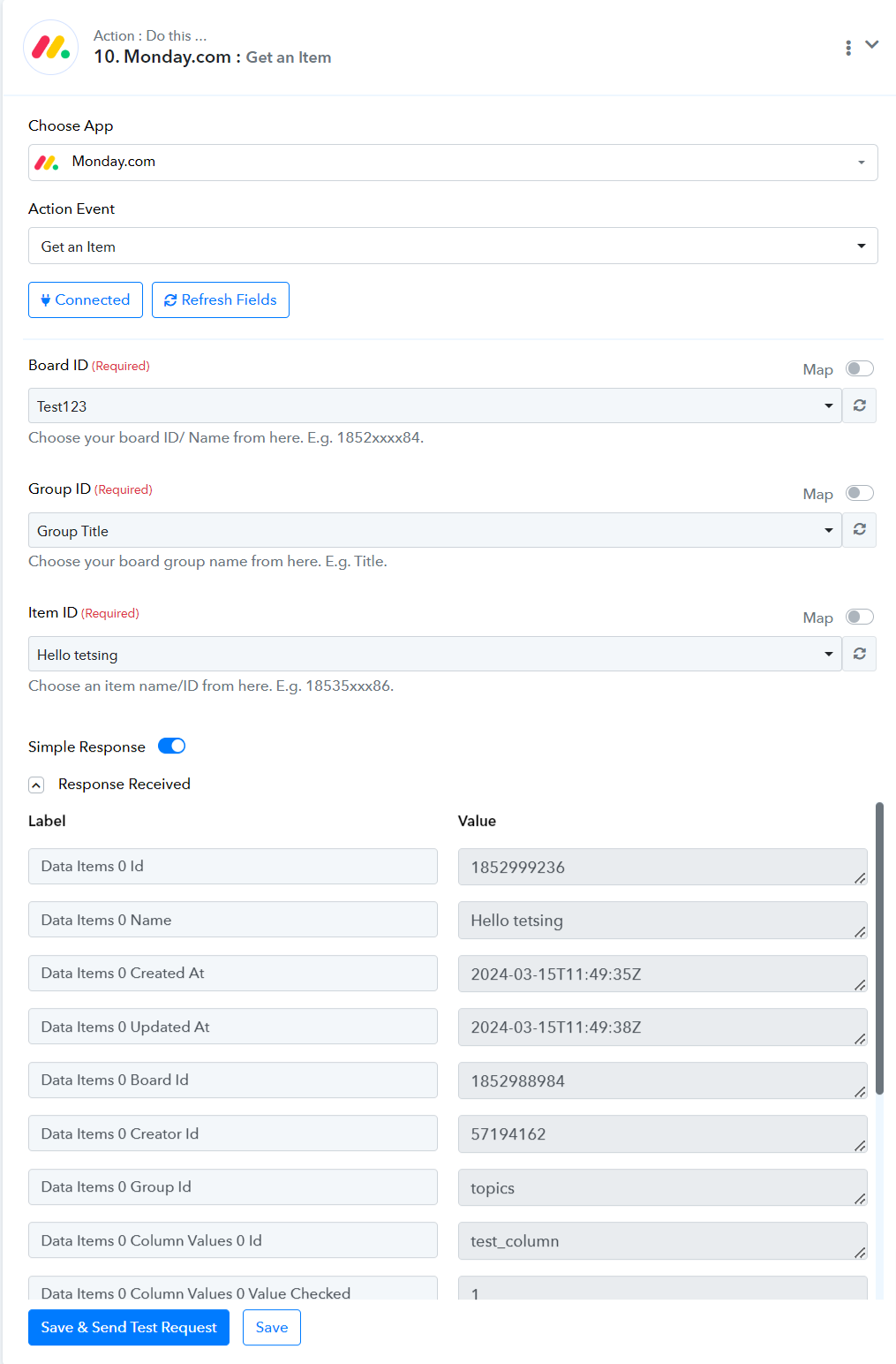

albena — Reply ·

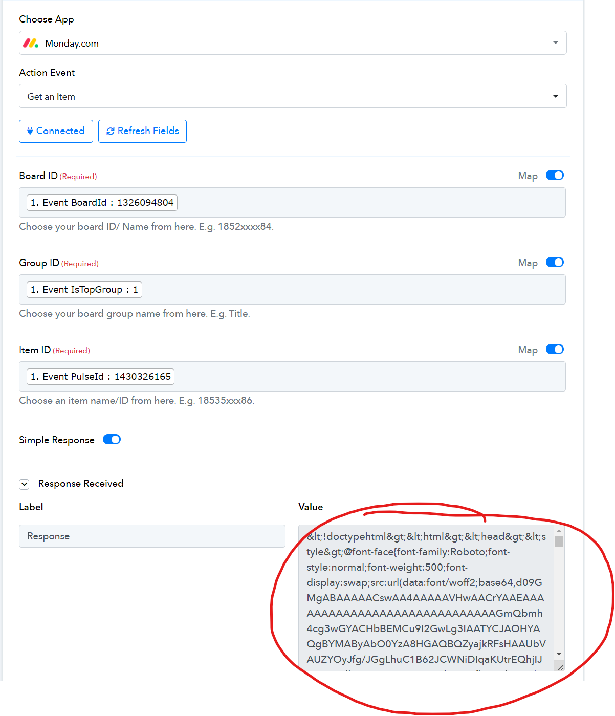

Not working here. I change the Get Item to the new one, but this is what I get:
Deleted member 8616 — Reply ·
Hey @albena
Looks like you're mapping the wrong group ID.
Please create a separate thread here and share the workflow name so that we can review the workflow setup - https://forum.pabbly.com/forums/private-discussions.27/

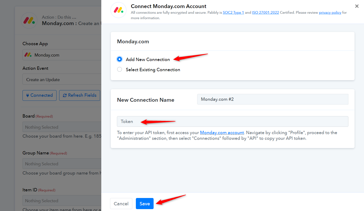

Resolved by updating the API code. Full new connection.
Hey @idolederman @k2trix @idanrox124 @miamifriendors @Grebom.b @Fabio_CO @miamifriendors @albena @Pieter Vrijsen @Alpesh
@JJJ @Grebom.b @Marten @marketingninjaz
The necessary changes have been implemented, and the Monday.com action step should now function as intended. We can confirm that the problem has been resolved.
Thanks for your patience!
@miamifriendors, Please establish a new connection with your Monday.com account within this workflow. That should fix your issue.
