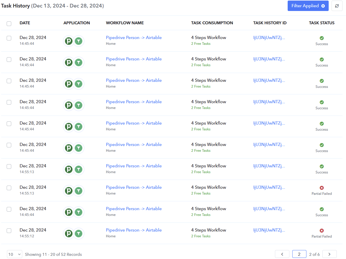

i have setup a quite simple workflow between Pipedrive and Airtable.
If one criteria is set (after trigger having updated account) then create a record in one table and then in another table as well.
Now i had the case where a record got executed multiple times in same second and got more than once processed in same second in pabbly leading to multiple entries in Airtable and also blocking from Airtable due to exceeding Rate Limit for API calls.
here you can see the executions, and there have been more like these.
Please have a look at this, here is the URL for the Workflow mapping.

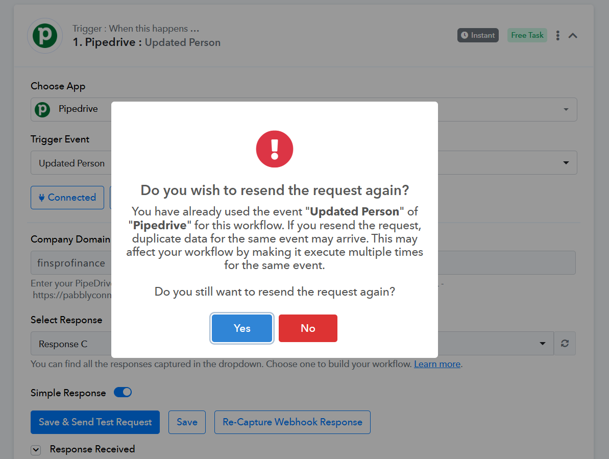

Hi @Finspro,
The issue you are describing occurs when a user clicks on 'Save & Send Test Request' multiple times, which, in turn, creates multiple webhooks in the application, causing the workflow to execute that many times.
To fix this, disable the workflow in which you are facing the issue and set up a new workflow from scratch (without cloning).
Please ensure that while setting up the 'Pipedrive: Updated Person' trigger step, you click on 'Save & Send Test Request' only once.

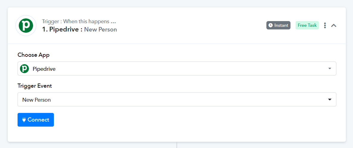

You are using the 'Update Person' trigger step in your workflow. Please note that the 'Update Person' trigger step will trigger even if there is a minor change in a person's details. It is possible that some minor changes were made to the person details, resulting in the same details being recorded in your Airtable again.
We recommend using the 'New Person' trigger event instead, which will ensure that your workflow is triggered only for newly added persons to your Pipedrive account.

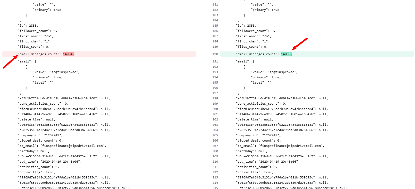

Hi @Finspro,
Wishing you a Happy New Year as well! We reviewed a few Task History IDs shared in the screenshot above, but they showed minor differences in the data received in the trigger step. Therefore, we need two Task History IDs triggered with the exact same data. Could you please share two such Task History IDs so our team can look into this issue?
Finspro — Reply ·
We had the same meanwhile for new transmissions as well, so the problem persists.
I also will try to set somehow a border with the process but this shouldnt be that way, right?
Based on your two most recent Task History IDs, we can see that although they appear to be triggered by the same data, there are minor differences between the data received in the two executions. This behavior is expected because the workflow has an 'Updated Person' trigger step.
Task History ID - IjU3NjUwNTZmMDYzNzA0M2Q1MjZmNTUzNjUxMzE1MTYxNTQzOTBmMzEi_pc
https://www.diffchecker.com/ePsTsp0w/

Hello @Finspro,
We've noticed that even minor updates, like changes to person details or internal change logs in Pipedrive (e.g., updated email send count), are triggering the workflow. The filter check should prevent unnecessary workflow executions, but these small updates are still being processed.
