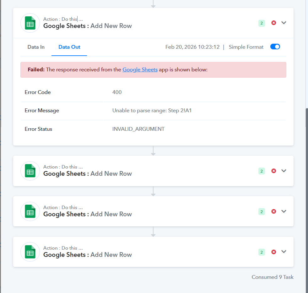

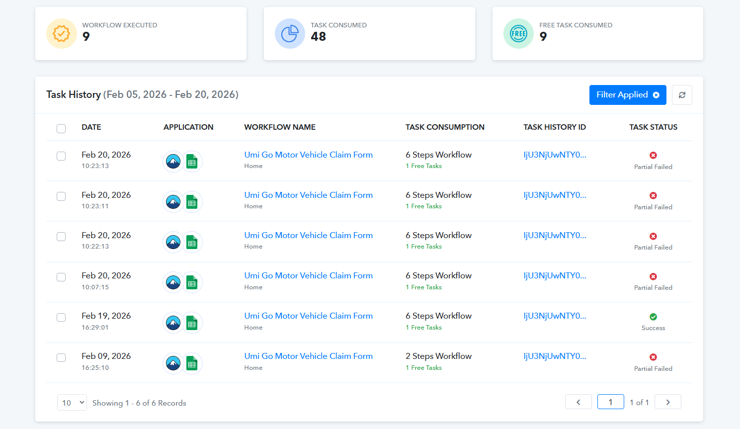

We’ve checked your workflow and its task history. The workflow appears to be triggering correctly on New Form Submission, with the latest task executed at Feb 20, 2026, 10:23:13 (UTC+10:00, Australia/Brisbane).
However, we noticed that you’ve added multiple Google Sheets → Add New Row actions to insert data into different sheets within the same Google Spreadsheet. The first step works fine, but the second, third, fourth, fifth, and sixth steps are failing with the error "INVALID_ARGUMENT". This usually happens if the sheet names in those actions were changed after setting up the workflow.
We suggest reconfiguring these Google Sheets actions with the correct/new sheet names and testing again.

In my fourth step, it shows "The content you entered in a single cell is too long and exceeds the maximum limit of 50,000 characters." Specifically, in the "sketch diagram" step, the signature board is used to draw images for the user. Then, the returned content from the signature board is very long. This results in the inability to upload the content for this step to Google Sheet. How can this be resolved?
Hi @Steve_C,
We have checked the action.
Please note that the error is coming from the Google Sheets API limit, which allows a maximum of 50,000 characters per cell.
In your case, it appears that the “sketch diagram” step is returning a Base64 encoded image, and its length exceeds this 50,000 character limit. That is why Google Sheets is rejecting the value.
Currently, there is no direct way to store such large Base64 data inside a single Google Sheets cell due to this API restriction.
