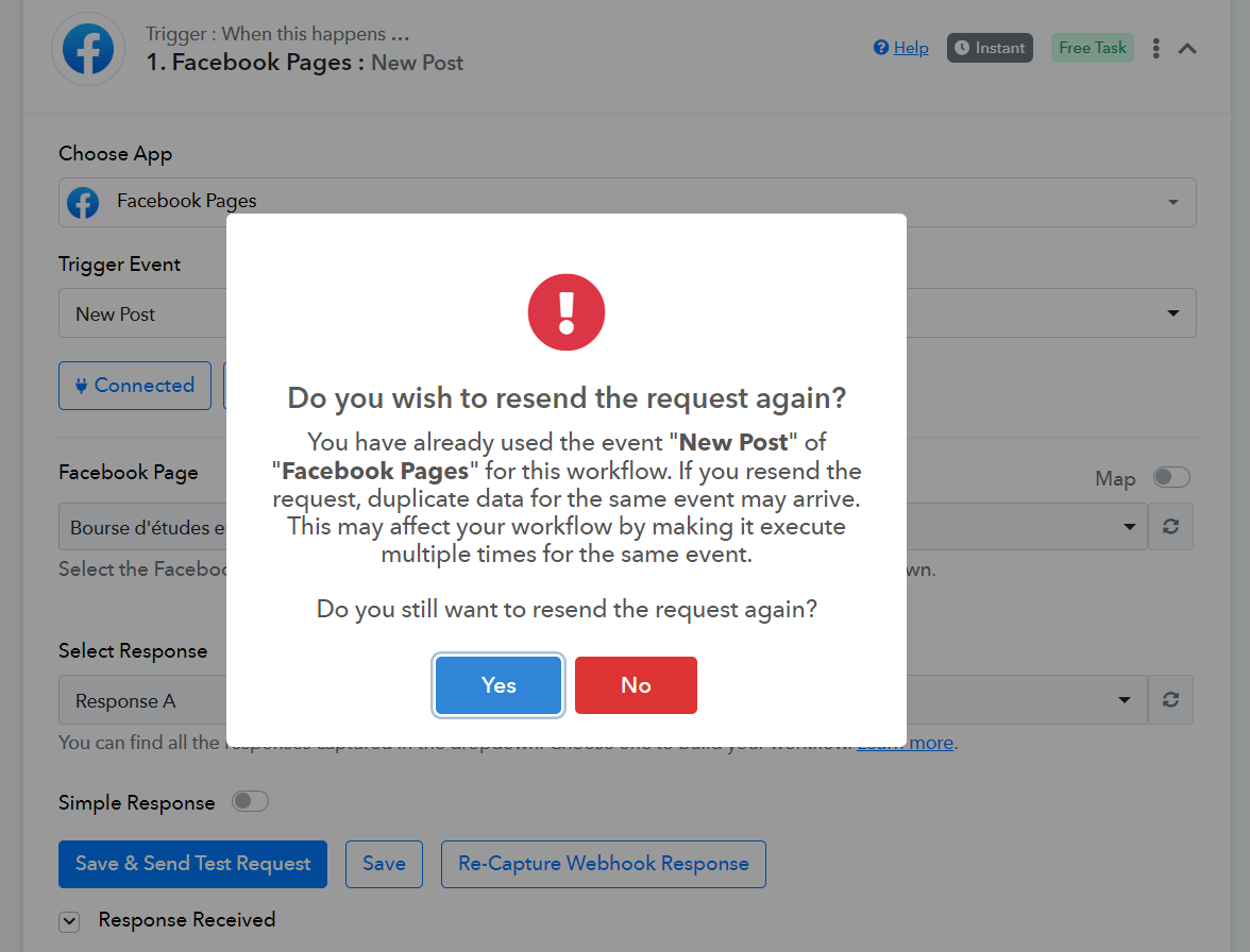

My workflow writes two Facebook comments. How can I make it write just one comment for each new publication?
Status: Closed · Asked by Pavel Mouafo on · 0 views
Pavel Mouafo — Question ·
Task History ID: IjU3NjUwNTZkMDYzMzA0MzE1MjZmNTUzYzUxMzM1MTYzNTQzNTBmMzYi_pc
Bonjour
Mon flux de travail écrit deux commentaires Facebook. Comment puis-je faire en sorte qu'il n'écrive qu'un seul commentaire pour chaque nouvelle publication ?
Merci d'avance
Hi @pavel,
The issue you are describing occurs when a user clicks on 'Save & Send Test Request' multiple times, which, in turn, creates multiple webhooks in the application, causing the workflow to execute that many times.
To fix this, disable the workflow in which you are facing the issue and set up a new workflow from scratch (without cloning).
Please ensure that while setting up the 'Facebook Pages: New Post' trigger step, you click on 'Save & Send Test Request' only once.

Merci, je l'ai appliqué et ça marche
