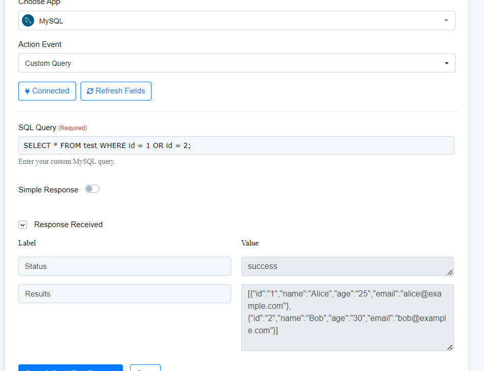

In a standard SQL execution environment, each statement—be it INSERT, UPDATE, or DELETE—executes sequentially when submitted together as part of a single batch or script. Please give it a try at your end and let us know.

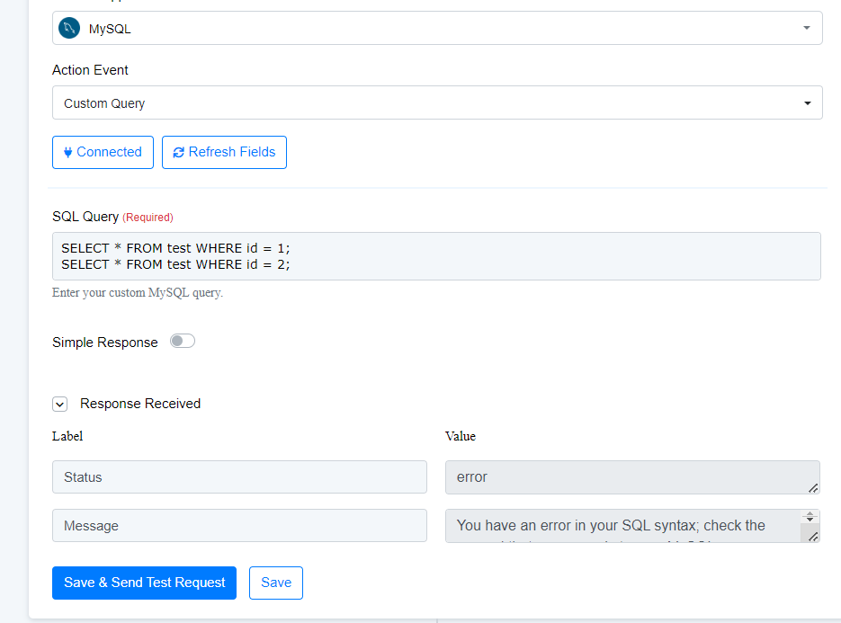

I have tried it and get an error like this, even though each statement by itself works

Thank you, however that is a single query inserting multiple rows of data, whereas the ones here are multiple related queries chained together as mySQL allows with a semicolon.

I had a discussion with the technical team, and they informed me that it’s not possible to run multiple related queries in the same action step. They can only run in separate action steps.
